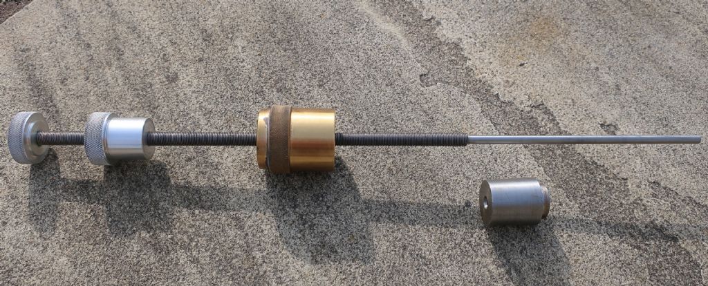

                              Diogenes –
                              The body is a guide for the rod, yes, but more than that.
                              It is held like a collet, with a draw-bar screwed into a short threaded portion of its inwards end, but the draw-bar's end face is the work-stop itself.
                              Both ends of the draw-bar are threaded for an appreciable length, so it can be screwed through the body for a distance appropriate to the work and the chuck. The protruding tail-end is then secured by locked nuts against a flanged support bush acting on the spindle end face.
                              The outer end of the body is bored out to a loose 1/2-inch to one-inch depth, and anyway its end face retreats into the spindle by about 0.1 inch. (Spindle bore, 0.60" )
                              The arrangement is to let work-pieces enter the spindle by about an inch. The bought depth-stop's minimum setting protrudes from the spindle by nearly an inch, the work-holding problem I am trying to solve.
                              The immediate project involves parts about three inches long, held in an ER collet for best concentricity. If I make a new body with a much longer tail-end spigot I could even extend the working range, sensibly by up to perhaps another inch.

                                          I use just use a plain 'straight' bar (the type that used to come with Mercer / Verdict / Starrett etc) that clamps into the tool slot – it's about 1/2" X 1/4" and 2 1/2" long, with the usual type of cross-drilled sleeve for the indicator spigot at the business end.
                                          I use quite a sensitive lever indicator, a tenths one, because a couple of thou error in smaller MT's will let you know that it isn't quite good enough when you come to fit them, and it doesn't seem to be much harder work to find a null-point with one of these than it is with a coarser one.
                                          I set the centre height of the stylus ball by eye against the point of a tool-height gauge which seems to work well enough.
                                          The backstop I use in the GH600 uses a fabricated brass 'cap' that screws onto the small amount of thread at the back end of the spindle, through which the screwed rod is threaded, with a 'top-hat' collar to lock it off.
                                          The nose insert is a loose 'guide' that fits in the spindle nose to stop the rod flapping about.
                                          I'm not saying it's the best-ever design, just offering it as food for thought..

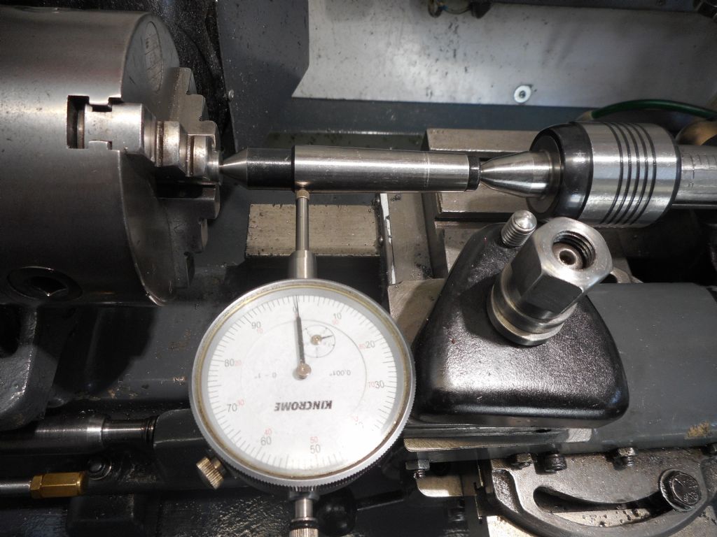

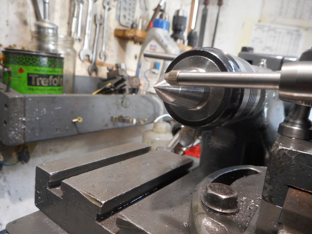

                                                Well, my curiosity got the better of me out in the shed this morning, so I had to set up and check old GHT's mathematics on the relatively little influence of tool or DTI height on a taper.
                                                So I set up an MT2 centre between centres as shown below and using a dial gauge mounted solidly to the topslide by clamp, set the topslide to achieve a 0-0 reading along the MT2 taper, plunger set at centre height.
                                                Then set the plunger 10 thou above centre. Result: Still got a 0-0 reading (on my .001" graduated gauge).
                                                Set the plunger 30 thou above centre. Result: about half a thou of needle movement from one end to the other. Maybe as much as 3/4 of a thou on some passes. But closer to a half, I reckon.
                                                Plunger 1/8" above centre, as in pics below. Result: About 2 or 3 thou of variation, end to end.
                                                Conclusion: Old GHT was right. Unless you are waaay off centre height by say 1/8", it will not make a noticeable difference. Set to centre height by eyeball should be good enough for us bodgers. Also I reckon he was right about the concavity along the way being only one millionth of an inch. Certainly no sign of it by my crude 1 thou measuring device.
                                                One thing I did notice is that the thou or less of necessary clearance on the topslide gibs, amplified by the leverage distance out to the dial gauge point, can give a different reading on the return pass than on the initial pass by a thou or two. So make all measurements starting at the tailstock end and ending at the headstock end, and disregard readings on the return pass so all slack is taken up in the same direction as cutting forces.
                                                I always finish off such tapers with some emery cloth and oil to get a nice smooth finish without tool marks and find it is easy to "adjust" the taper by a thou or a fraction thereof in the process if needed for the very final fit. Usual method is to put felt pen marks along the length of the taper then fit a 2-3MT sleeve over it and rotate it about half a turn and back. The pen marks rub off on the high spots. Works better than gooey bearing blue for this.

                                                  A while ago, there was a thread about how miunting a tool away from centre height affected the parallelism, or taper.
                                                  The conclusion was that over short distances the variation was minimal.
                                                  Hopper has conformed this
