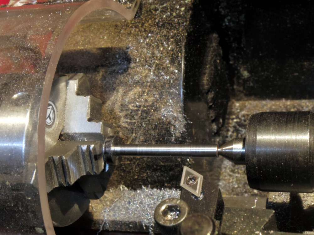

                          I have a Sieg C0 and it's an absolute joy to use especially when making small parts in brass, aluminium and mild steel. I added an Emco QCTP which allows me to use 8mm indexable tools. For some jobs it is quicker and easier to use than my C3.
                          Like any tool if you can work within its limitations you will be happy. Trying to go beyond the limits of a machine leads to frustration so think carefully about what you want to achieve.
