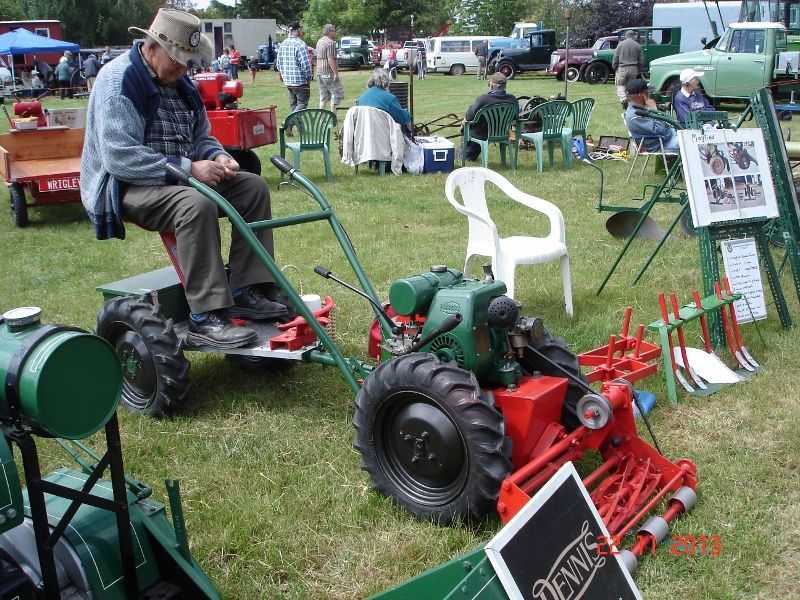

                                              Ian S C
                                                @iansc
                                                There was an Allen Autosythe at the show(no photo), but this might do the job. Ian S Cdsc00736 (800x600).jpg
