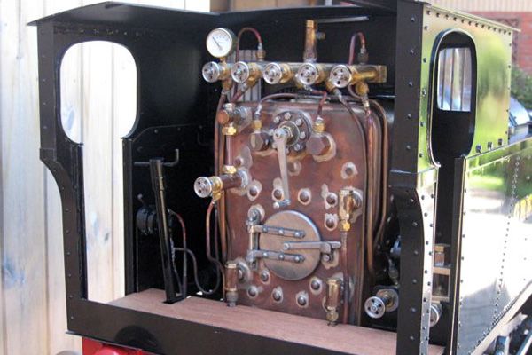

                  I should perhaps in fairness add that Martin Evans designed a new boiler for the 7.25"g Midge in ME 16th December 1966 to replace the original rivetted and soft soldered original design.
                  However this new boiler is not without it's critics, and especially the stay pitch of 1 3/4" and 1 7/8" and the large unsupported area on the backhead would not be approved of these days.

                        Seems to be plenty of staying on this one but it appears to differ from the boiler drawings I have for the Stockings design.:- Just looked a bit closer at the drawing and I see it is the same. The staying is at 1" pitch with additional support round the fire hole.
