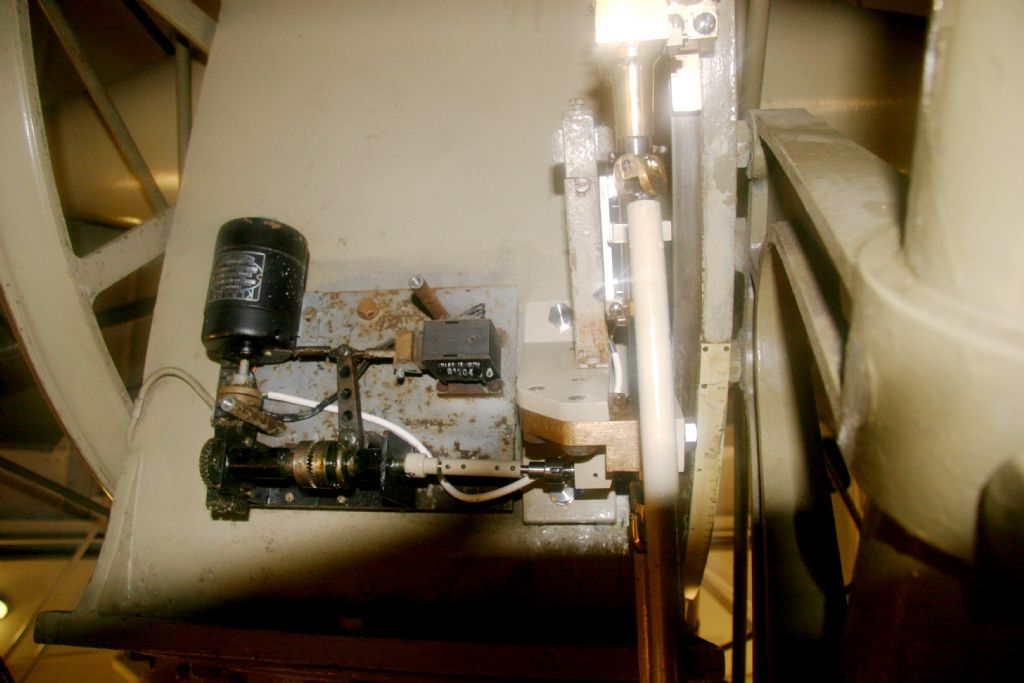

                                john carruthers
                                  @johncarruthers46255
                                  The 1" x 40tpi screw thread that drives the declination of the 28" at Greenwich was hand chased in gunmetal. Parts of the drive date to the 1893 clockwork (which replaced the earlier water driven system) with recent modifications in 1970 when the scope was relocated from Herstmonceaux. The main source of periodic error comes from the pitch circle and bore of the gears being slightly eccentric. Most errors are now corrected via the recent AWR drive box and a guide scope.
                                  Last time I was there the whole thing had ground to a halt because one 1" tapered pin had dropped out
                                  (note to self: don't get fingers in the clutch when the solenoid fires up )
                                  I did hear that Barrie Watts (Beacon Hill) was packing up making worms/wheels?  might be an opportunity for someone?
                                  Edited By john carruthers on 31/07/2015 18:20:38
