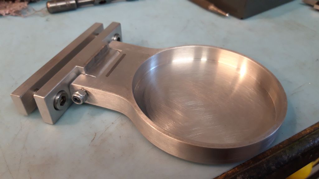

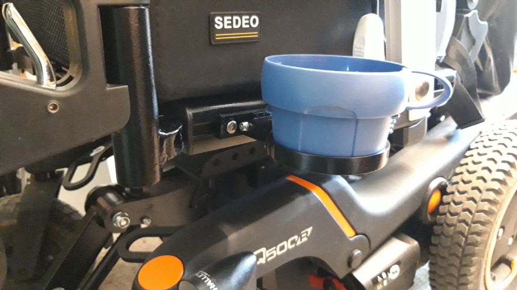

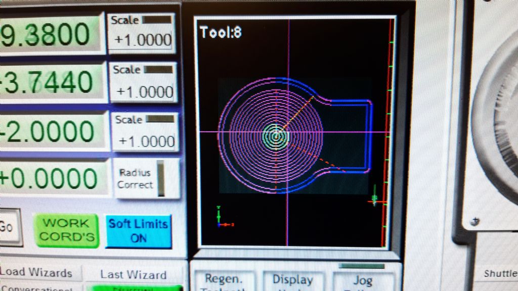

        I needed to make a new cup holder for my partner's new electric wheelchair, the previous cupholder would not fit, and anyway, I fancied using my KX1. CNC'ing the main shape.
        Vectric V carve made a good job of working out the tool paths. I used a 6mm end mill for both the pocket and outer profile. Taking it steady with 2mm deep cuts in the 10mm deep pocket, and the same with the profile which was 12mm deep.
        I included 5mm wide tabs, but put two of them where all the material was cut away!! No harm done it all held together okay.

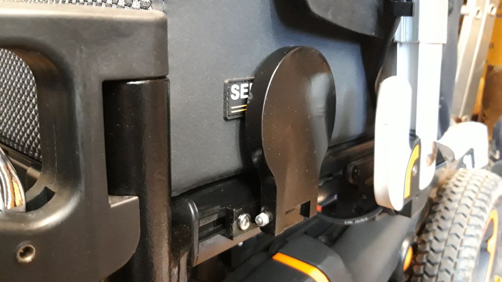

        The other parts were done on the manual mill and lathe, producing the hinge bracket, backing flange and M4 pivot screw.
        I glued strong magnets into the bracket and a mild steel bar into the main body. Worked out nicely.
        Painting is not my favourite job but the black matches the wheelchair.
        Just got to wait until we can get out and road test it now!
        Ian J

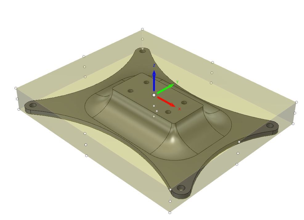

                I thought it was about time to dust off the KX3 and make a bit more swarf. The chosen candidate was the base for my current engine project which I had made a bit more shapely than the engine it is based on but making the four sides concave rather than just rectangular and the curve from top out to the edges is a 1/4 ellipse so not easy to do with an off the shelf cutter particularly to get it to flow around the corners of the upper rectangular mounting surface.
                Roughing
                The usual 3D clearing using a 6mm dia cutter was showing quite a long run time in the simulator as it was basically just doing an ever decreasing rectangle so lots of movement and little cutting to start with as it just nipped off the far corners so I thought I would try one of ARC's 25mm insert cutters. I changed to a pocket clearing cut which spiralled down 1mm and then worked around the waste before spiralling down again, I generally prefer to use more of the cutters edge but with the inserts the cost of a couple of corners is not too great even if the sides don't see an equal amount of wear.
                I will need to look at the helix that the tool follows as it spirals down if I use the method again and also support more of the work as it was getting a bit chattery as I got down to the 4.5mm (4mm plus 0.5 finish) thickness. I have already played around with this and got the tool to ramp down as it moves along which together with a few more tweaks cut about 40% of the run time.
                Contour
                I had already sawn to rough shape on the vertical bandsaw so only needed a couple of 0.5mm clean up contour passes and a final 0.25mm finish one and it was while doing these that I realised something was wrong as there was a lot more coming off the left hand side than the rightangry Turns out that I had located the work based on the ctr position I had used when drawing it which was the middle of the rectangular top section (black sharpie marks on video) but F360 defaults to the ctr of the stock which being an asymmetric part was off to one side, luckily there was enough to play with except for a couple of the rounded corners so out with the JBWeldblush
                3D "Steep and Shallow"
                From the earlier Filer & Stowell flywheel I had found that I was using the wrong type of path with some input from Andrew and Barrie so opted for what F360 calls "steep and Shallow" which allows you to set the stepover or scallop for both steep and shallow surfaces which results in a more even finish, I went with 0.25mm in both cases and used a 4 flute Arno ball ended cutter. Quite happy with how that turned out as it needed almost no cleanup work prior to paint.
                I also drilled the holes on teh CNC, the larger than normal spotting holes are due to me not having modified the file after altering the hole spacing on the mating part so had to run teh spotting path again with a slow downfeed so the 6mm spotting drill did not get pulled over by the previous overlapping holes.
                Final job was to add some bosses around the corners which still need a bit more filleting but the Upol Rapid filler was living upto it's name this afternoon and almost setting before I could apply it so just gave it ablow over with etch for now.
                Feeds 'n' speeds etc in description when watch on you-tube

                  #481832
                    Ian. I've only used Vectric 2D for a very limited time so can't say if it's the same as yours.
                    First thing to do in F360's CAM is the set the X-Y-Z orientation so machine knows which way up to machine the part and and how it is placed on teh mill.
                    Then you enter the stock material details where you can set shape, (round or rect) specific size or add a machining allowance to part, this gives the transparent box shown beloworigin.jpg
                    Then you can set your origin, the 27 dots on the image above are points on the stock that can be used, there is also the option of a similar number of points based on the model bounding box, any selected point or what I should have used in this case was "model origin"
                    If you look at the finished item, the two M3 holes should have been in line with the counterbored ones used to hold the work as they were placed 15mm either side of the stock's ctr which is a couple of mm different to the models origin.

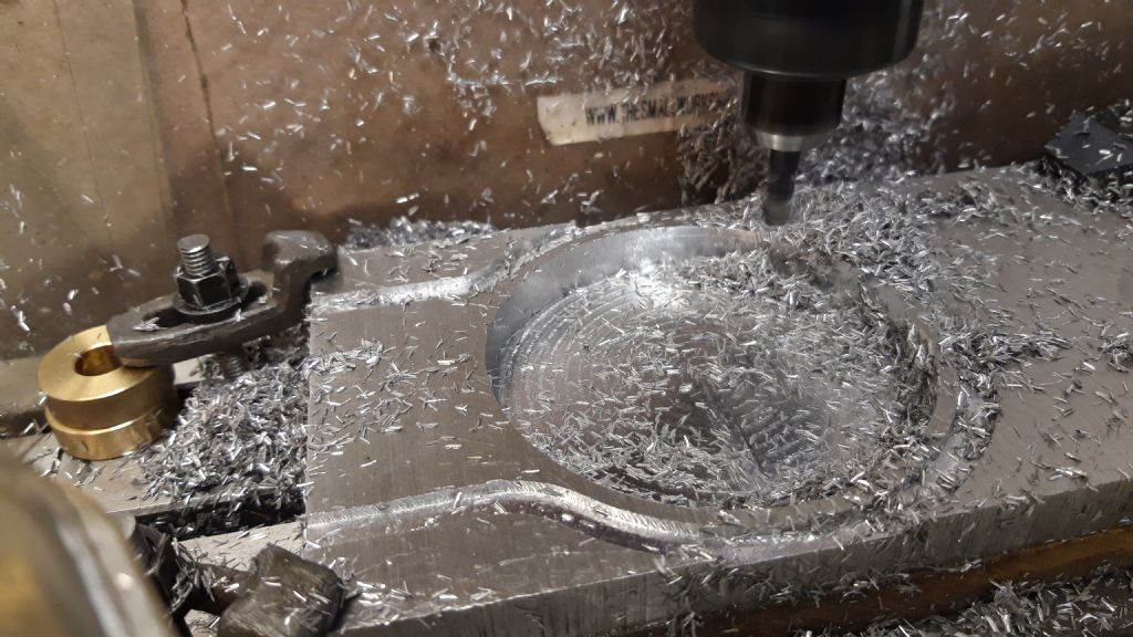

                                I carved a cylinder head for my current Thompson engine out of a bit of 50mm cast iron bar yesterday, this is the finishing "Steep & Shallow" cut from Fusion after the adaptive clearing and external contour cuts had been done.
                                6mm 4-flute R1 cutter at 5000rpm and 400mm/min feed with a 0.25mm stepover.
