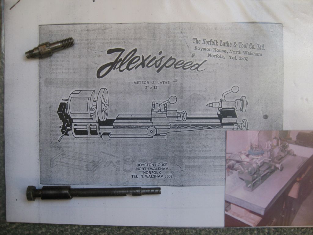

                                    image.jpegI was pleased to see the recent posts on the Flexispeed Meteor/Norkolk lathes. They were good wee lathes in their day, and probably still are, for traditionalists.
                                    i bought a basic kit from Norfolk, for £72 in 1976. There was quite a time lag between paying the deposit and taking delivery, so I did not risk any further purchases from Norfolk, lest my money disappeared into the receiver's hands.
                                    The literature supplied was Flexispeed, over stamped Norfolk.
                                    First job after the kit was built was to add a back-gear, using gears from a defunct valve actuator. Then I added a Cowell fine-feed and screw-cutting attachment. This wee lathe screw cut quite a few 26tpi cycle thread motorcycle parts. Eventually I upgraded to an ex-industrial ML7R and sold the Norfolk. I sometimes wish that I had kept it, as a momento.
                                    To fit the Threading kit I had to bore out the left-hand leadscrew bearing using a spot facing tool, built to LBSC's words and music. That is it fitted to the long bolt at the bottom of the photo, then make an adaptor screwed 5/16 whit Left Hand to screw into the hollow mandrel. Mark 1 adaptor at the top of the photo – Mark 2 had a longer body, to get the gears to line up…
