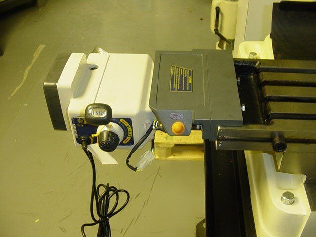

                  Axminster seem to be helpful with providing info, they provided some photos of the installation of the unit fitted to one of their mills (thank you Axminster).
                  Quite a bit of overhang but looing at the other photos provided it may be possible to mount the unit vertical with a bit of adaption.
                  Phil.

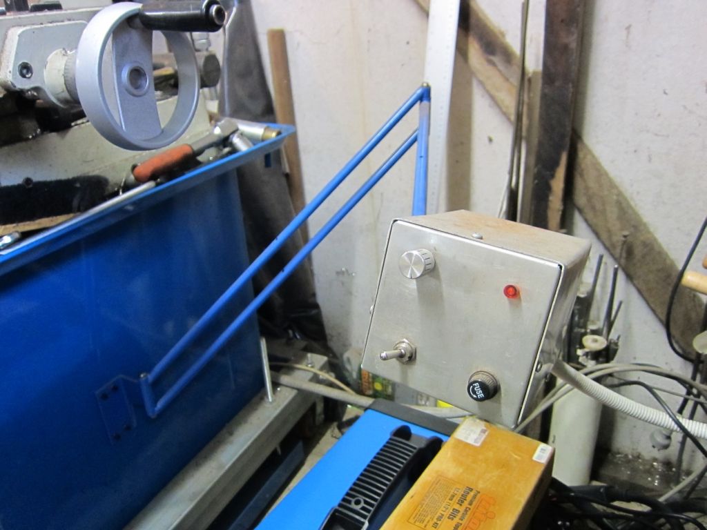

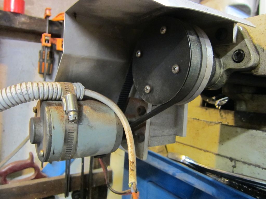

                    I made the type of thing you are looking at for my mill about eighteen months ago.
                    For power I used a 10 amp car battery charger and bought a PWM controller off Ebay for $25.00. It has worked very well though the pot on it is flakey and I have to replace that.
                    The motor I had came from an electric scooter and included a toothed belt and a pulley for which I made up a mounting plate. Made up some mounts for the motor, a box for the PWM and a swing arm for it. The swing arm moves under the table so that it can be got right out of the way.
                    Not anywhere as pretty as Mike’s job and it does not contain any microswitches or relays, but for about $50.00 all up, it works very well with the machine I have, which although not the same as yours has a similar table size.

                        Colin, The table on my Lux is also 9.5 ins. The picture from Phil says it all./
