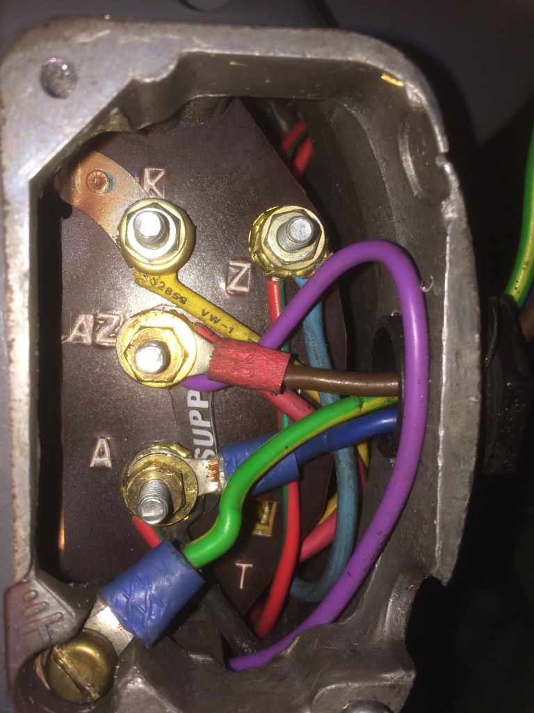

      i have a Myford Super 7 without its original motor or Dewhurst reversing switch. Instead, the motor is a single phase 3/4HP one made by AER Ltd. Ashford, wired through a simple no volt release (NVR) switch.
      Having tried to contact AER Ltd., I have had no replies and they are not answering their telephone. I was wondering whether anyone has dealt with the company and whether anyone is familiar with these motors. I am hoping, however, that they are fairly standard. The connection terminals are as follows:
      AZ – wired to the live wire from the NVR switch
      A – wired to the neutral wire from the NVR switch
      Apart from the earth, the other two motor terminals are labelled K and Z, but are not connected to any wires coming into the motor.
      Can anyone tell me whether it is possible to wire the motor to a reversing switch like a Dewhurst, and if so, how I would connect this up?
      Many thanks,
      Mike

          I suspect that you can't reverse that particular motor, but be careful what you wish for. I have a lathe with a screwed mandrel nose, a Boxford. The only scar on its bed is due to having a reversible motor.

            Normally in A/Z nomenclature, you would have two windings, A and Z with the winding ends marked A1 and A2, and Z1 and Z2. the Z winding is the start winding, and to reverse the motor, you would swap round Z1 and Z2, or wire Z1 and Z2 to the reversing switch, and let the switch do the swapping. it sounds like your motor may be connected internally, possibly at the centrifugal switch if it has one, or it may be a non reversible motor, which are becoming annoyinly common today. can you post up a pic of the motor and the connection box (is there a diagram insode the cover?), and also the rating plate of the motor. It may be that the empty posts have been used to connect the windings on the other side of the terminal plate, so it may be fairly easily doable.

                A reversing motor would have more than two wires in the junction box, probably four wires. The issue of chucks unwinding as mentioned by Clive is probably a result of rapid acceleration to full speed when not using back gear speeds. Reversing when in back gear is unlikely to loosen the chuck when reversing for screw cutting. The biggest risk is selecting reverse with a high speed setup. One solution to this is to replace the motor you currently have with a VFD driven 3 phase motor. This setup allows soft starting in both forward and reverse so reduces the risk of chucks unscrewing. There are other good reasons to go 3 phase if you end up replacing the motor. Plenty of existing threads cover this.

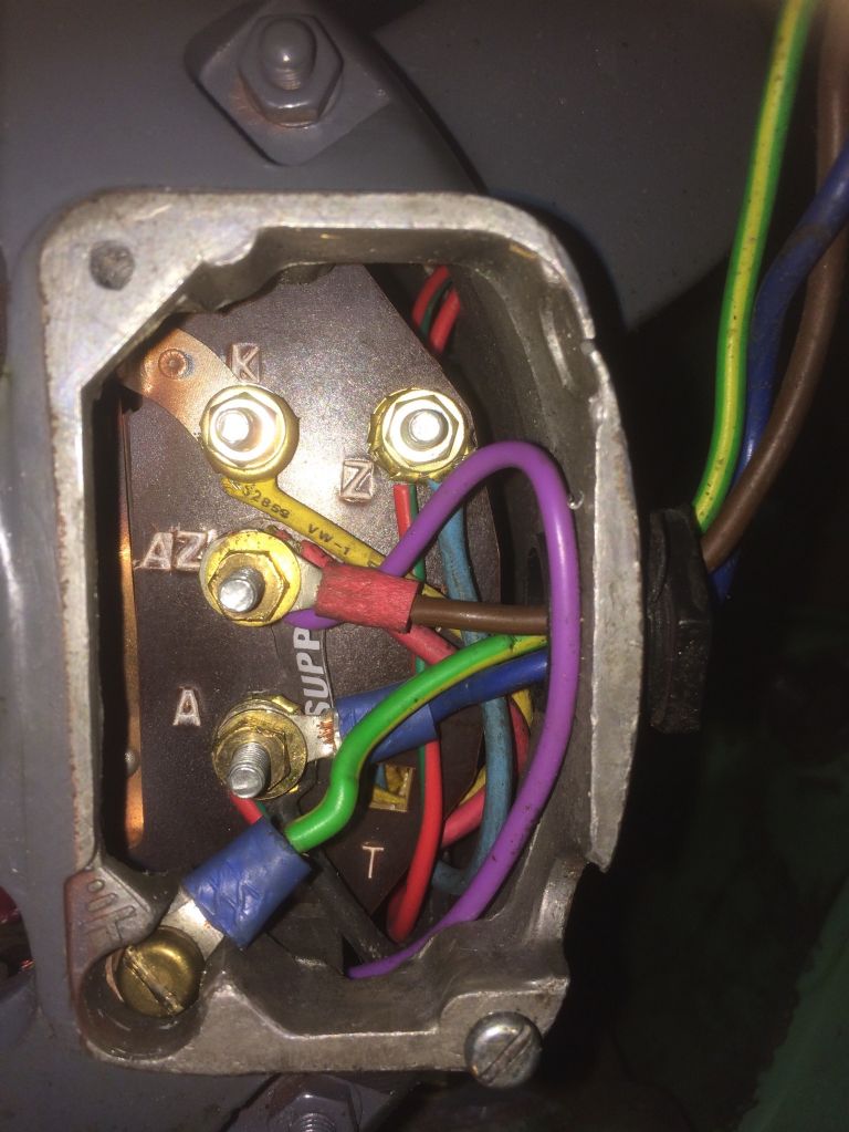

                  I’ve just added a couple of photos of the motor connections to my album, though I can’t work out how to add the photos to this message (I’m writing this on a very small-screen iPhone!)
                  Motor plate shows the following:
                  Ref. BPA56P42900 B56 Fr.
                  0.55KW 0.75HP 1425RPM
                  240V 1Ph 50Hz
                  5.6A Class B CONT Rtg.
                  No. ZBM02641 Amb. 40degC
                  Start Capacitor 120uF 275V
                  Run Capacitor (no details)
                  IND. MOTOR BS5000 Pt.11 CE
                  Apologies for the large font!

                        The motor images are below:
                        Motor Connections 1Motor Connections 2

                                  Mike, getting back to your question I believe the start winding ends are the blue on Z and yellow on R wires.
                                  Before spending money you could try swapping those wires over to check if the motor reverses, if it does come back here and you can get a drawing of connections to the Dewhurst.

                                    Coming back to the OP's question, the "AZ" terminal appears to have 3 wires connected to it. There is also an A and a Z terminal. So it looks like both ends of each winding are brought out and terminated on the terminal board. So I think the motor should be reversible by the method that Phil describes.
                                    But I can only reiterate that reversing a motor can be dodgy with a screw-on chuck. I assume that you are cutting metric threads so the threading indicator doesn't work? There are other ways of picking up the thread when you return which I have seen described.

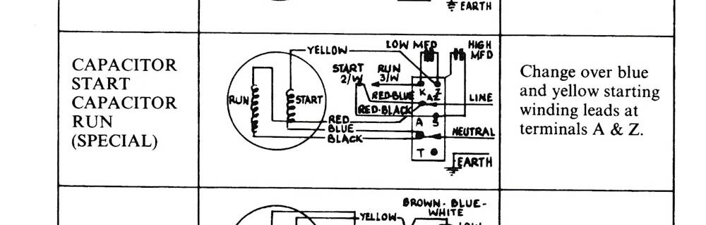

                                      Mike,
                                      This scan from The Model Engineer's Handbook seems to show a similar situation to yours although this is a connection diagram for Crompton Parkinson motors.
                                      HTH,

                                          Yes, I agree with Emgee, those are the best candidates for being the start winding. swap them over and see if the motor reverses.

                                            Rod, as far as I can see, that diagram id for a capacitor-start;capacitor-run motor.
                                            Mike seems to have a capacitor-start induction motor, the nameplate give no run-capacitor value.
                                            Mike needs to establish whether there is a centrifugal switch to work out where to go from here.
                                            Dewhurst switches are great, but expensive and are likely overkill for reversing a single phase motor; they are more universal and are able to be used on 3 phase as well.
                                            Mike has a photo of the original wiring, so disconnecting everything and measuring resistances seems the way to go, as we're not sure what a previous owner has been up to.
                                            The start winding will have a higher DC resistance than the run winding, so it should be easy enough to ascertain the colour coding of the wires from that. It looks like there are two red/green wires, so I'm guessing they will go off to the start capacitor, or maybe a centrifugal switch if there is one.
                                            See the second diagram on HERE for the Capacitor Start Induction Motor. Yours may or may not have a switch.
                                            To reverse the motor, all you need to do is reverse the Start winding, which you will have already identified via your resistance meter.
                                            This can be done with a simple Double Pole-Double Throw switch There's a nice easy diagram HERE but don't let the colours confuse you as they will be different to those in your motor.
                                            A-AZ are likely to be the run windings. most motors I've seen have Z-T as the start windings, but this one omits T and has K instead, so I'm guessing that might be going off to one side of a centrifugal switch.

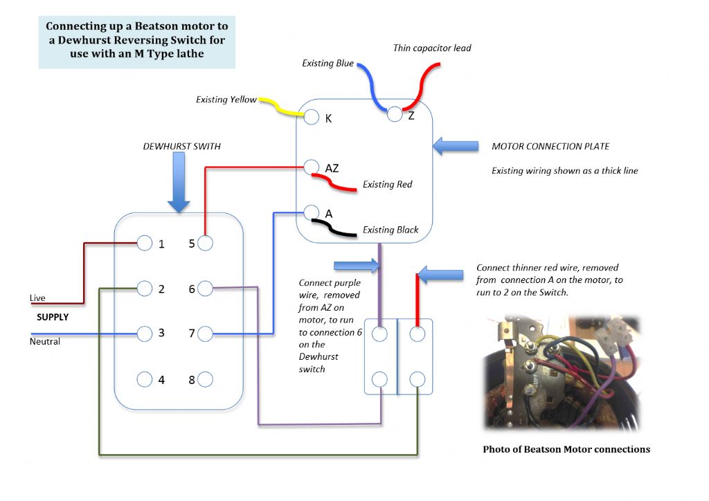

                                              Hi Mike
                                              I fitted a replacement motor a couple of years ago from Beatson motors in Sheffield and they helped me with this diagram. Your photos indicate you will have plenty space for the 2 in-line connectors that are needed.
                                              Regards
