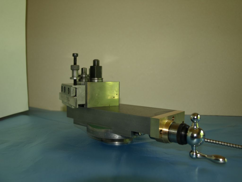

      I want to place a Renishaw magnetic DRO scale inside of my cross slide on a South Bend 9A which is about the same size as a Myford 7.
      This saves a lot of room where one wants to slide the tailstock slide up close to the saddle/cross slide.

        That was our member KWIL, put a Newell Microsyn inside the topslide.

                            KWIL's writeup was in MEW 150

                                            The then editor of MEW expressed surprise that the DRO was contained inside the Topslide that I had exhibited at MEX. The article was a reply and he chose to publish it.
                                            JS why is it strange? It was not intended as a how to.
                                            JA, My photos in the Forum Album are not there to display all works but are merely posted there from time to time in answer to questions raised. There are hundreds of others "off screen"
                                            The article will not assist Cabbage Stack in any way in fitting a magnetic strip DRO, the problems and sizes are so much different.

                                                A full writeup would not help, the electronics used are no longer available and require access to board level dimensions. It was a tight packaging job within the constraints of the "standard" Myford dimensions.
                                                Different dimensions of another DRO system and lathe manufacturer will bring its own unique criteria and problems.
                                                As the OP started out regarding the Cross slide, with a magnetic strip on the side of the slide and a read head towards the rear, tailstock approach problems will be relatively non existant.

                                                  Strange in that even if it was not intended as a how to, you showed virtually every detail and part but not the scale used or even the make.
                                                  Even if it were a special or non obtainable [ not mentioned ] it would have given other readers an insight in case they wanted to go this route.
                                                  We even got a shot of the hole in the ground but no coffin !!
                                                  #258907
                                                  KWIL
                                                    @kwil
                                                    OK John, as seen at MEX, clearly Microsyn by Newall. See second post by JasonB in this thread.
                                                    Not obtainable subsequent to fitting due to head design changes.
