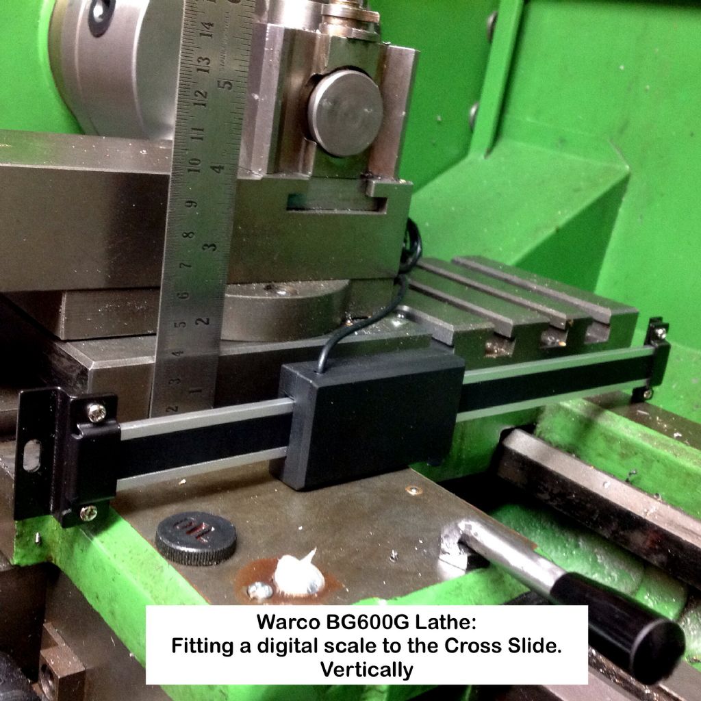

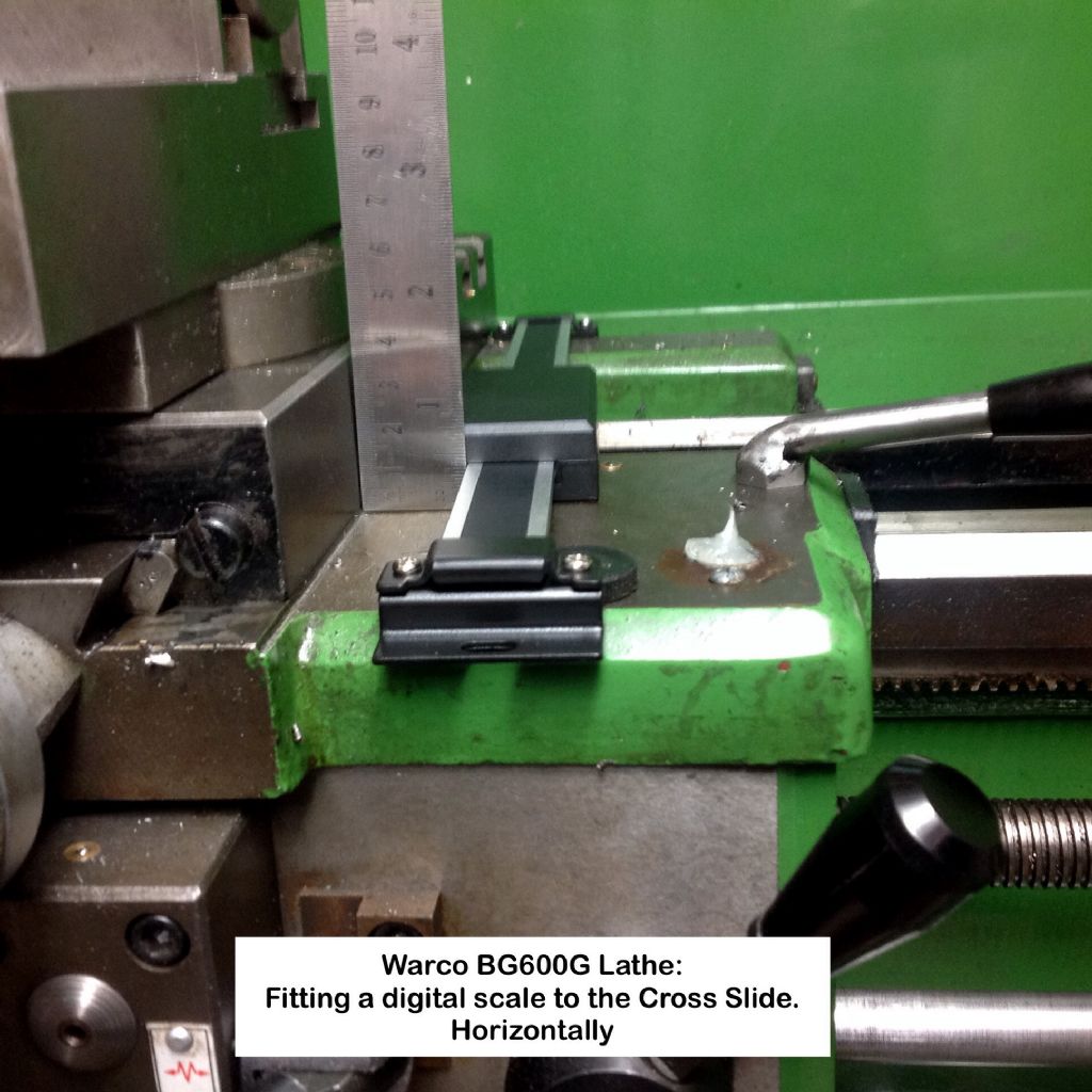

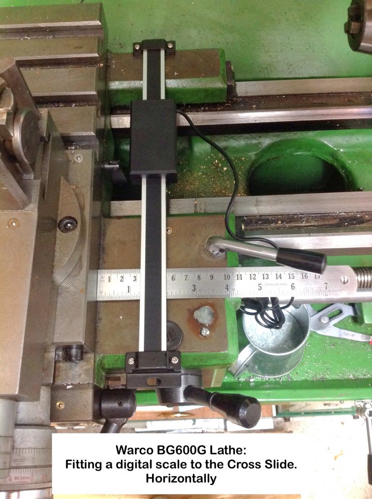

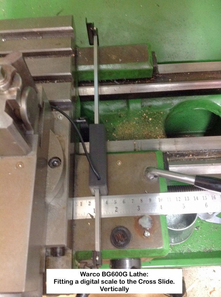

            Ady1,
            Your wish is my command.
            'Warco BH600G Lathe DRO' Album added, and shows the scale 'mounted' horizontally and vertically.
            The scale shown is 12" long, but I will, I think, fit an 8" one.
            All sorts of really crazy (stupid?) solutions have bounced around the inside of this old noggin of mine, but none I'm truly happy with.
            As can be seen, space is at an absolute premium to say the least, so I am open to all suggestions.
            Having problems loading photos in sequence with this post, hence none included.

                #166349
                  To me the vertical option is better as hiorizontal will ristrict how far to the right you can move the carrage when using tailstock support. CAn it be turned the other way so the wire pokes down.
                  The other option if you have enough room between the spalshback is to mount it well out the back of the cross slide so muck is kept out the way, would only need a flat bar on te side of teh topslid eif done that way.

                    I have mine poking out the back of the cross slide and never have any issues with it
                    However you fit yours, you'll be dead chuffed once it's done, this is one of the most useful mods you will ever make

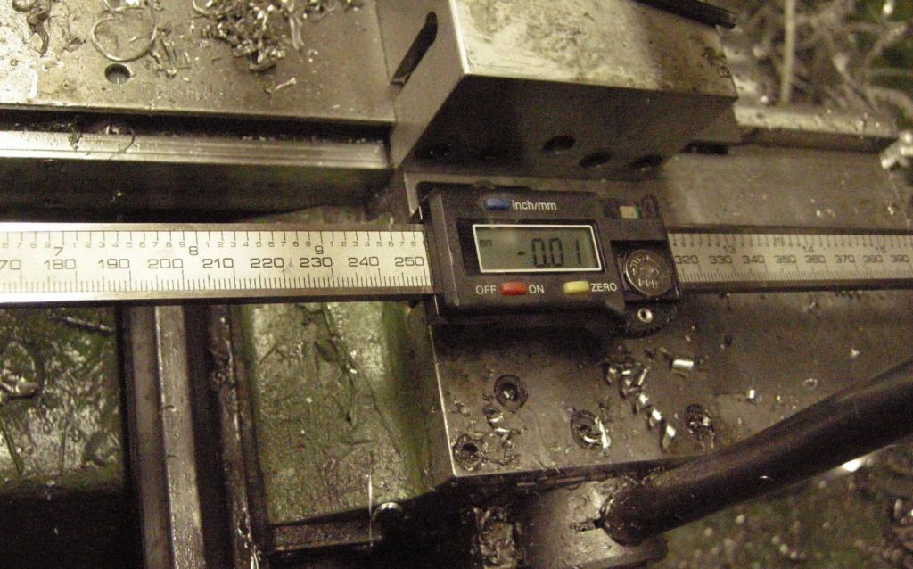

                      A quick and inexpensive way of fitting a digital readout, the length is altered by moving the clamp holding the depth probe

                        Can you cut it down a bit – some types can be- and fit it at the back like Ady. Otherwise you could get a shorter one and use that one on a mill or something.
                        Definately liking the out the back position, just leave enough room for the Meek screwcutting mod trips.

                          Ah my 'Crazy' idea not so crazy after all, i.e. poking out the back.
                          Will check clearance for an 8" scale, and take the CrossSlide off to investigate fitting it internally.
                          The reason for fitting the X-axis scale on the front of the Carriage, is to keep the rear clear for whatever in the future.

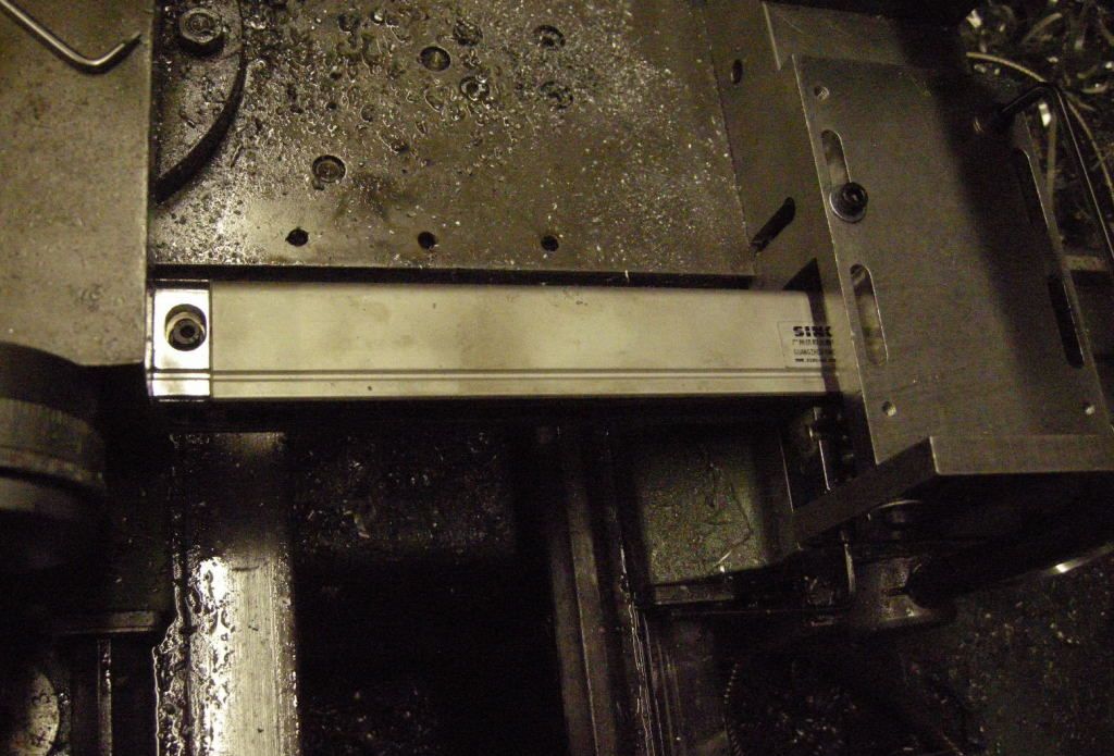

                            Mounting outboard the 2nd best way of doing it, just need to make up braces when swarf piles up.
                            Most likely no room internally but would be my no1, even the magnetic wont go in with the reader.
                            3rd best mount vertical against the cross slide and make your own brackets, reason as follows.
                            I have just found out from 4 years ago and uploaded the differences between the cheap scales, glass scale and expensive magnetic scales.
                            I could only mount two units at the same time, first two piccies cheap scale to magnetic scale seen behind. Brackets supplied with these cheap scales can have an error 0.145mm before they start to register, the brackets flex. The only way you would find that out if used a DTI or another scale. If using these scales make your own brackets, certainly the reader one.
                            Piccies 3,4 and 5 are compare between an expensive magnetic scale and a Sino glass scale both rigid. 0.05mm repeatable error

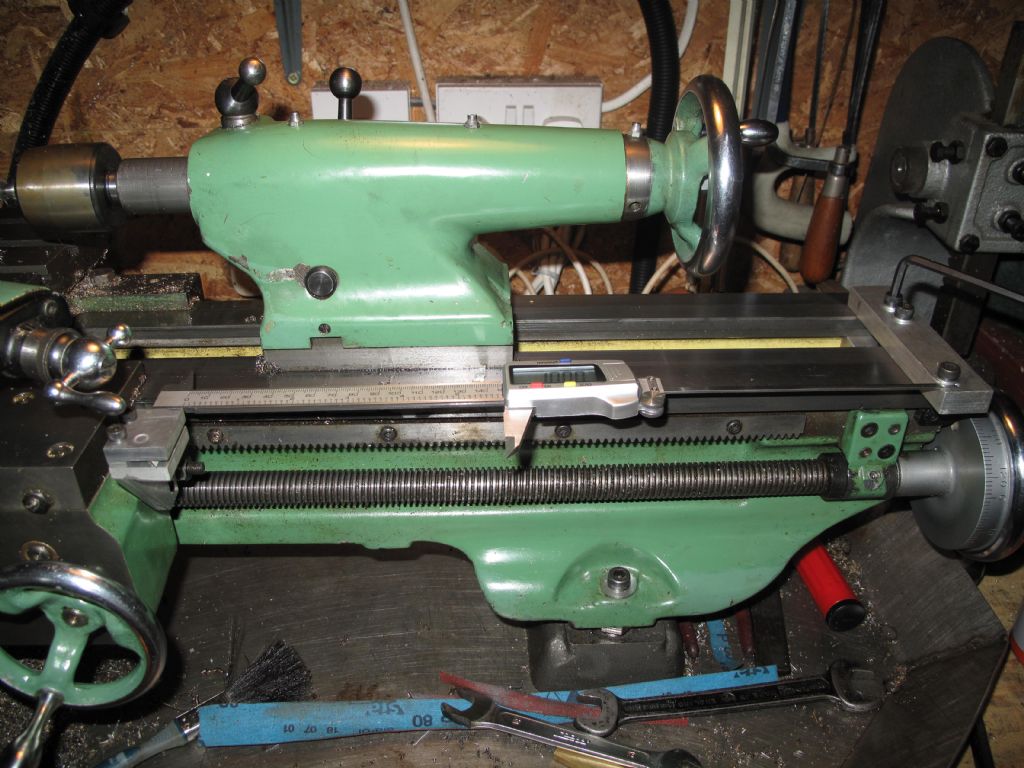

                                  Here is my version of a low cost DRO fitted to my Super 7. I used an original hole on the rear of the saddle and made concocted support from bits from the scrap box. I will tidy it up sometime in the future now that I know it works. The plastic cover is to keep cutting fluid (Rocol Ultra 370) out of the works. These DRO's are not waterproof – don't ask how I found out!
                                  I'm pretty sure I don't suffer from backlash; the bracket is pretty solid, but I will double check, following Jon's experience.

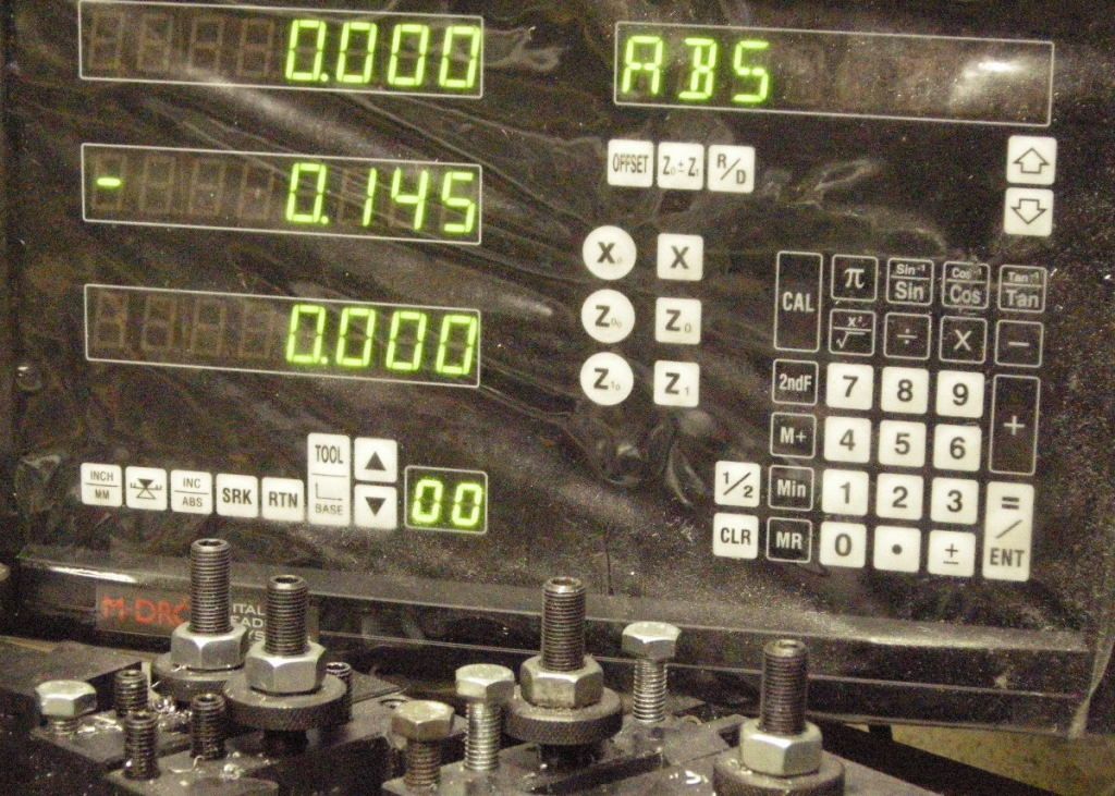

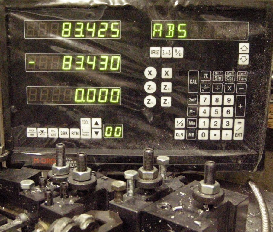

                                    Doug whats the repeatability of the 1 micron?
                                    I have the 5 micron to tail stock and cross slide and give regular errors of 0.05mm as shown. Poses a problem for fine threads near on tolerance. The 1 micron wasn't around at the time 4 years ago.

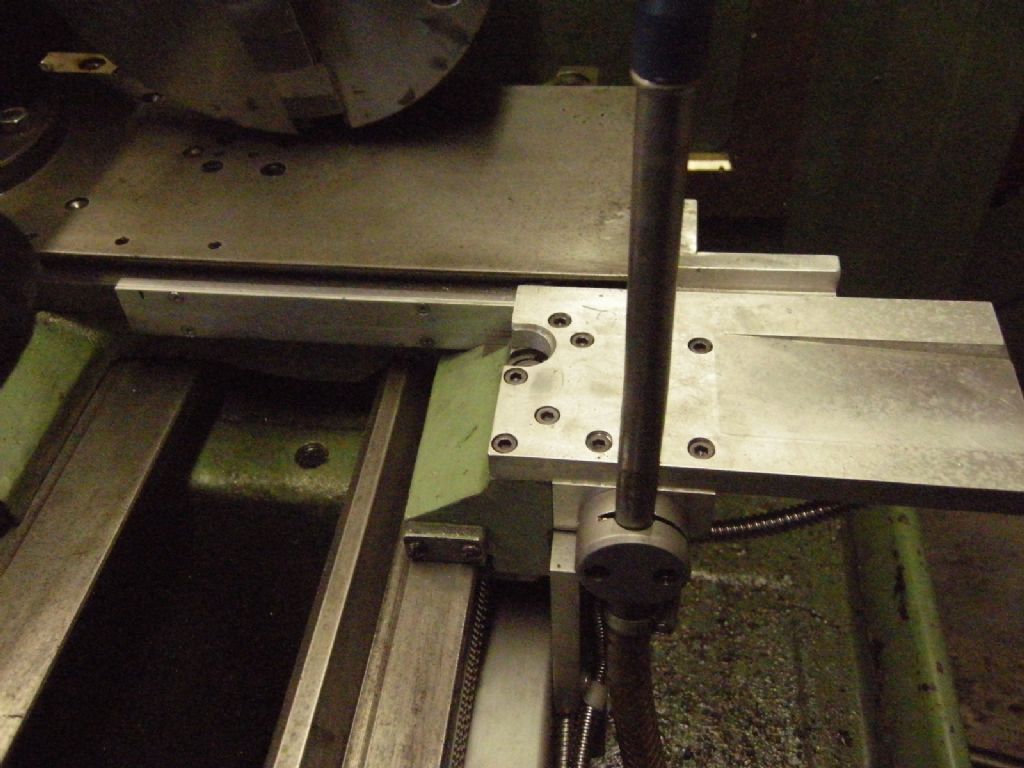

                                    Phil that reader bracket looks more substantial than the supplied. The end ones are good to use. If I didn't have the magnetic on cross slide I would have gone for glass mounted outboard.
                                    Think the install through, where are the cables going and what will they catch or interfere with.

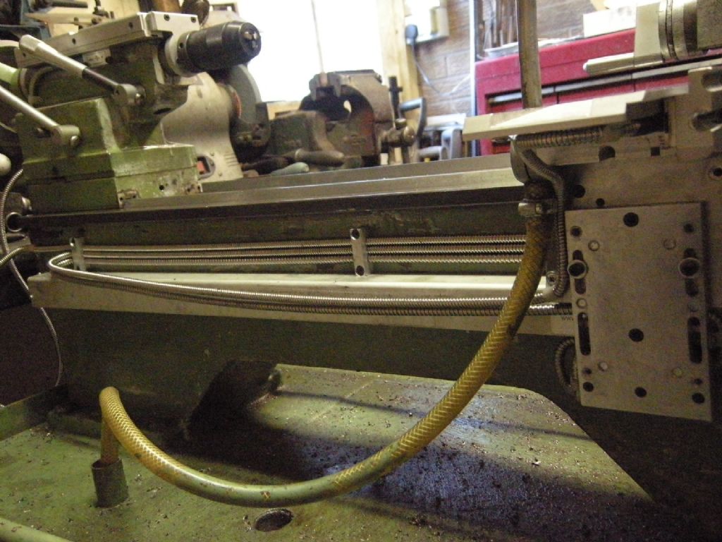

                                    Heres my Y axis magnetic lost 7mm where tail stock butts up to cross slide, that's it.
                                    Cables got to go some where and need plenty of slack.

                                        The bracket fixed to the Saddle – it is the one supplied with the DRO (Axminster Power Tools – usual disclaimer) I have a spare; two were supplied. The setup was originally made for my ML7, and I had to elongate the hole to get it to fit the Super 7 without remaking the cranked bracket.
                                        It all seems to work; there are two 3mm cap-head screws fixing the bottom of the reader to the bent-up MS bracket to eliminate any potential twist. Nice thing is, it can all be removed in seconds, by undoing the two 1/4 BSF cap screws.
                                        I checked the repeatability with my trusty vintage Mitutoyo dial gauge (long before Chinese imports) and was able to repeat positioning to 0.01mm over the range of the gauge (5mm). Whilst turning, I would remove any potential backlash in the feed-screw by always moving the cross slide in the direction of the cut.

                                                Jon- regarding the repeatability of the 1 micron scale, that's not easy to assess. All I can say is that I have never found a problem with it, although that does not mean there is no problem. On a small lathe one is not working to an accuracy of 1 micron but the resolution is very handy.
