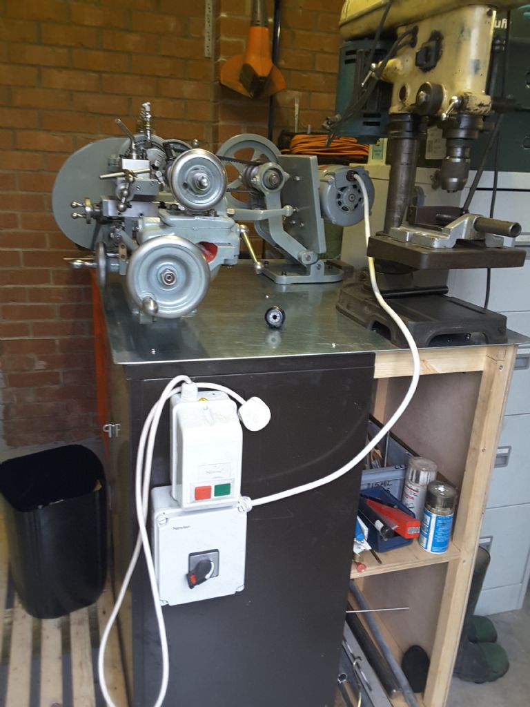

              I have a cupboard for my lathe support with a drip tray with a shallow angle lip for my lathe and mill. It works well as it is a superb storage for tooling etc. The tray cost me about £30.00 bent an d welded at local fabricator it is 3mm thick and with bent edge it is quite stiff.
              The drill has now been replaced with a small mill.
              David

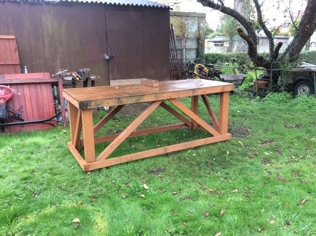

                    I would consider something like this ,this is my outside workbench . Very strong and cheap to make ,4 x 4 fence posts for legs and 18mm plywood top ,4inch screws to hold it together.
                    Maurice

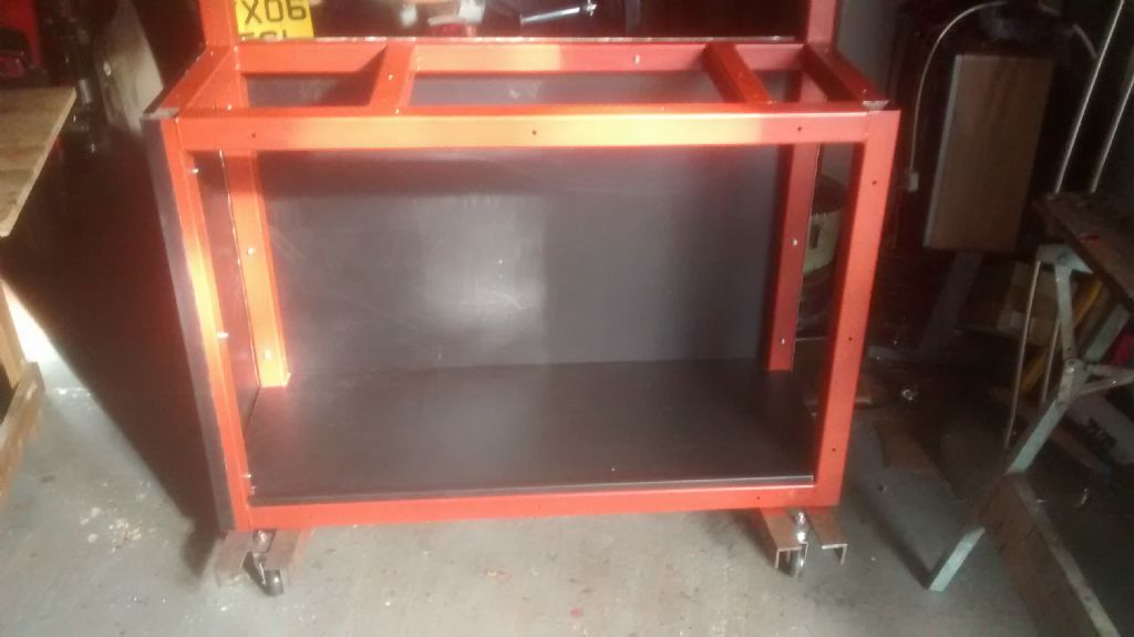

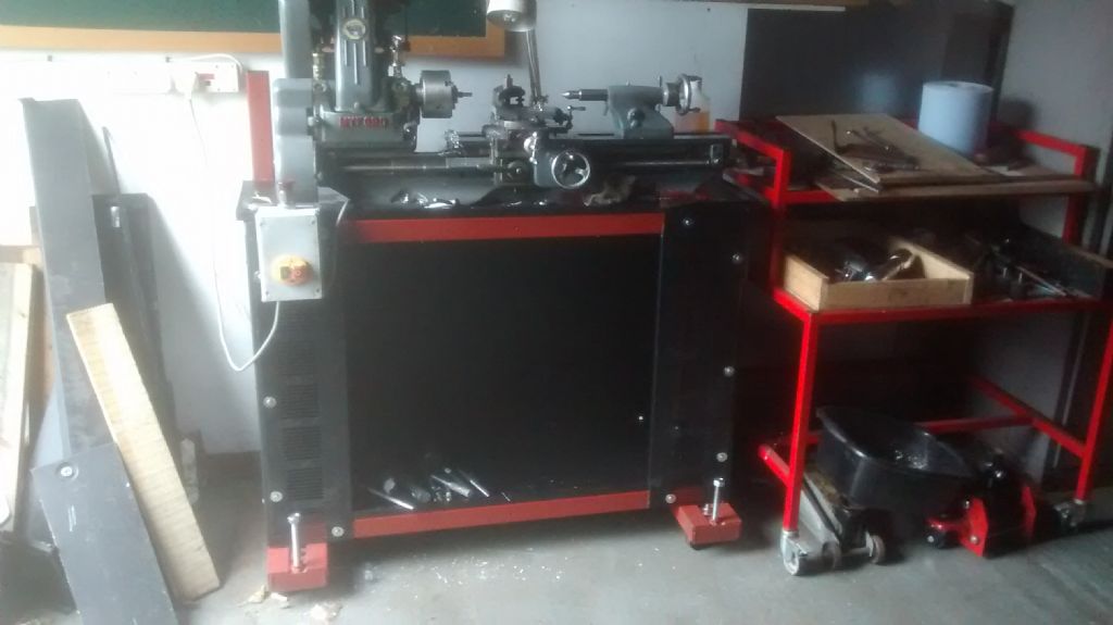

                        img_20151108_141159657[1].jpgThis is what I made for my ML7,based on a design in MEW a few years ago.
                        Maurice
                        Edited By Maurice Taylor on 27/10/2020 11:44:45

                                          Hi William my cupboard is a damaged metal office cupboard with plywood reinforcing under top and shelves. It was cheap for sale from local office suplier. It has two shelves and double opening front doors. It contains all steady, spare chucks, faceplates, loads if drills taps etc. I have screwed a home made back shelf unit to it to hold spare material drills and cutting oil etc.
                                          David

                                            Maurice Taylor
                                              @mauricetaylor82093
                                              coolantPosted by William Ayerst on 27/10/2020 14:57:14:
                                              I don't know how to weld, or know anyone who does – so this particular bench will have to be off the shelf Is the heavy duty bench in the link above (65kg, steel, 1.5m x 600mm surface) OK?
                                              I think this bench will be suitable.I would put a sheet of 18mm plywood on the top and also a sheet of thin steel or aluminium with edges turned up ,as even if you don’t use coolant, the oil from the bearings goes onto the top plate.
                                              The top has to be substantial to enable the lathe to be levelled . Hope this helps.

                                                    I made one out of 40*40*3 box very similar to Maurice's, but whatever you buy/make make sure it's high enough. I copied the Myford stand height and forever had backache after a protracted session. Lifting it up on 2 off 4" sq timbers got the cross slide up to about navel height, much better
