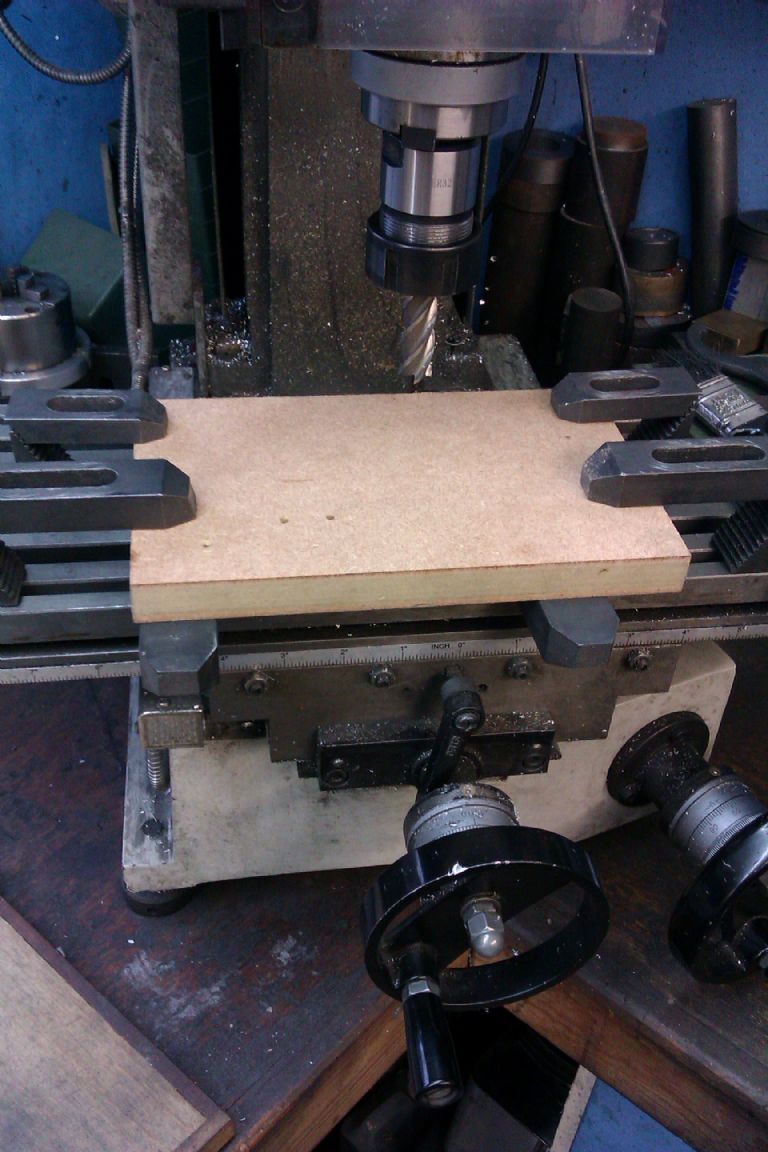

      Obvious question but is the spindle rotating the correct way? as something is not right.
      Have you got anything to measure the cutter shank with, from the photos it looks like the shank is the nominal size of the cutter so 20mm and your collet is definately marked 20-19 so should fit. Try tightening up the collet without a bit in it and see if the slots close up, it may be there is something stopping the nut going far enough onto the thread.

        Hi Jamie,
        I'm relatively new to machining as well but have been doing quite a bit of milling recently. I have a slightly smaller machine, the Warco WM-16. I use ER25 collets on an MT2 chuck. (I think your machine would be a match to the Warco WM-18).
        Things I would check if I were seeing this problem are :
        – For a 20mm end mill the correct size collet would be the 20-19.
        – Are you locating any part of a flat on the end mill in the entrance to the collet? (if it has a flat on the shank that is).
        – Are you using two spanners to tighten your collet chuck?
        – Are you locking the quill before taking a cut? My quill has about 0.8mm vertical backlash if I don't lock it and I've used the fine feed to move it down from its home position.
        Pls excuse my input if these are obvious things you already checked.
        Regards,
        Ed.

          Just looking at the photo of Jamies above, if that is a 20mm cutter in a 20-19mm collet there is not a lot of thread showing on the collet holder to be able to close it down to 19mm, compare that with my ER32 with 16mm cutter in 16-15collet.
          I wonder if its actually an imperial set with a 3/4" cutter and Jamie's next collet down is 18-17 as its not a full set? Which would mean teh collet is right on its limit for closing down.

              My thoughts on the original problem (apart from the geometry) is that if I wanted to use a cutter near to the maximum diameter that the mill was designed for, would be to put the ER collet to one side and use a MT3 (or whatever size the spindle is) direct in spindle taper. On some of the setups shown there is quite a lot of overhang to from the cutter to the front (lower) bearing. To my mind some spindles have nowhere near enough spacing between the spindle bearings anyway so doing anything to reduce the overhang will help.

                When I bought my mill (similar size to Jamie's), I was tempted (by price) to purchase a collet set and chuck. It turns out that it was a sort of half-way between ER25 and ER32. Neither one nor t'other with a taper that didn't correspond to the ER standard. The collets were slightly longer, too! Is it possible that Jamie has a "rogue" collet in a genuine ER collet chuck, or vice versa and that's what's allowing the cutter to unscrew? In my, albeit limited, experience, a proper cutter in a genuine ER chuck will hold tight, with virtually any reasonable loading demands on it. Something has got to be drastically wrong somewhere here.
                I have carried out similar operations to the one Jamie is attempting, but on thinner material and I used a smaller diameter milling cutter to excellent effect, with no sign of the cutter going walkabout.

                      Check that the collet is what it says ! I recently purchased a set of ER 16 collets and chuck for a project and found that one of the collets was incorrectly marked for its size. If this is the case for you then it will as others have said make it more likely that the cutter will pull out.
                      Looking at your set up am I correct in assuming that you are truing up the full depth/edge of the plate ? I.e. Using the side of the cutter to a depth of 20 – 25 mm ? If this is the case then I am not surprised that the cuter pulls down during the cut even if the depth of cut is very small. Hope I explained this well enough. For this type of work it is better to use a Clarkson chuck with screwed shank cutters. ER collets are very good and I use them a lot but only for light cuts and in the situation above would revert to my Clarkson chuck , or indeed for any situation where the depth of cut required it.

                        Cutter problem solved…..
                        A REALLY BIG THANKYOU TO EVERYONE FOR ALL YOUR HELP AND ADVICE ON MY FIRST VENTURE IN TO USING MY NEW MILLING MACHINE
                        I problem was a bit of bad finishing on the inside of one of the gaps in the Collet… Using a bit of paper I fed it through all the gaps in the collet to find that one was not as it should be.. Now sorted and cutting well……
