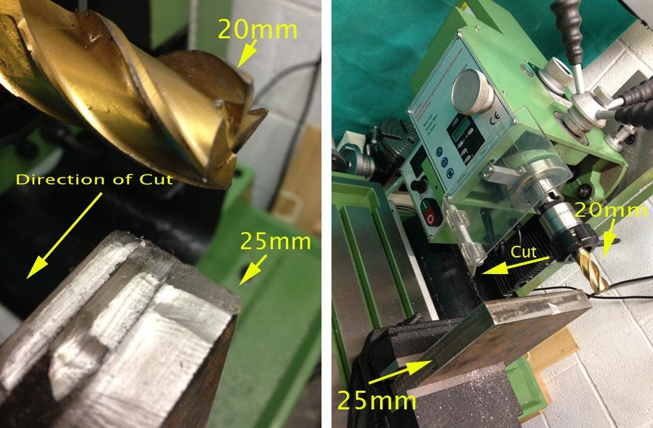

        First time Milling Issue Advice Please
        Lined up some Steel in the Vice (25mm Thick) and trying tidy up the edges and straighten them up.
        Using a 20mm End Mill with the advancing cutter blade facing the top of the work piece as it rotates.
        Using the metric speed calculation Steel 100 x 100 = 10,000 / cutter size 20mm = RPM speed of 500
        The edge being end milled is not level. The cut on the right is starting to address the un-evenness of the material. I have gently feed the cutter in… Too fast causes the cutter to smoke and jam. Trying a bit slower and there is very little in the way of a cut… Splinters…
        I have then tried running along the work piece in a thinner cut, ie the left third with a view to tidying the end in three passes. ie 1/3rd in, 2/3rds in and the last being the whole width of the work piece.
        But the second pass is not as deep as the first pass even though the cutter height has not changed. The head is locked off and the work piece is secure…..
        I did expect that cuttings to be bigger than splinters from most of the youtube videos I have seen… Just not confident to force the cutter in any faster.. I have tried slowing the cutter speed down by 150 rpm incase it is tougher grade steel than I expected and also increasing it 150 rpm on the original speed.Without any effect…
        Can anyone offer any advice?

          You'd be better having the steel plate clamped horizontally, packed up from the table. Even a 25mm plate has some flex, and that's a lot of leverage that will exploit any flexibility in the vice..
          Mainly though, you are climb milling and the action of the cutter is tending to lift it out of the work, it will also tend to pull the work along in a series of jerks
          Try reversing the direction of cut. and see what happens.

              Yes Neil is correct you should always feed into the cutter never with it, your lucky it hasn't dug in and broke the end mill.

                Are those 'scars' on the plate signs of the dig in of the cutter? I have a bigger mill so don't have first hand experience of how rigid these machines are, but you have three factors stacked against you, climb milling as mentioned earlier, not a very rigid setup (even with a thick plate I reckon these will be a few thou deflection on that much overhang once some cutter load is applied) and maybe quite a large cutter relative to the machine size?
                I can see your dilemma though with a plate bigger than the table. Maybe you could clamp to the table with some thin card underneath by clamping across the edge you are trying to mill. Maybe need to carefully move the clamping rather than doing it in single passes.

                  A few random thoughts:
                  1. There's nothing wrong with climb milling, but possibly not suitable for the combination of small mill and big cutter……….
                  2. I agree with Neil, having the work waving in the breeze and using the side of the cutter is very likely to result in vibration and chatter, as suggested bolt the work to the table on a support, or bolt it vertically to an angle plate.
                  3. 500rpm is about right for a HSS cutter in low carbon steel, possibly a tiny bit fast, but does your mill have enough power to achieve a decent chip load per tooth at that speed? What feedrate are you using?
                  4. The cutter just doesn't look quite right, what is its provenance, import may be?
                  5. I'm not sure what sort of chuck the cutter is in but it seems a bit odd, I would have expected to see a collet, or similar, by the nut rather than an annular space between the nut and collet?
                  6. There's a lot of overhang in the cutter chuck and the cutter, so the cutter is deflecting when the second and third cuts are taken. It's a fact of life on any machine, so you need to allow for it with finishing cuts.

                      You've got too much overhang, the cutting zone is far too far away from the vice and the milling cutter will create a levering effect
                      clamp the workpiece to the table, flat, with a support piece underneath to raise it from the table
                      Stiffness is priority one in a milling situation
                       (as mentioned, you're also climb milling)

                        Have you got the collet set up correctly? On my ER collets the front of the collet is flush with the front of the closing ring when tightened up. The collet has to be 'manipulated' into the closing ring, then the cutter inserted in the collet.

                          Yes does look like the collet has not been snapped into the nut, have a look at this to see how they fit. Also makes them pop out of the body when the nut is undone.
                          If you clamp it to the table with half the work overhanging the edge of the table facing you there will be enough movement in the x-axis (side to side) to allow you to cut along one edge.

                            Take the setup apart;
                            1) Get the plate bolted down to the table as Jason suggests, flat and secure but packed up off the table with parallels or something solid at least.
                            2) get the head setup vertically.
                            3) set the collet fully into the collet nut and then put the cutter in.
                            4) don't climb mill until you have some more experience.
                            Your setup as illustrated is just so wrong I don't know where to begin but as everyone has said, there is room for error in every direction. Just with reference to your assumption that your setup "would press against the base of the vice" actually, you are "pressing" against fresh air, the cutter's action is edge to edge, not up and down.
                            I would suggest you get a bit of practice in with more forgiving materials before you take on something as challenging as this and this will give you a bit more experience of workholding.

                                    Climb milling on a conventional mill is fraught with danger as there is backlash in the screw and you could end up with damage or injury On CNC machines its fine

                                            Your setup is wrong…. Holding the plate vertically in a vice is just asking for the vibration gremlin to rear its head and spoil your work, the plate being so high off the table can lever the vice and the table bending it a few thou also taking up any looseness. If you have a dial indicator check how far you can move the top of the plate with this setup with hand pressure only. Also by rotating the head on your mill you are enhancing the vibration. The spiral teeth of the end mill will pull the work sideways until the resistance builds up in the system, at that point they will cut then the process starts again…. Vibration.
                                            You need to clamp the plate to the table using packers as previously mentioned then cut it vertically.

                                                Jamie: Here are some more thoughts:
                                                3. It is difficult to say what power is available at the spindle without knowing more about the drive arrangements. However, I'll make an assumption that the mill uses a DC motor with PWM speed control? I note that the spec states two geared ranges; were you using the low range. We can do a simple calculation to get a feel for the power needed. A rule of thumb states that 1hp will remove 1 cubic inch per minute in low carbon steel. So if we assume that your depth of cut is 0.08" (2mm), width of cut is 1/4" (6.35mm) and feedrate is 6" per minute (~150mm/min) we get 0.12 cubic inches per minute, ie, about 90W. I would have thought the mill should have no problem achieving that. There is a caveat though; the setup may well not be rigid enough even though the power is adequate. The feedrate may seem a bit high, but it does take into account 'chip thinning' (Google it) as the depth of cut is shallow compared to the cutter diameter.
                                                4. Personally I'd bin the cutters and buy a brand name one, say Dormer, Guhring etc. A HSS cutter should be fine, and no coating is needed. There are two rules for buying cutters. One, never buy cheap cutters; two, see rule one. Cheap unbranded cutters are often poorly ground with incorrect clearances, or even no clearance, and can lead to intense frustration.
                                                5. The ER collet chuck definitely doesn't look right, you ought to be able to see the collet flush with the closing nut, between the nut and cutter. Follow the link provided by JasonB for details.
                                                6. I meant that the distance from the point where the spindle exits the milling machine head to the end of the cutter is quite long, 5" or so? Cutting forces will cause the cutter to deflect and overhangs make it disproportionally worse. The rigidity follows a cubic law. In other words if you double the overhang the setup isn't half as rigid, but only 1/8 as rigid, so way more deflection.
                                                I don't see why the mill shouldn't accomplish what you want, but I think the setup and cutter are the limiting factors at the moment.
