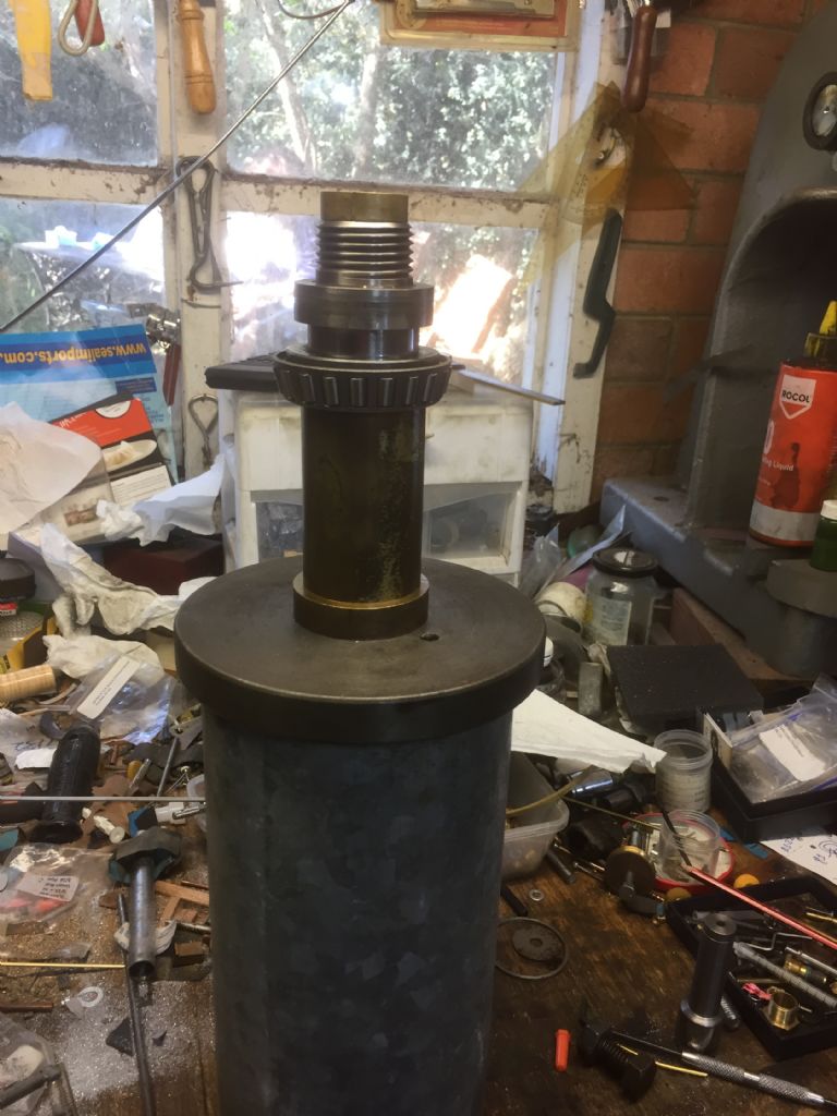

                                              I have finished the job and the lathe is back in service. I used a length of 12 mm threaded rod with various diameter lengths of pipe and tubes, some of which had to be cut and faced and one bored. The biggest headache was how to get out the old bearing outer race cones. There are two holes 180 degrees apart in the casting through to the cone seat so a pin punch can be used, but only a 3 mm pin would fit through the holes so I cut the shank of a 3 mm drill and used a 4lb hammer head, with my finger through the handle hole to hit the pin. There was precious little swing room in the spindle cavity, but I managed to get the front cone moving and turned up some longer pins to get it all the way out. The rear cone however was not going to move, especially as the backgear was in danger of being hit with the hammer. I tried to get a gear puller in behind the cone but it couldn't grab. Eventually I tried cutting a big washer into quarters and poking it in behind the cone where it could engage by just a mm or two. I then used a pusher. I thought I would have to screw the segments to the pusher, hence the holes, but friction sufficed, and after a couple of frustrating days trying to come up with a solution, the cone started to move.img_1862.jpg

                                                This shows the method, with a wheel spreading the force on the front inside casting. You can see one of the pin punch holes on the left side near the spanner.img_1864.jpg

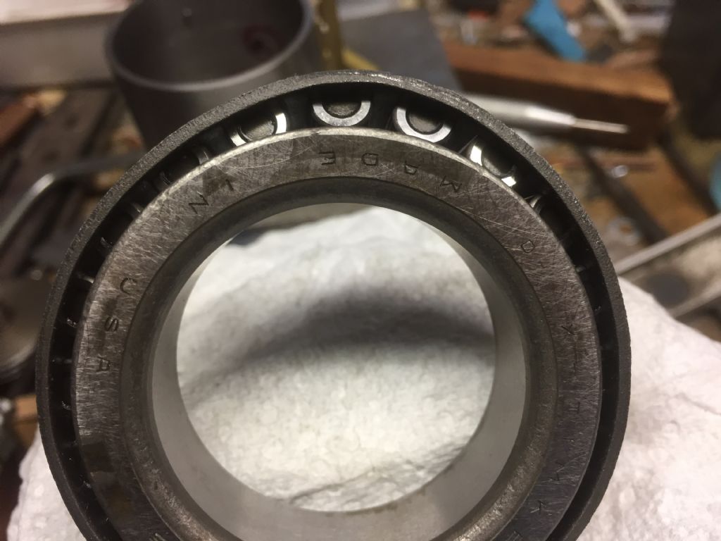

                                                  This is the damaged bearing that caused all the trouble. Ignorance resulting in the used of a too small spacer which was pushing against the roller cage.img_1848.jpg

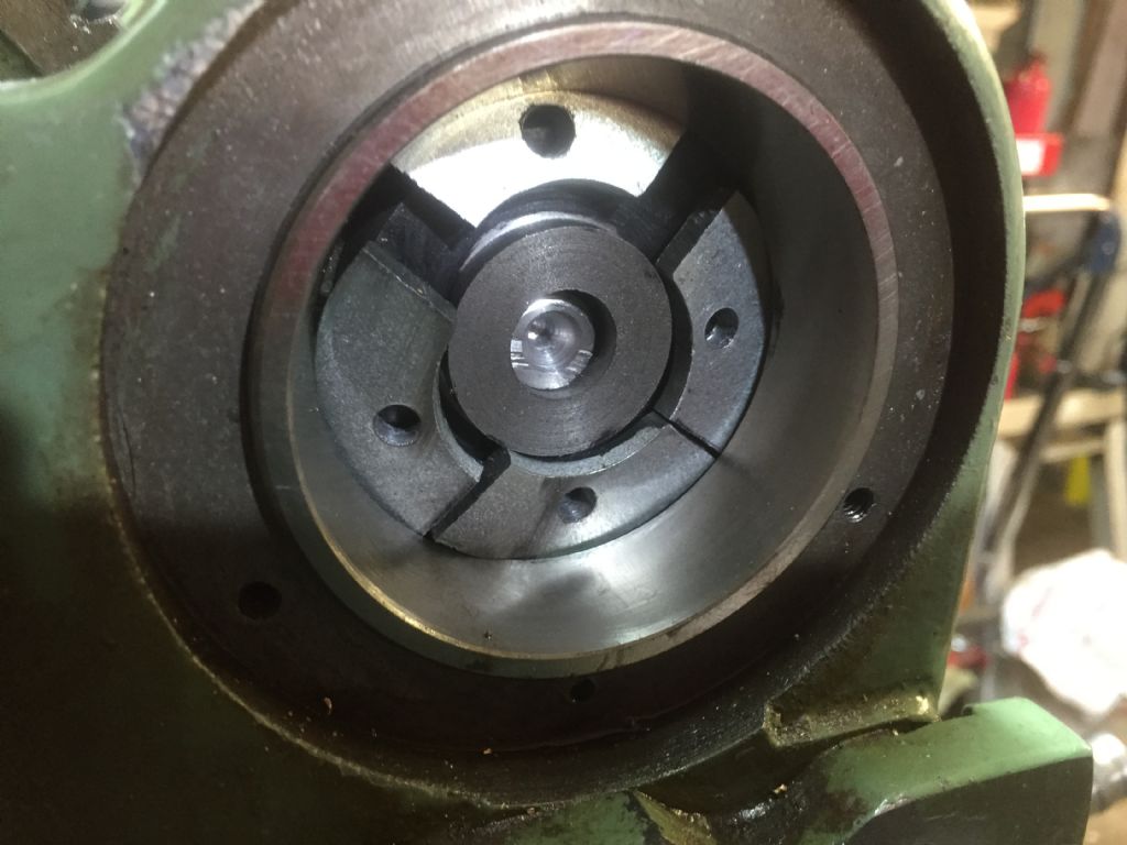

                                                    I had to find a large bit of pipe, a lathe faceplate, a spacer and a bit of tube the right diameter to bear against the bearing inner race in order to drive the front bearing onto its interference. For this, img_1869.jpghammering on the spindle end, with a block of wood between, seemed the only way.

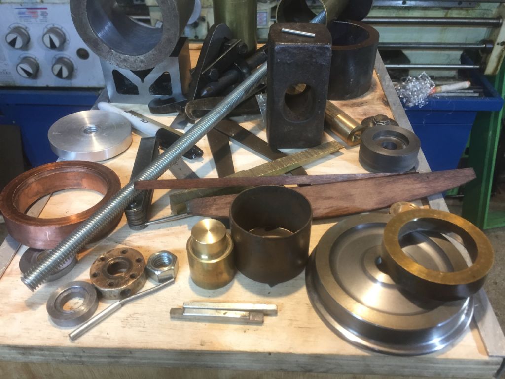

                                                      The items needed for the job, not all of which worked, such as the puller.img_1917.jpg
