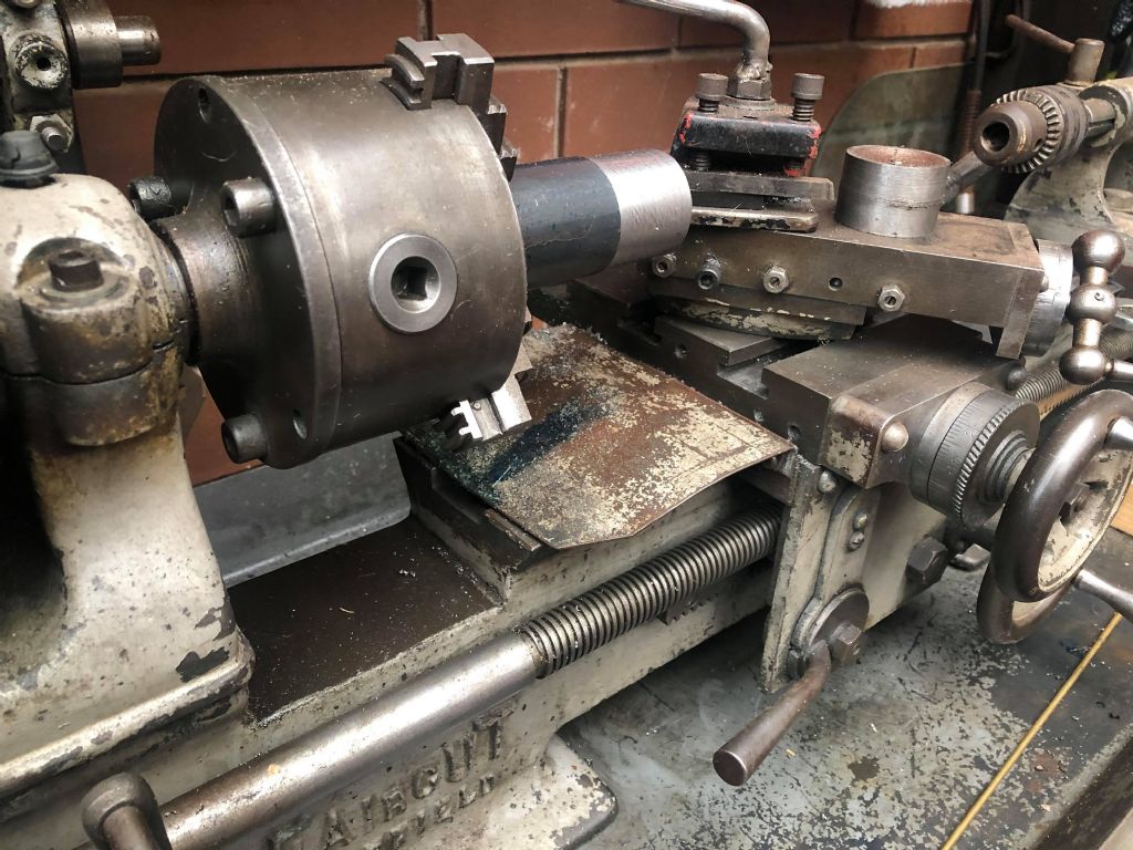

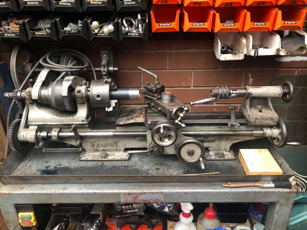

      I thought i'd share the story of a little lathe I picked up several months back. I got it home and covered it up for a bit while i got some other things sorted out. I've since given it a bit of a clean up and begun the process of acquiring what seems like an endless amount of tooling. I've been looking for a lathe for a long time, and this one appeared out of nowhere on facebook for a price i could not refuse. Luckily i was one of the first people to enquire and i later picked it up only to realise i did not have the forklift necessary to get it out of the van. Thankfully i was able to remove it with a bit of thinking and a lot of muscle.
      I've spent a lot of time researching this lathe in order to better understand it. I'm only a novice so it would be great to learn more about the lathe and machining in general. I have a workshop at home and I do a lot of wood/metal work, but my main interest is knife-making.
      So this is the lathe when i got it home
      Pay close attention to the quality of engineering applied
      This is how dirty she was
      This is how she cleaned up
      I'll upload some more pictures shortly. Thanks for looking.

          That looks like a nicely made little lathe, I'd like to see more of it as you resurrect it.

            Congratulations on the new (old) lathe. It looks pretty complete and in decent order.
            I'd say it's an early model – it has the flat belt pulleys and the power feed knock-off doesn't extend along the whole bed. I suspect your backgear covers are steel (like mine). Later ones seem to be gunmetal or similar.
            It looks like yours has a half nut and a rack handwheel. I've not seen any other Faircuts like this (most have a permanently engaged full nut) so I'd guess it's a user modification but looks pretty neatly done from the photos.

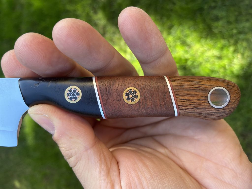

              Unfortunately (or fortunately, depending on the way you look at it) i'm in Australia, but I'm happy to answer questions on knife making. I love talking about it. Here's one i prepared earlier:

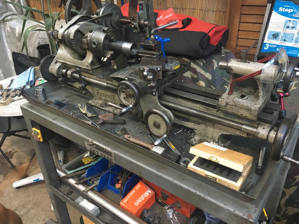

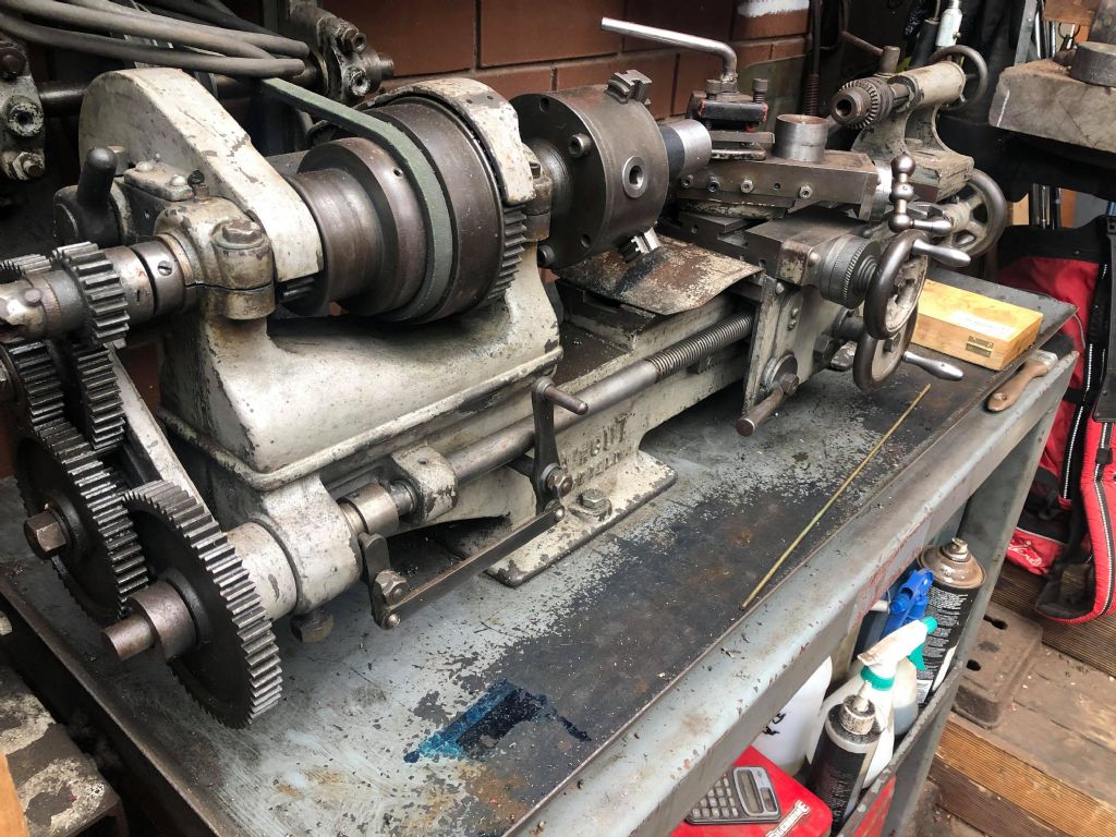

                  So i've only really run it for short amounts of time, and as i had no oil, i opted for engine oil (im awful, i know). I'm currently looking for oils and i've found some on ebay that i think might work. I (obviously) don't know a great deal so does anyone know if ISO22 will be appropriate for the bronze spindle bearings? This particular seller also recommends ISO68 for the external gears and another type of ISO68 for the ways. Does this seem like a good start? The spindle bearings only have oil caps, can anyone recommend a good oiling procedure for the novice?
                  This is how she sits in her final resting place

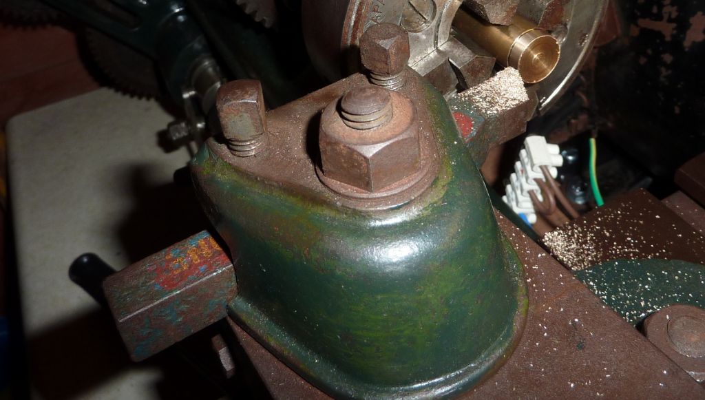

                    A magnet will tell you if it's ferrous or not. The main reason you'd want to know is in case you were thinking of stripping and polishing the covers – if they are steel then don't bother.
                    I use ISO 100 Mobil DTE Heavy in my headstock bearings. I have no idea whether this is right for the lathe or not beacuse there is no known surviving manual. The spindle speeds are pretty low so I doubt whether it is too fussy, but as you probably know, car engine oil is not a good idea. Probably better than no oil at all but get some proper stuff ASAP.
                    You may find the oil cups rather small but whatever you do, don't be tempted to alter the holes in the headstock bearings. The parts I had from Steve King came from one that somebody (not Steve) had drilled and tapped for bigger oil cups. One of the bearings broke across the modified oil hole.
                    I think my lathe has the original plain brass cups. I've made some brass lids to stop muck falling into them.

                            I add oil before starting up and try to keep the cups topped up each time I stop the lathe to check, measure etc. My lathe does get through a fair bit of oil like this and it all ends up collecting under the headstock. I don't worry too much if the cups are empty at the end of a cut because the bearings will retain some oil but I do try to keep them topped up… without getting overly obsessed with it.
                            With some chucks and speeds the oil can dribble down the back of the chuck when the lathe is stopped and will then be thrown around the room when you start up again unless you wipe it off.
                            Some people fit drip feed oilers but like I said, don't drill or tap the holes in the headstock casting.
                            I've seen someone suggesting shimming the caps but I don't think this is correct for simple split cast iron bearing housings. I think the advice is correct for at least some Myfords but they have a different design.
                            The usual procedure for adjusting the bearings is to oil them and then tighten until you feel some drag when turning the spindle, thne just back off a little. Be cautious if you suspect a lot of wear because if you push the bearing housings too far then you can break them. Sorry it's pretty un-knowable how far you can push this – I'd be cautious – you can always tighten them more another day.
                            I've put some tape on the heads of my bearing bolts with arrows drawn on so that I can see how much I have moved them and also tighten them to the same spot again if I ever take the spindle out. I see that one of yours has been replaced by a socket headed screw. Mine are both hex headed bolts.
                            Oe final point about bearing drag – the whole headstock is secured to the bed by one bolt from underneath. If I loosen this bolt the spindle binds up so clearly the headstock flexes a little as this bolt is tightened… so tighten this bolt before doing anything with the bearing bolts.

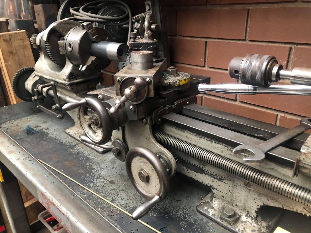

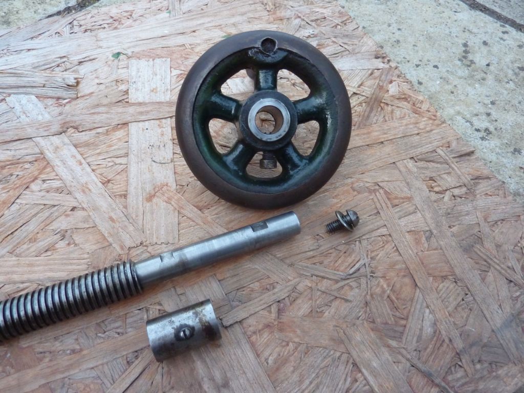

                              I noticed that there is actually a LOT of backlash on this machine. For starters the entire carriage moves back by about an inch when pushed. The lead screw has a lot of end-play, but when i hold it all the way in, the carriage wont move. That's issue #1.
                              Issue #2 is that the cross slides, particularly the compound slide, have a bit of backlash. Ill have to adjust these and tighten the gibs.
                              I actually managed some nice cutting after locking the compound slide in place. Might not be useless after all. Strangely my machine had brass shims in the casting gap for the bearings. They match the profile of the headstock casting. I dont know if this is factory or just attention to detail. I removed them in favour of tightening the caps a bit more, but now i might take it back as this 'breaking the headstock' business is quite frightening.

                                The movement on your leadscrew sounds huge so there is something very odd going on there. I assume from what you have written that the leadscrew itself moves by an inch when you push the saddle. If the leadscrew does not move then the issue probably lies in the half nut or its attachment to the saddle.
                                The lead screw end float is one part of the backlash (the others are wear in the nut and leadscrew threads). It should be possible to adjust almost all of the end float out – you just need enough play so that the handle will still turn.
                                Here is how it SHOULD work… it's adjusted by slackening the screw on the side of the leadscrew handle boss and then using the screw in the centre of the wheel to get more or less end float. Once you are happy, tighten up the screw on the boss again to lock it in place.
                                Having said all of that, an inch is enormous so there must be something else going on, like perhaps a part missing or the wrong part used… although I can't see anything obviously wrong in your photos.
                                I've posted a photo of the bits at the handwheel end of my leadscrew so that you can see how it works. The wheel can be removed without taking the whole leadscrew out BTW. If you do want to take your handwheel off and it needs any 'persuading' then be careful to use a soft faced mallet.

                                  As for the leadscrew, you are correct. I suspected that the wheel could be moved inwards to take up the end-play. How much so, i was not sure, but now i am. I know it seems excessive but when i hold it in place, i cannot move the carriage at all. The slide wheels wind in and out, which appears to be an adjustment issue in the brass nut underneath (from what ive read).

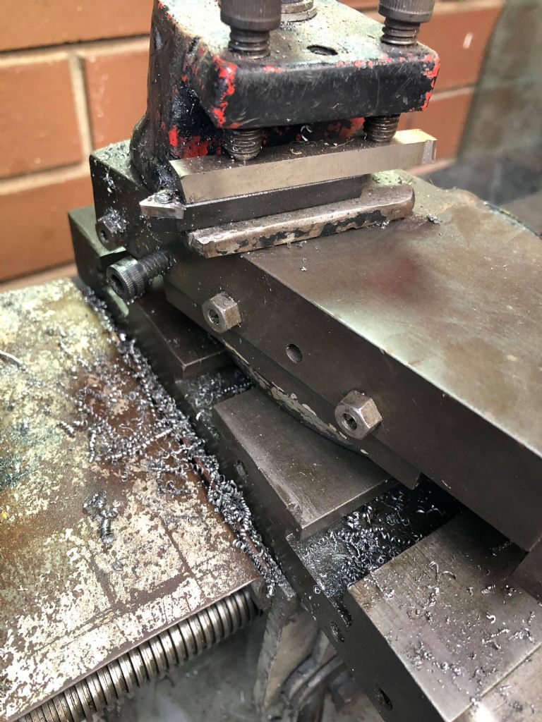

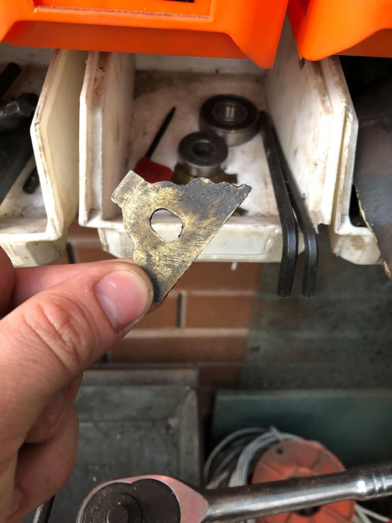

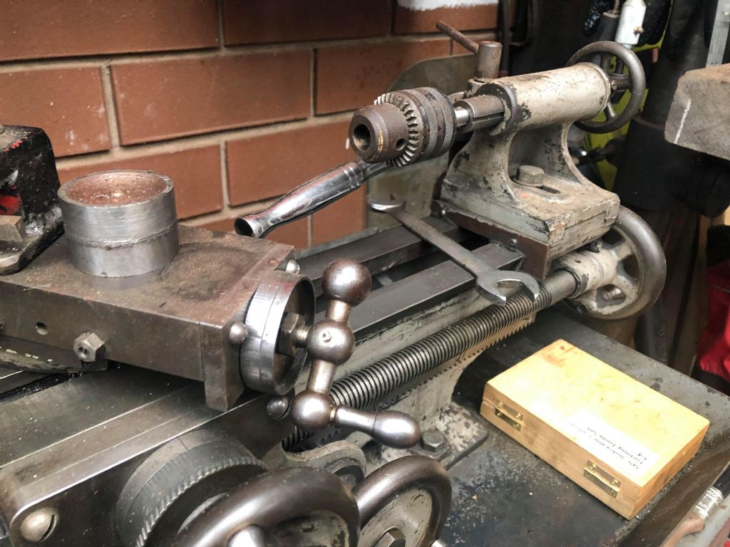

                                  This is the lock but i'm not sure if it's factory. Also pay close attention to the tooling. It is 1/4", yet still a few mm too tall. I'm at a complete loss as to what tooling was used in this tool post if 1/4 is too small. This is why i was so confused in the first place.

                                      I suspect that your toolpost is intended for a different lathe. The original Faircut ones of this era definitely lack the 'shelf'. Sourcing something like that will probably be difficult so your best bet will probably be to modify one or mill a new one from a lump of steel.
                                      Your compound locking screw and probably that second 'in between' hole dont appear on my compound and I suspect they are user mods.

                                      I'm not sure I fully follow what you are saying about the handwheel(s) but if you are still having problems them maybe post some close up photos. My cross slide screw end float is adjusted in the same way as the main leadscrew. The compound simply has a nut and a lock nut. Both your cross slide and compound screws have dials so the adjustement arrangement may be different from mine.

                                        Looking at your pics the tool post holder appears to have a base on it , On my Faircut the cutting tools sit on top off the slide 3/8 tools line up great with the chuck centre, Another thought has your top slide been altered resulting in the height being raised diffecult to tell from pics., Cross slide slackness the small cylider thats fits on your leadscrew is the grub screw engageing in the leadscrew thread and fitting tight up to leadscrew holder at the end , your hand wheel should then fit tight onto the other side of your leadscrew holder , Any slackeness here before your cross slide moves must then be a slackness in the leadscrew nut, My lathe had this problem worn Phosfor Bronze nut. Leadscrew and nut replacement had made, Over the years lot of mods keep being made .

                                              That handle is a work of art, very nicely done.

                                                As for the toolpost, i think that whoever adapted it to that lathe was grinding HSS blanks to achieve the correct centre height. Why else would you limit yourself to 1/4 tooling? Even then, the 1/4 tool is a fraction above center. I intend to get some 3/8 or 10mm tooling which should work once i chop the bottom part off. I just hope that it doesnt compromise the rigidity (dont see why it would). Also, i could potentially use a quick change tool post as they allow height adjustment. Seeing that toolpost on there threw me, i thought that just because it was there it had to be right. I'll have to study yours carefully to get a good idea of what im doing.
                                                The locking screw looks like a modification, but a good one as it locks it in nicely.

                                                  I appreciate that. I really liked that one, it's a pity i gave it away.

                                                    Ok i just looked at your tool post, andy, and realised its virtually the same as mine. For some reason i thought you had the 'lantern' type. This leads me to believe my toolpost is original, however it has been modified. I have absolutely zero idea as to why anyone would want to add height, but i now feel less concerned about cutting that part off.
                                                    #472958
                                                    Andy Carlson
                                                      @andycarlson18141
                                                      Hi Jake,
                                                      I don't see why cutting the base off the toolpost would affect rigidity either. Having no 'shelf' does make setup a little more awkward because you need to slacken the tool clamping screws before adjusting the toolpost angle and then tighten it all up again in reverse order. It's also not great when you want a 45 degree angle because then the tool doesn't have much support underneath it. I usually set the compound around to provide better support in this situation. 'Quick change' it is not!
                                                      I can understand why this extra awkwardness would motivate someone to fit a more conventional toolpost but then as you have seen, tool depth becomes an issue.
                                                      I'm not sure how similar our toolposts are but from what I can see in your photos I don't think that yours is a modified version of mine.
