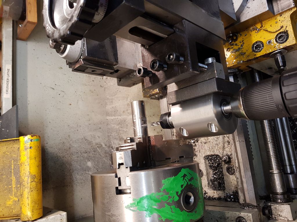

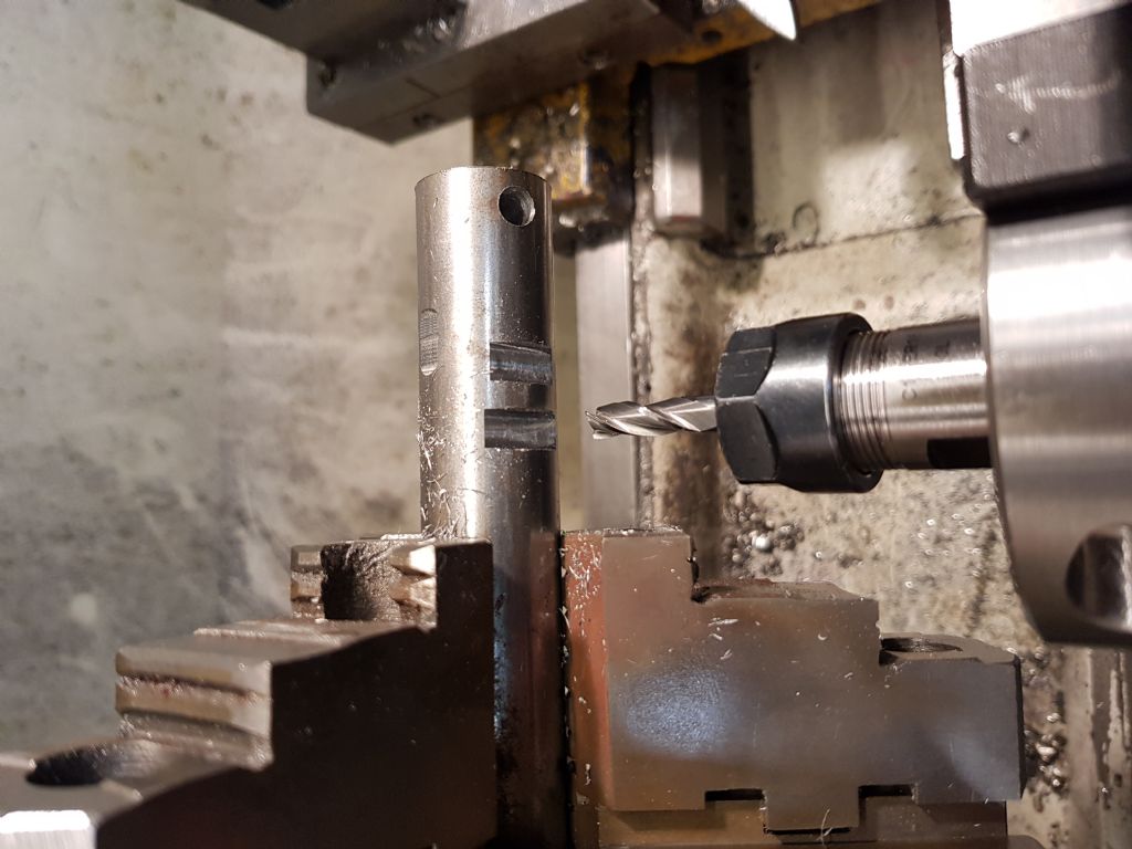

        I've been watching too much youtube lately!
        I've been inspired to make a drill powered "live" toolpost powered by a battery drill. I've had great success, (for a change!). I can mill a slot and drill holes quite well. I need to make an indexing plate and spindle brake, before I'm calling this one done.
        My question is, has anyone else done this? I'm thinking about having the toolpost spindle mounted to a slide, (such as a vertical mill slide), to allow me to mill flats vertically.
        I can index etc on the mill, but quite like the idea of doing quick jobs on the lathe.
        Can anyone help?
        Thank you Jim

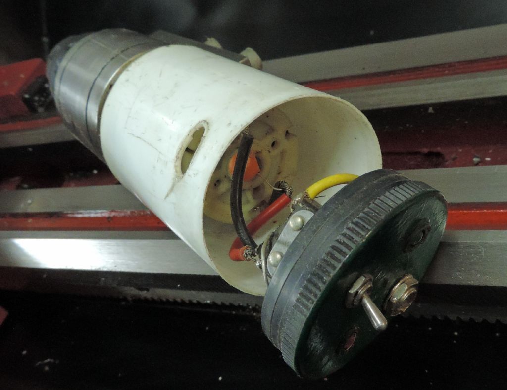

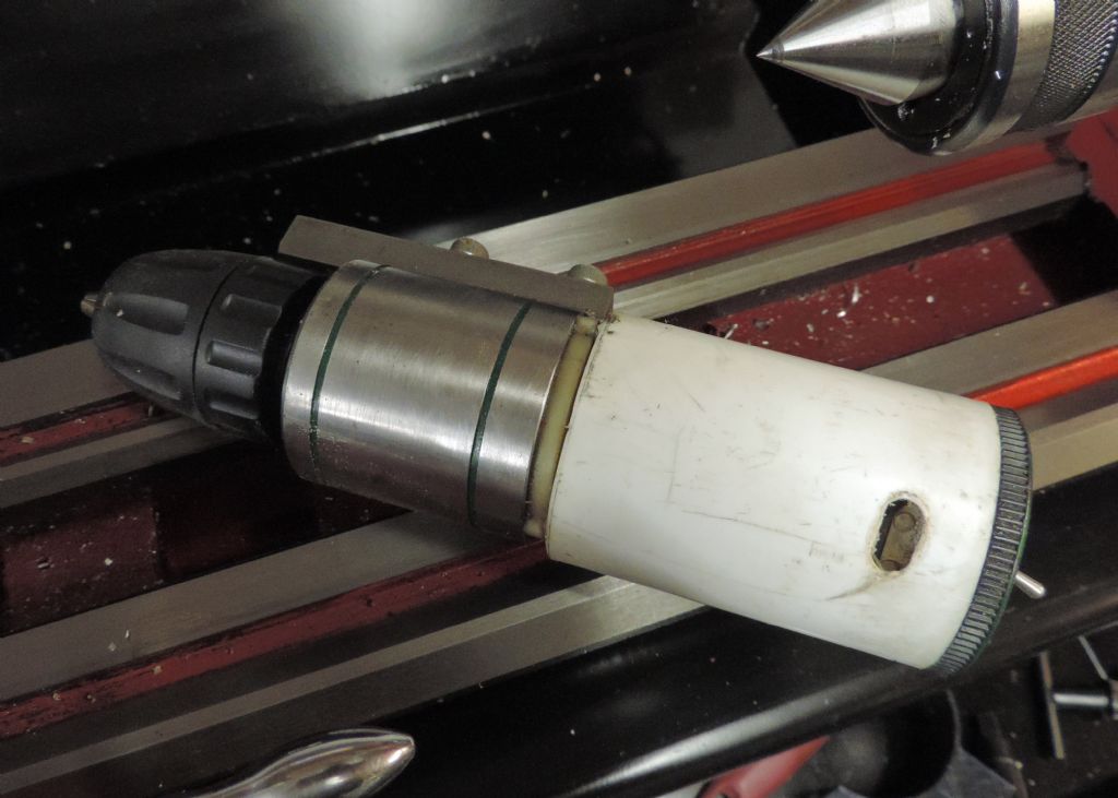

                Great minds think alike!
                I made this about 15-16 years ago. A steel body replaces the casing and slipping clutch of the original drill. The 'motor casing' is a spice tub. Limited by the poor quality (original) bearings and chuck but I did a few jobs with it:

                      Thank you for all the replies.
                      I'm using an ER16 collet at the moment, that will allow up to 10mmØ cutter, which is plenty for now.
                      Rod,and Les, your photos have further inspired me, thank you!
                      I'm going to sort out a spindle brake and indexing plate, hopefully I'll get a cheap vertical slide soon.
                      Jim
                            #369087
                            jimmy b
                              @jimmyb
                              I'm very pleased with progress so far. I'm powering the spindle with a Makita battery drill for now. Its working very well!
                              Just need to sort out a spindle brake and indexing ring for the back of the spindle next.
