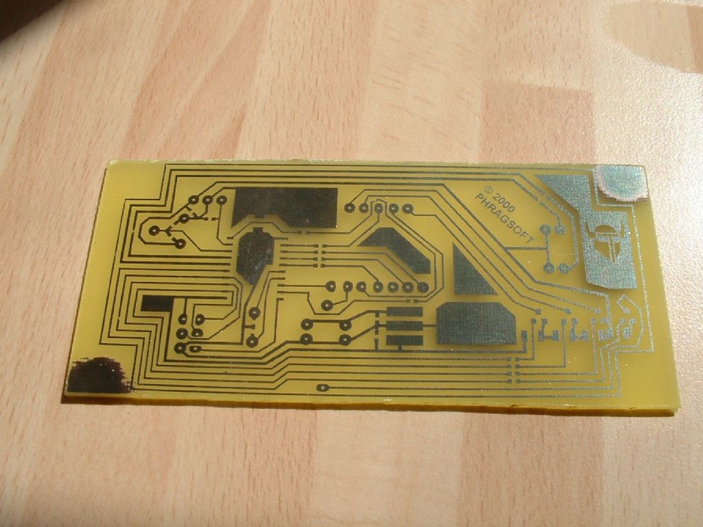

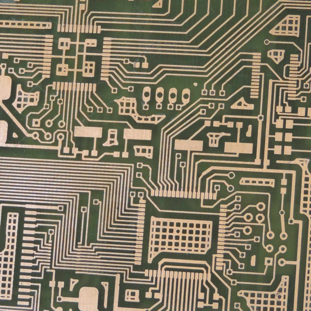

                                I'm surprised that some people seem to struggle with laser-printed masters.
                                This is one of my early inkjet-boards:
                                And this is a double side board made with the help of a laser printer (the Samsung, I think, which I don't think is as good as the HP). For a double sided board like this (about 100mm square) you don't want dodgy masters. The minimum track width is about 12 thou, so on the generous side, I go smaller if I need to go between pins.
