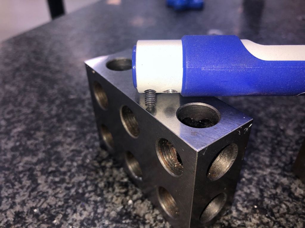

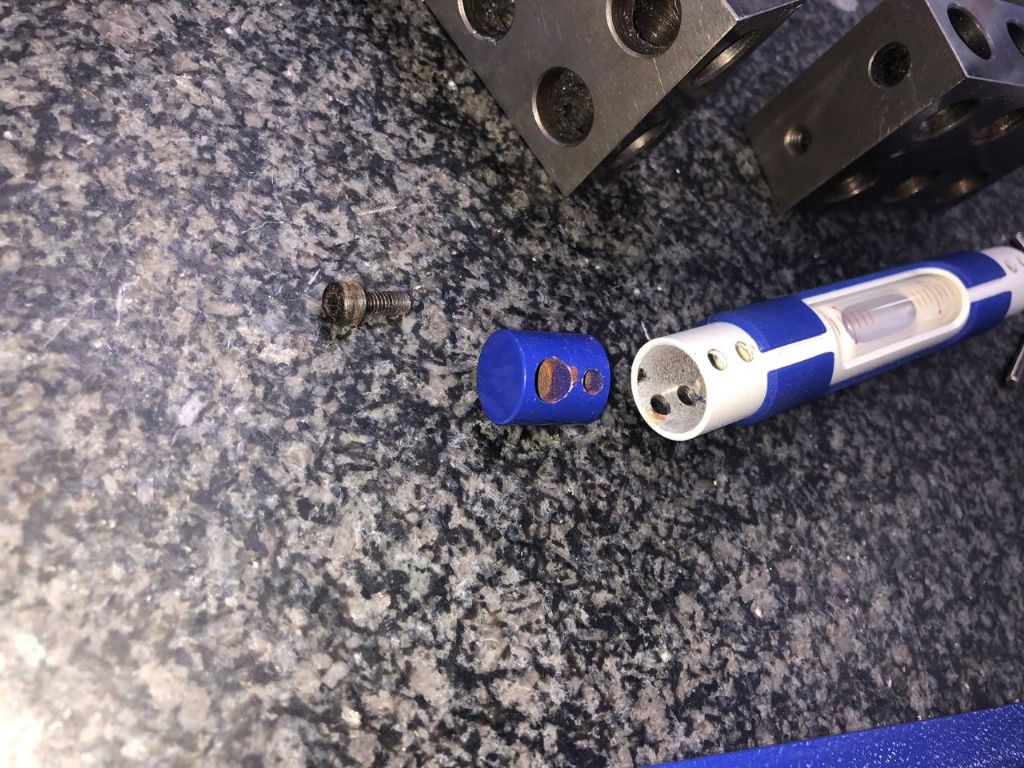

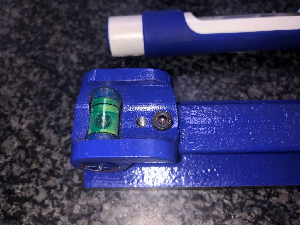

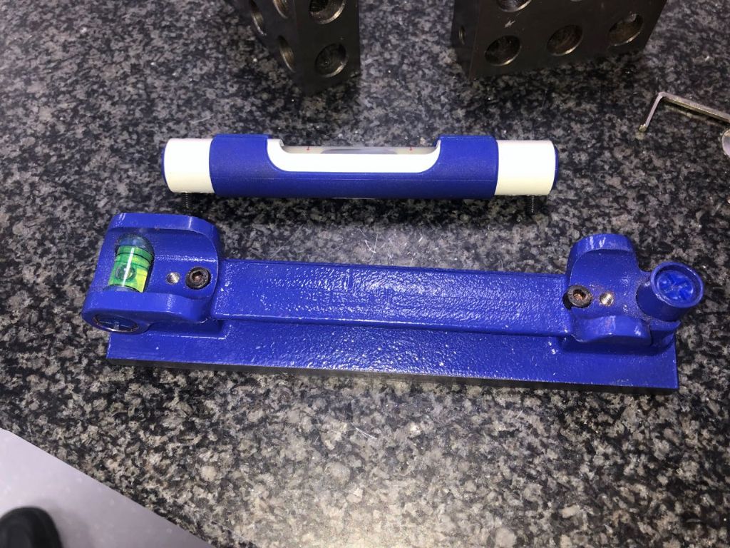

                            So my curiosity got the better of me and I took the thing apart to see for myself what is going on inside. I have to admit that I'm not overly impressed with the construction and quality of the machining…….what was I expecting for less than £100?
                            The vial is held in an aluminium tube that has some form of external paint finish and this bears onto the heads of the 'adjusting' screws that appear to be fairly standard hex headed machine screws. Quite crude really!
                            So here's a few shots of the innards…..
                            #487393
                            Baz
                              @baz89810
                              Looks crude but obviously works, cannot think of a more elegant way of doing it without costing a lot of 💰
