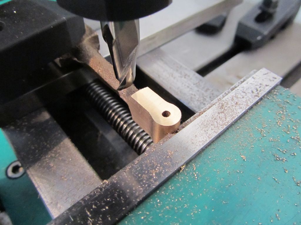

      As Muzzer says the corners got some use during the stepped roughing operations so if there was an issue with the newly ground edge is should have shown up here. I agree with Jason that a test cut compared to that of a new cutter would be useful.
      Just minutes ago the same cutter was used to reduce the thickness of the profile. I had to remove 0.55mm from the top and bottom face so did 0.3 then 0.2mm DOC at 40mm/min and then a final 0.05mm DOC at 20mm/min.

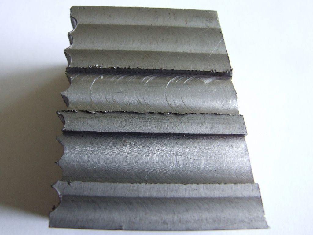

              Here are the results of a quick milling trial. Material is, I think, EN1A. Both slots are 1.6mm deep and 10mm width, taken in one pass. Top slot is with a worn and chipped three flute carbide cutter running at 1500rpm and 375mm/min. Bottom slot is with a nearly new, and used mainly on the side flutes, four flute carbide cutter running at 1500rpm and 450mm/min:
              Clearly the top slot is rougher, and the sidewall finish is iffy. I took three surface roughness measurements in each slot. Results were:
              Top slot: 2.16 2.16 3.31 Average 2.54µm Ra
              Bottom slot: 3.40 2.41 3.25 Average 3.02µm Ra
              Not an intuitive result.
              Andrew

                                      An observation on Andrews 'counter-iintuitive' result:
                                      Posted by Andrew Johnston on 31/05/2015 12:33:00:
                                      <I won't waste room reposting the pic>
                                      Andrew
                                      1500 rpm at 4 flutes is 6000 cuts per minute. At 450mm per minute that's a feedrate 0.0.075mm or about 2 thou per cut. Halving the feedrate might noticeably improve the finish and reduce the surface roughness with the new cutter.
                                      But why is the 'blunt' cutter better? – It seems it's either acting like a lathe tool where you stone off the end or burnishing the work (I suspect a combination of the two, with the 'bright' areas being more burnished. As this is a raher rough and ready approach the visual appearance is poor and less consistent (variation in roughness readings 1.15um with the blunt tool, 0.99um with the sharp one).
                                      Lesson learned? Possibly that, if your main use for end mills is using the ends to clean up flat surfaces, having a few endmills with the corners neatly ground off may give the best results, but if you use sharp ones, drop the feedrate on the finishing cuts.
                                      Your thoughts, gentlemen?

                                        #192183
                                        Anonymous
                                          Posted by Neil Wyatt on 02/06/2015 20:15:20:
                                          I've been called many things, but a gentleman wasn't one of them; nevertheless you're still going to get my thoughts.
                                          I'm not entirely sure I believe my surface roughness measurements. It's a bit of a black art, or so it seems. The finish with the nearly new cutter certainly looks better. Spot on, I did the calculations in my head based on 2 thou per tooth. That's pretty conservative, I'm happy to run faster. As JohnS has pointed out endmills and slot drills are slightly hollow ground, but only by about 1°. So for a 2 thou advance that's a height difference of about 35 microinches or about 0.86µm. That's rather less than I am measuring? I am measuring Ra, which is an average. The conversion to a peak to peak measurement (Rz) is rather fuzzy, but generally somewhere between 10 and 20 times?
                                          A facet of finish that is often neglected is uniformity. As well as aiming for a 'good' finish I try and achieve a uniform finish, even if it is a bit rougher. It's no good if the finish starts off looking like a babies bottom and then reverts to looking like a badgers rear end. smile o
                                          When I really need a good, smooth, finish (sub-micron) I use cutters with a radius ground on them.
                                          Andrew

                                            Roderick Jenkins
                                              @roderickjenkins93242
                                              Tubal Cain in "Milling Operations in the Lathe" (WPS 5) comments on corner rounding spoiling the cut and how this may be stoned to improve surface finish. He goes on to say "Naturally, if the cutter is required only for surfacing, you can put a deliberate bevel here, with great advantage to both cutter life and finishing"
                                              By the way, don't be fooled by the title of this book, it is an excellent general treatise on the action, use and maintenance of milling cutters – much better IMHO than Arnold Throp's "Vertical Milling in the Home Workshop" (WPS 2) .

                                                  With regard to end mills for surfacing. I have a 3/4 inch cutter (bought second hand) which I ground the corners at 45 degrees (Quorn TCG) to give about 2 mm depth of cut without cutting on the side of the cutter. This is the cutter I use most. The 135 degree corner angle gives me a robust cutting edge similar to a roughing lathe tool which does not overheat easily and means you don't have to regrind the flutes. It produces a good finish and removes material quickly (Myford VMC mill). I would recommend this to anyone who has the facilities to regrind as described.
                                                  I'm sure this is not a new idea at all. In fact I copied it off the telly. (Old Fred Dibnah Video)
