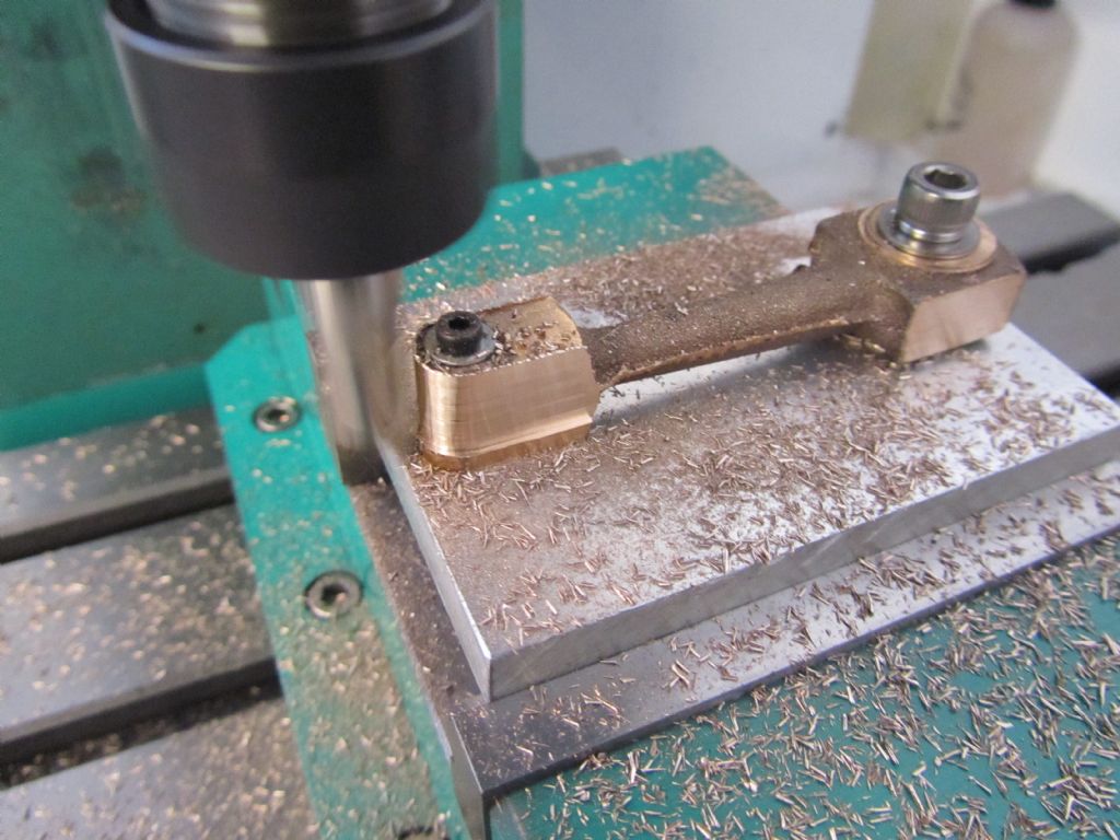

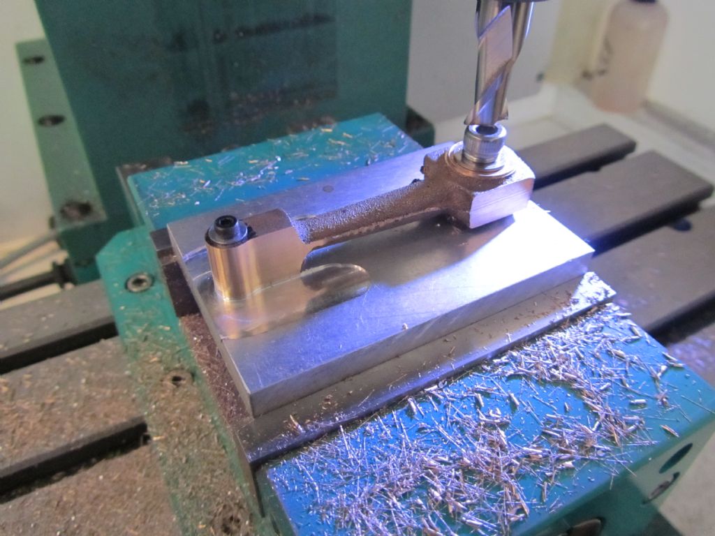

                                    Hi Jason, it’s a valid point which I think I can answer with another photo. Out flying at the moment and can’t upload from my mobile…

                                            The slot cutters I took to Harrogate all had the corner "ruined" (by me) about 1mm on the side and across the face. I went through a spell of running my spindle speed to fast when milling steel and took out a few cutters before the penny dropped. Having fairly light weight equipment my DOC tends not to be more than 0.5 to 1mm for steel.
                                            For the operation shown in my previous post I milled about 1mm in and about 3mm deep. The shoulder looked good and this is the area of the cutter where the wear was. I used both climb and conventional milling when roughing out (depending on which side I was milling) and then climb milled 0.05mm off full depth to finish off.
                                            For my use the cutter was brought back to life as the blunt corner was ground away. Now that there are a few machines out in use it would be good if someone could do a comparison of a new cutter and a sharpened cutter on the same material, parameters e.t.c and publish the results on the forum, this kind of testing I have seen more on a forum rather than a magazine article.

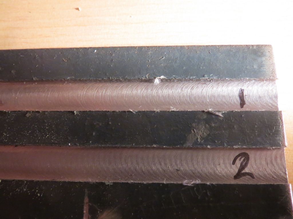

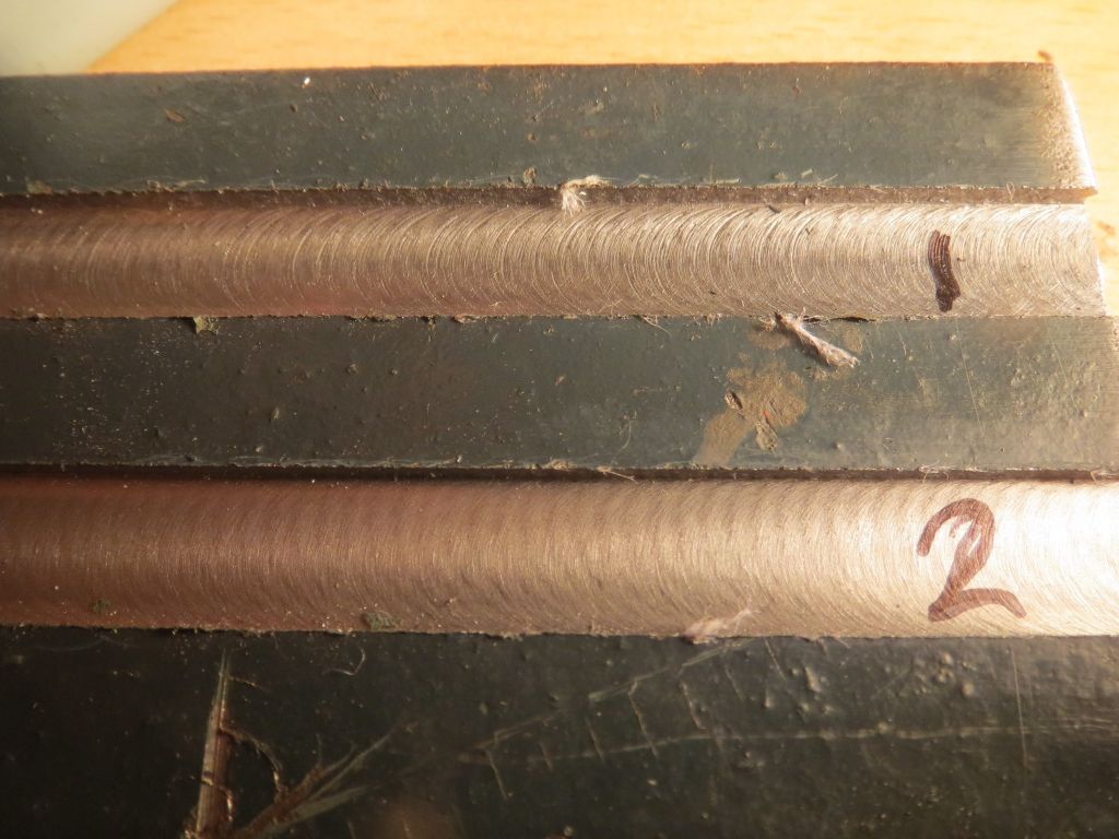

                                              Comparison 3Comparison 2For your consideration, may I draw your attention to the above photos? Material is unknown mild steel, cutter is a 10mm HSS, spindle speed 510rpm, feed 4"/min (aprox, but was the same for both cuts). DOC is 60thou. In all photos 1 is the cutter as found (second hand, used), 2 is after grinding.
                                              Your comments are invited.

                                                No.1 looks like the deeply scratched finish I get when the cutter is blunt and No.2 looks much cleaner cut?

                                                  Posted by Michael Checkley on 30/05/2015 18:49:01:
                                                  Agreed … But I would also suggest that the spindle is perhaps not perpendicular: Even on No.2, I can see no evidence of the 'trailing' cutter-tip doing any work … It's nicer to see overlapping circles.

                                                    Certainly an improvement but still a bit ragged at the edges.
                                                    Michael C. thanks for the additional imformation which does go to show its as much the removal of the blunt areas that makes the difference as it is the shaprness of the tips. As a get me out of jail option I have at times simply ground across the whole end of a blunted cutter at a very shallow angle, provided one flute is at the bottom the "new" cutter will cut very well when its side is used but absolutely useless when plunged.
                                                    As a lot of ME work is usually fairly shallow cuts then the small amount a shaprening takes off will no doubt work, but if a cutter were mostly used with a large amount of its side cutting then a lot more material would need to be removed to get back to a sharp side as well as just touching up the ends.
                                                    What would be an ideal test is to take two identical cutters one new and one that has seen a lot of use and then been resharpened, take these two cutters and do some side by side tests much like Owains and compare the results. Ideally on a CNC so feed rates etc would be identical and also some plunge cutting so maybe a pocket, and if the tester was able to measure surface finish RA values would be better than a photo
