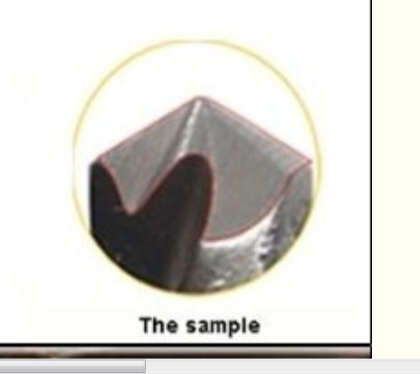

        http://www.ebay.co.uk/itm/MR-13D-NEW-2-13-MM-GRINDER-DRILL-BITS-SHARPENER-GRINDING-MACHINE-100-135-ANGLE-/111545794583

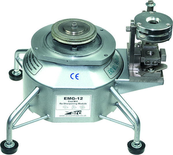

          Ketan Swali
            @ketanswali79440
            When I placed the advert in ME, I thought that the time gap between the advert in ME and the MEW would be short. I failed to take the digital issue into consideration. With hindsight I should have advertised in the ME after the review came out in the MEW, to avoid some of the misunderstanding.

              Vic,
              Believe me, some of these manufacturers don't know what is needed, one company makes one and every one copies, including the mistakes.
              The one you linked to grinds a drill like this.
              Which is very handy for cordless drills with fast reverse wink

                      Posted by John Stevenson on 13/04/2015 10:33:11:
                      Vic,
                      I saw that graphic in the link I posted but I really don't believe it's even possible to grind a bit like that with this device.
                      A poor description or misplaced graphic is not enough to discount a device, we just need a dealer to obtain a unit and see if it works or not.

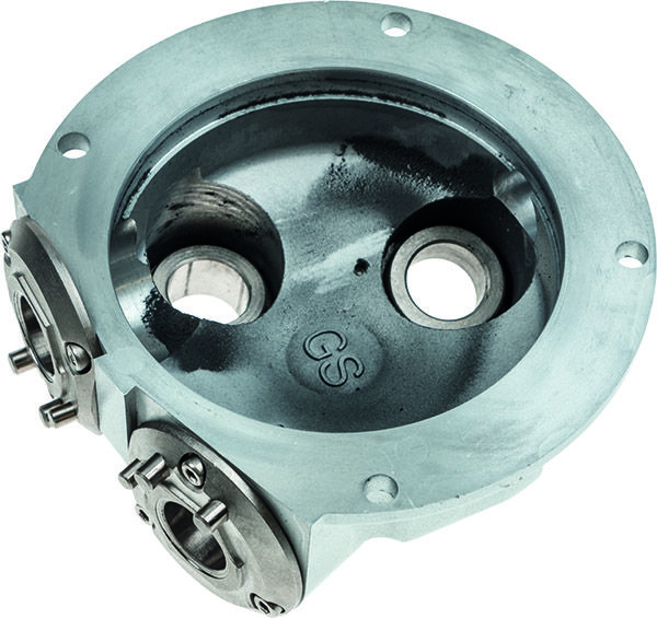

                              Now that the MEW 228 is out on digital and print, I believe that most of the questions on here have been answered.
                              With regards to MichaelGs question, here are two pictures from the manual:
                              This is the inside of the top part of the housing:
                              This is a picture of the top part removed, exposing the grinding wheel fitted to the motor which is fitted inside the bottom part of the housing.
                              Unfortunately I do not have more detailed drawings for the inside, but hope this gives the idea.
                              Ketan at ARC.

                                  Although Ketan has posted pics of the inside I don't think other than curiosity it would be much help.
                                  When using a proper conventional Tool and Cutter grinder such as the Clarkson etc., they are very versatile but take a lot of setting up and using. That is where the skill is involved and the time taken to set up.
                                  This little Module can only do the ends of cutters, which in all fairness is the most common wear point but it does it exceeding fast, with next to no skill.
                                  The skill level has been removed from the operator and built into the machine.
                                  I would hate to have to try to reverse engineer one. The design changes from size to size and even flute to flute are very subtle.
                                  Take say the cam for a 3 flute cutter which has 3 lobes on it, not all the lobes are the same, they are to look at them but one is subtly different so it allows a longer cutting edge for over centre cutting. Same on the 2 and 4 flute cams.
                                  The second hole that grinds the primary cutting edge, isn't a hole if you study it well, it's a slot but very slightly curved. On a 3 flute two of the cutting edges are ground normal but the slight difference in the other cam lobe means one tooth, the master,  describes a curved path which throws the edge over centre.
                                  A lot of work and design has gone into this so it can be operated very quickly by an unskilled person.

                                      #187385
                                        I got rung up by a reader today who asked a very valid question – where does the grinding dust go?* He feared it would gum up the delicate mechanism inside.
                                        I explained there was noting inside but a specially shaped grinding wheel BUT where does the dust go? Do you just lift the lid off at the end of a session and vacuum it out/brush it on the floor?
                                        *It's a very good question. Back in the 80s a friend of mine worked at a place that serviced BBC computers. They took the lid off a Master and found the space below the spring-loaded hatch for the ROM cartridges full of fag ash and dog-ends.
                                        #187389
                                        John Stevenson 1
                                          @johnstevenson1
                                          Yes good question Neil and because there hasn't been a picture of the rear then it isn't obvious.
                                          That port is 20mm diameter and I just push a 20mm plastic conduit elbow into it, nice snug fit, and a pipe going down into a bean can.
                                          For the show I'll bring the de-luxe model which has a small computer fan as on extractor and a chilli con carne tin for added flavour wink
                                          The machine also comes with a 1" paint brush to brush the  crap out.
                                          Edited By John Stevenson on 22/04/2015 13:06:22
