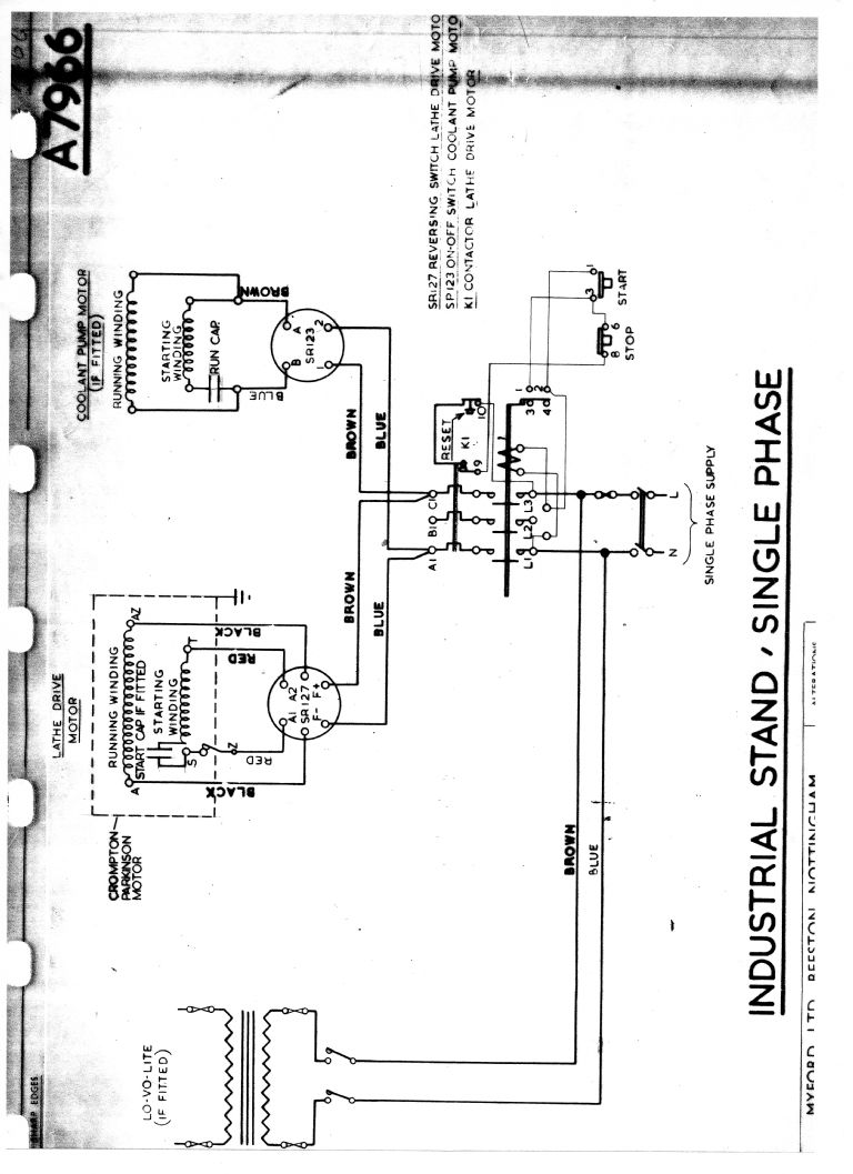

                    Robbo
                      @robbo
                      Original wiring diagram for single phase Industrial stand for everyone's info :-

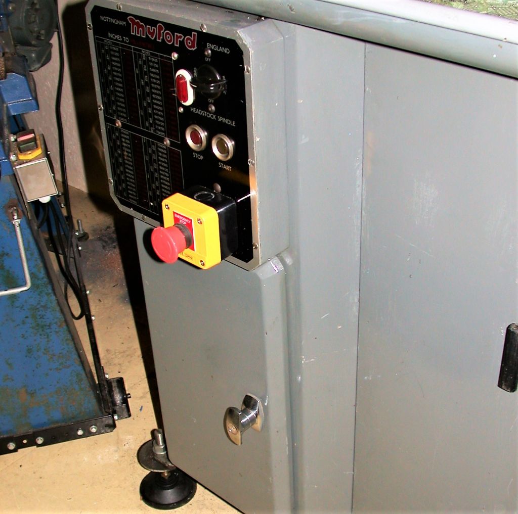

                        Robbo
                          @robbo
                          Steve
                          Have mine fitted where the coolant pump switch used to be. See pic.
                          You can just wire the EStop across the normal stop button, the existing wiring gubbins (sorry about the technical term) provides NVR protection.

                          #330087
                          Steve Bower
                            @stevebower42241
                            Yes that's pretty much what I was after. I've the suds pump working, so was going to mount on the adjacent angled section.

                              #330108
                              Martin Cargill
                                @martincargill50290
                                Robbo. Any extra stop buttons need to be wired in series with the existing button, not across it
