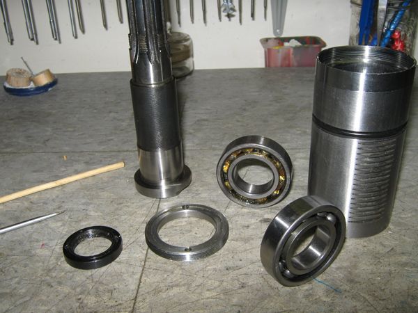

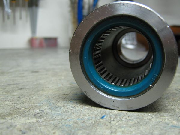

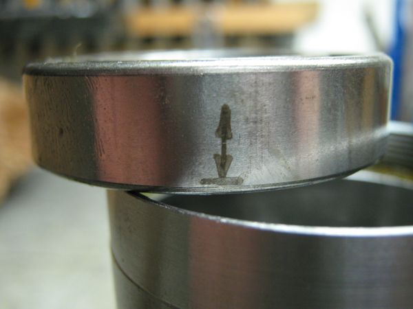

                img_3199.jpgimg_3204.jpgCorrection on my previous post
                There is a seal in the FB2 quill.When I bought my mill in 1988 there was radial play in the needle bearing .I notified Emco about the problem and they send me a new quill no questions asked.I still had the old set laying around but forgot about it till now.The top roller bearing are marketimg_3206.jpg for the axial trust direction.I am not sure which way they go in but maybe somebody can tell you The black threaded ring is left threaded
