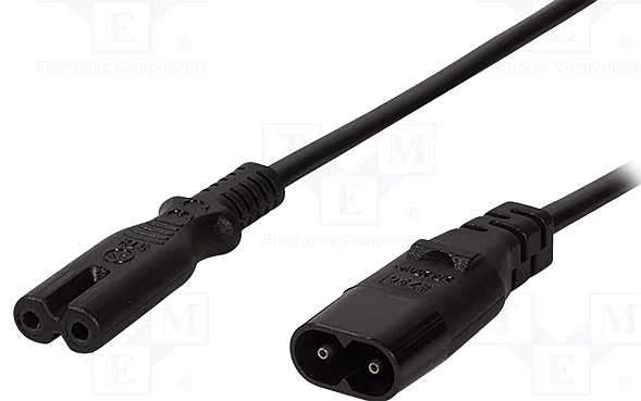

                                    Ian P
                                      @ianp
                                      On Andy_H Said:
                                      I hope this question doesn’t come across as too vague….
                                      I looking for a two-part in-line electrical connector to the following specification:
                                      – Mains rated (3A is sufficient).
                                      – Preferably 3-pin (although 2-opin might do at a push).
                                      – Fairly small (e.g. ideally smaller that the sort of thing you get on a lawnmower lead).
                                      – A female part that can be secured to a fixed metal bracket.
                                      – A male part that not fixed.
                                      I’ve spent a few hours searching google and ebay without success so just asking the question in case it’s a case of “ah, you want one of these”!
                                      Andy
                                      Your requirement does come across slightly vague but also a bit contradictory.
                                      A female part that can be fixed to a metal bracket could be a chassis or panel mounted socket but that conflicts with your ‘in-line’ connector as that usually refers to cable mounted male and female conns.
                                      If the female is mounted on a bracket (or a panel) and is outputting mains voltage to external equipment then fusing and other factors have to be taken into account. Small, 3 pole mains voltage rated, connectors are thin on the ground and I would think that any that exist are moulded have the cable moulded to them.
                                      The nearest I can suggest are the IEC C7 and C8 shown in the pictures. The female on the left looks a good candidate for being ‘clamp-able’ to a panel or bracket, but if it ts on a bracket external to your enclosure then somehow the cable has to get inside, so it would not exactly be a pretty arrangement.
                                      Ian P
