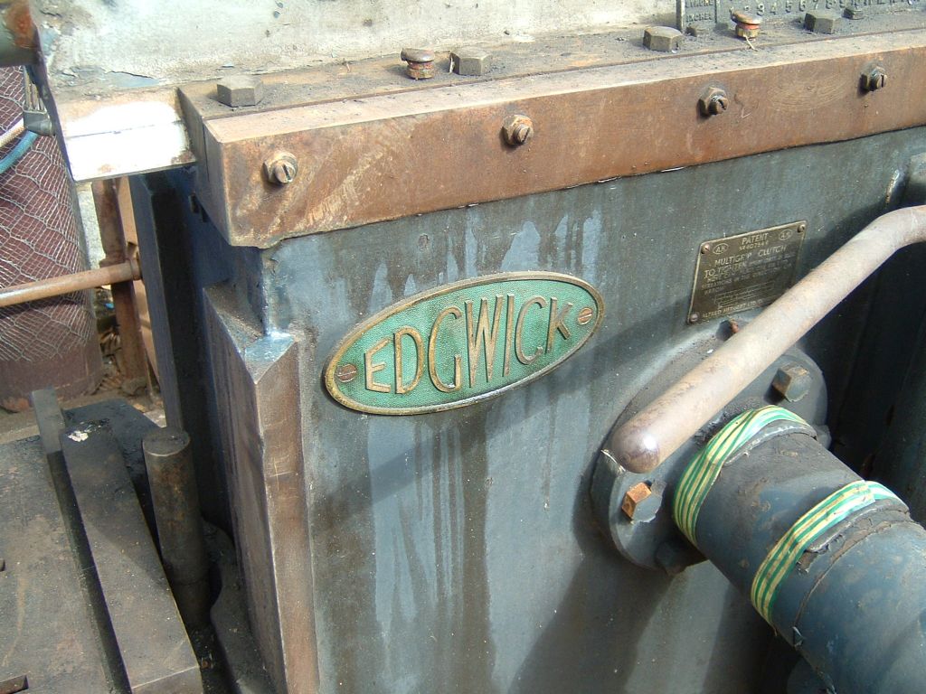

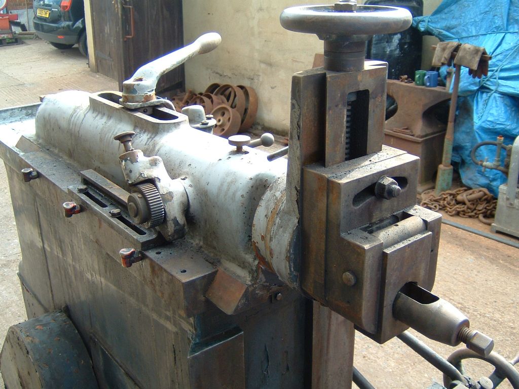

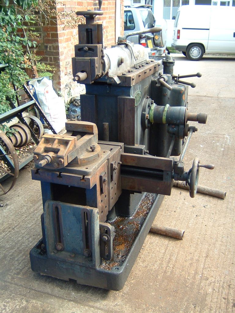

      Have a look at these pictures of an Edgwick 20" stroke shaper that I bought yesterday,
      It was made by Alfred Herbert of Coventry,
      Havn't found a serial number yet, but hope to get a manufacture date for it sometime,
      It will be a nice restoration project ( when I get to it ),
      An interesting feature is that it has power feed on the vertical slide,
      I hope to find a maintenance manual for it,
      If anyone out there has any infornation on this machine, I would be very interested to hear from them.
      I used to have a 30" stroke Elliott a few years ago, but now regret selling it,
      I also have a 14M Elliot

                #126682
                GoCreate
                  @gocreate
                  Hi Richard
                  Nice shaping machine, puts my 10" Elloit in the shade, lovely machines to work with.
                  On your 4th photo there is an ratchet arrangement on the side of the ram, what's that for?
                  Power feed to the vertical slide?
                  Nigel

                    That looks a great machine, I do like shapers and have 5 of them but they are getting harder to find.
                    Your'e lucky to find something like your Edgewick and it looks complete too.
                    Is the small ratchet on the left side of the ram some kind of auto feed ?
                    Regards
                    Paul
                    #126713
                    RICHARD GREEN 2
                      @richardgreen2
                      Hello Nigel and Paul,
                      Yes, that ratchet arrangement on the side of the ram is the power feed mechanism for the vertical slide , it has a useful "on / off " control on the ram right behind the vertical slide, so you can control the down feed at will , while the machine is running,
                      Geoff, I have a 600 sq ft engineering machine shop that I run commercially, it sounds big but unfortunately is FULL , with machines , tools and equipment, probably a lot of it I don't need , but I am obsessed with old machines etc, and I like to give them a new lease of life if I can.
                      I used to be greatly involved with the overhaul and repair of pnuematic and mechanical forging hammers, this involved a lot of shaper work, to make anvil raising blocks, and hardened steel die blocks, which all had various shapes and sizes of dovetails on them so they could be attached to the hammers with fitted wedges , This was why I needed the 30" stroke Elliott shaper
                      So unfortunately I have no workshop space for this Edgwick shaper !  but that didn't stop me buying it !!     It'll probably have to live outside for the moment , and run it on a 3 phase extension lead,
                      I'll get it inside as soon as I can.

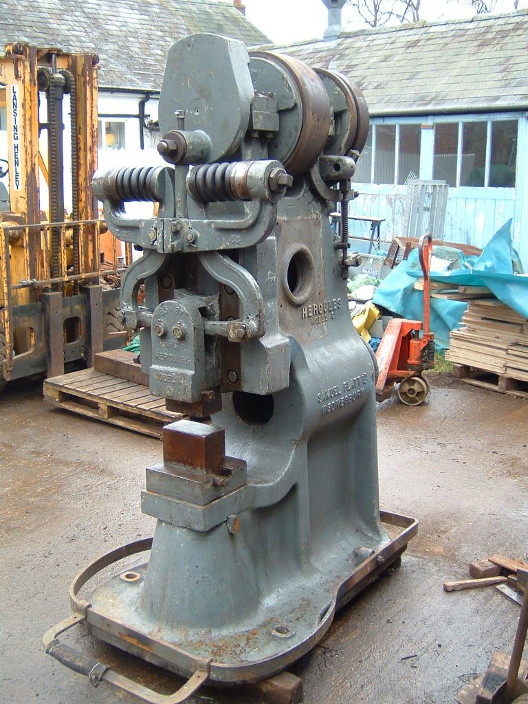

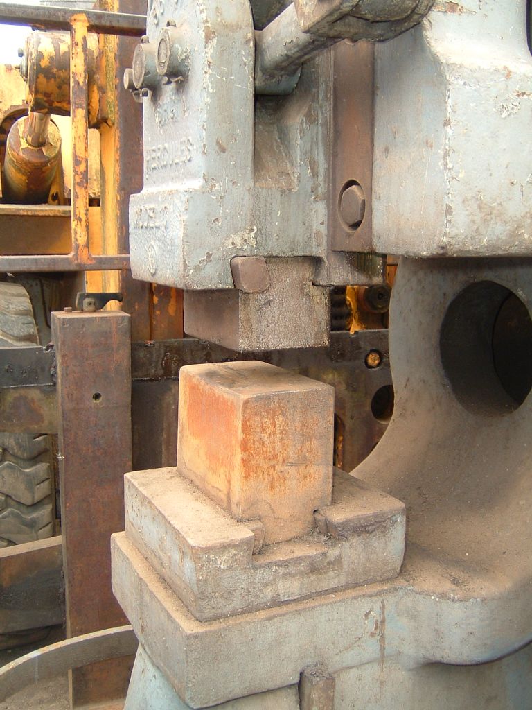

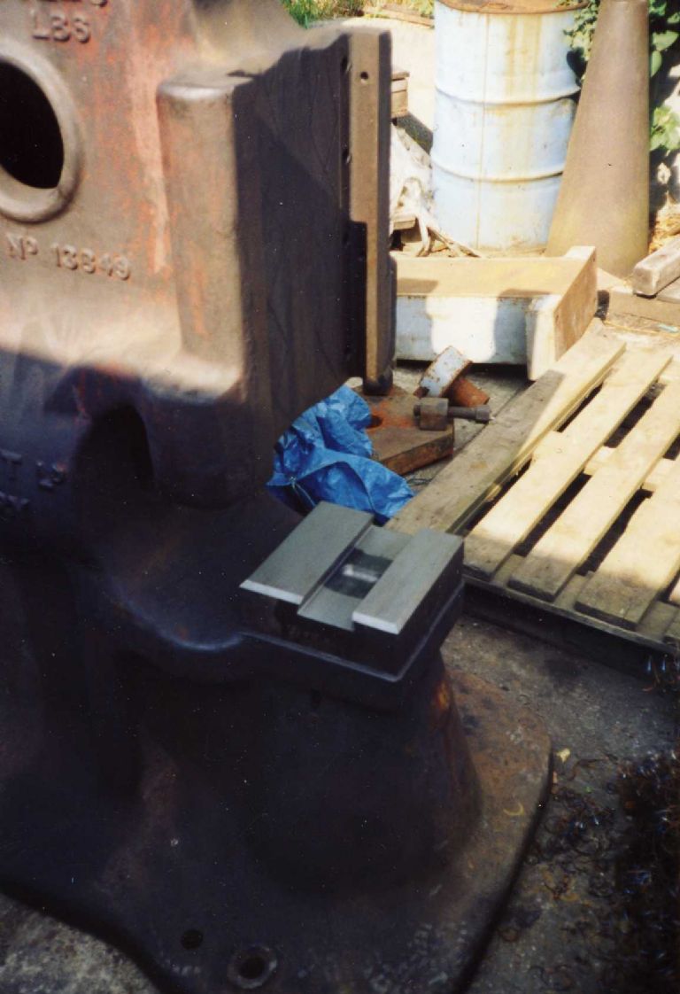

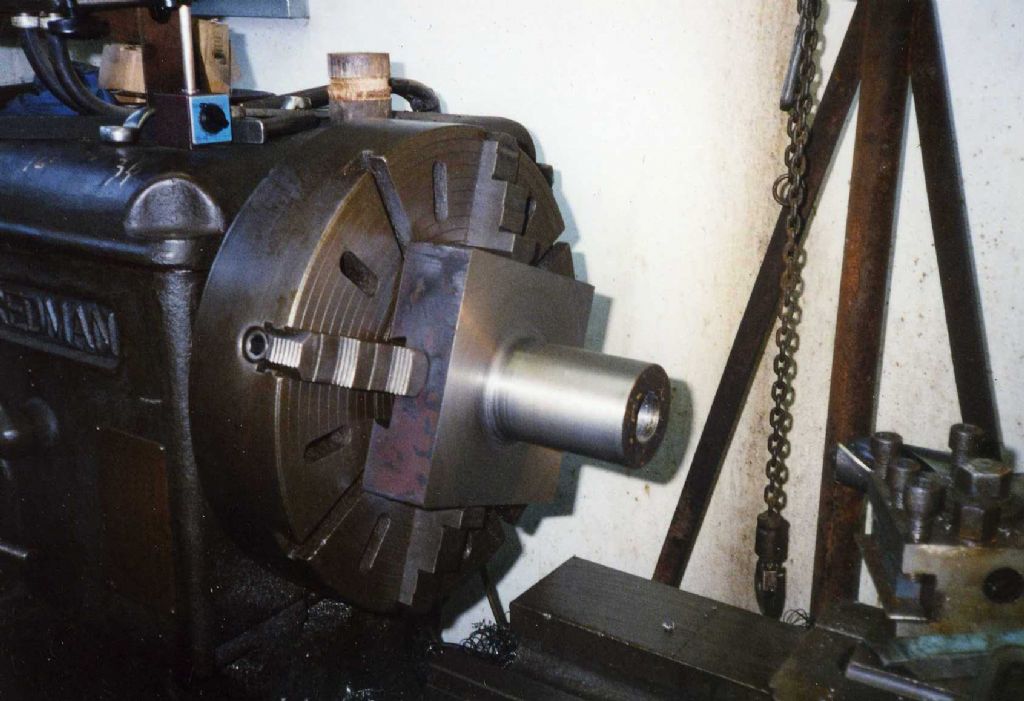

                        If anyone's intertested, here are some pictures of the sort of thing I used to make for the forging hammers,
                        This part is an anvil block for a Samuel Platt " Hercules " 160 lb forging hammer,
                        It started as a 10" square cube of EN8 steel, The dovetails I have formed with the shaper are where the hardened steel die block fits in and is held in place by a fitted key , or wedge,
                        The dovetails taper 1/16" over their length, usually wider on the right hand side.
                        The lathe Is a Churchill Redman, 10ft between centres, that I used to have,
                        The EN8 block was left unhardened, but the die blocks that fitted into it were hardened hot working die steel, 5% Chrome.
                        The last two pictures show how It all fits together, on a similar hammer, made 1946.
                        Richard.

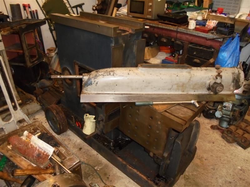

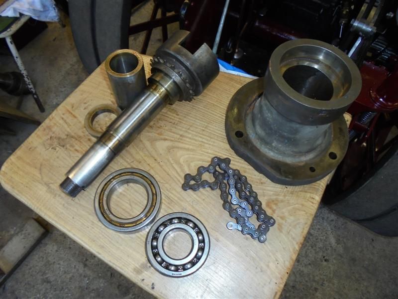

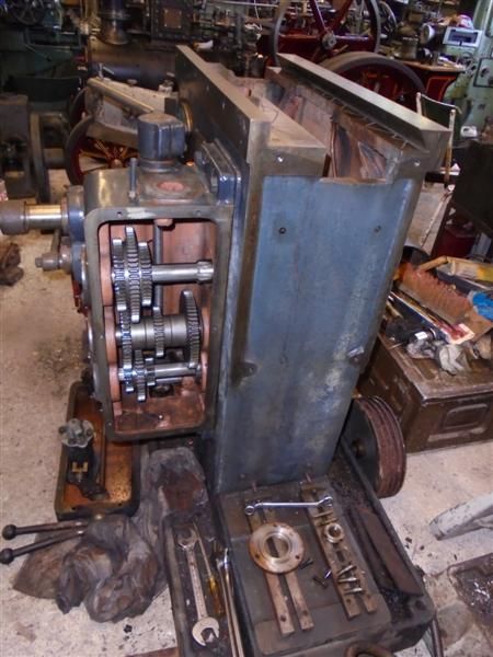

                                          #314850
                                          RICHARD GREEN 2
                                            @richardgreen2

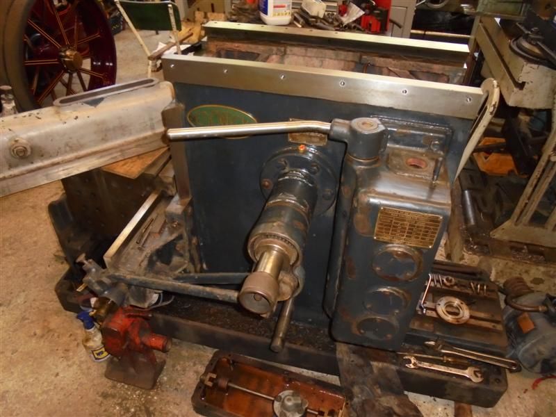

                                            I've finally got the Edgwick shaper into the workshop, what started as a quick clean up , oil change and "get going",
                                            has escalated into almost a major overhaul !
                                            The ram has a few score marks on the slides, so I removed it to scrape off any high spots and generally clean it up,
                                            The inside of the main casting was filthy with old oil , water and general crud, so I removed the "slide arm" from the crank, so I could have better access to clean the innards,
                                            I removed the "crusty" old v-belts that need replacing. Spinning the main drive shaft it was obvious the bearings were noisy,
                                            So removed the main shaft assembly and removed the bearings, one wasn't too bad but the other was very "rattley", so I've ordered two new bearings, a set of 4 new v-belts, and a new chain for the oil pump drive,(should be here next week ).
                                            There are two levers for the gear change, each has three positions located by a detent mechanism, one of the detents was siezed up and would not hold the gear lever in position, so off came the gearbox cover to sort that out,
                                            Good job I did …………….. as the gearbox had about 1 1/2" of oil, water and crud in the bottom.
                                            I think the whole job will be very worthwhile, and make a nice machine when finished, ( a properly made English machine, made by Alfred Herbert of Coventry ),1950s or 1960s it's a pleasure to work on it.
                                            Here are some pictures of things so far……………….

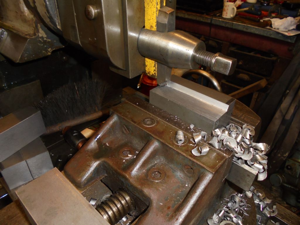

                                                Here's the first real job I've done with the newly rebuilt 20" Edgwick shaper,
                                                Reducing some blocks of 2" square, to make some Dickson type tool holders for my Colchester Student 1800,
                                                The picture shows the shaper doing a 300 thou deep cut, with an 8 thou per stroke feed rate,
                                                25 strokes a minute, going up to 60 strokes a minute on a 10 thou finishing cut.
                                                Stroke length 5 ".
