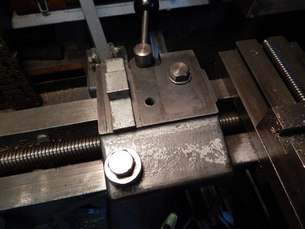

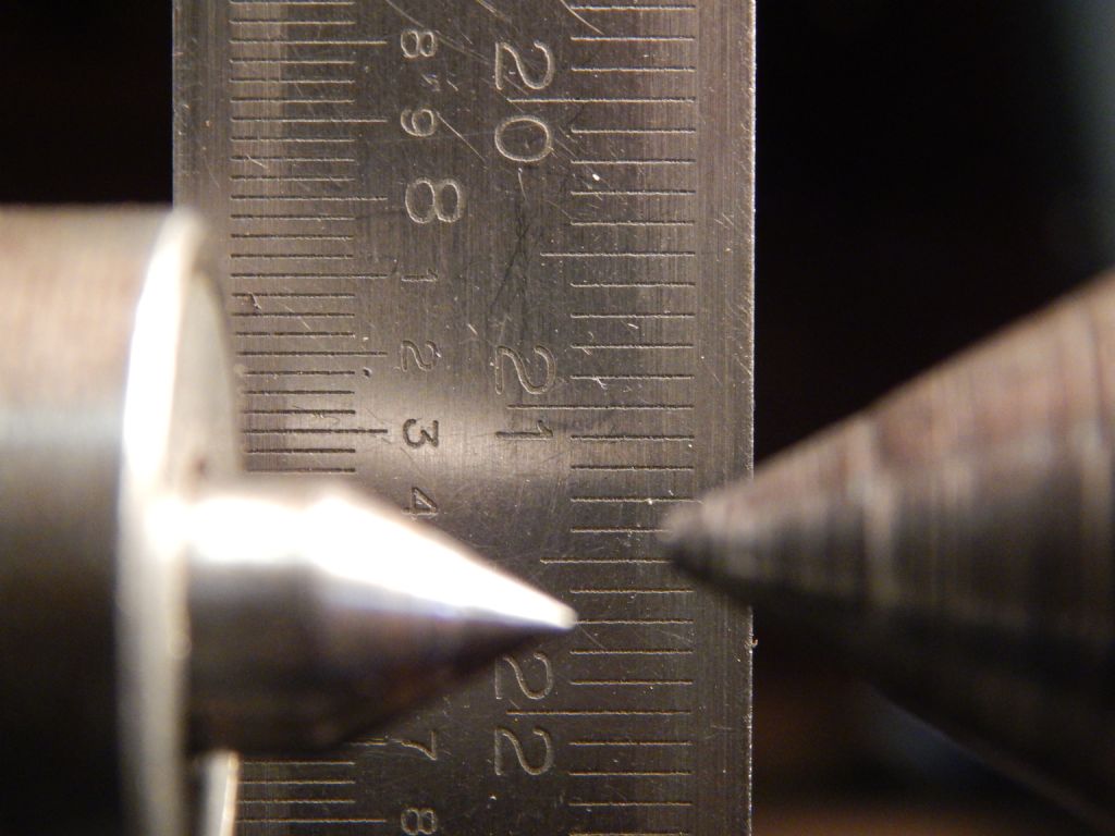

            Posted by Martin Newbold on 21/10/2016 10:43:17:
            Nice work Nobby, have one spare too I had to take it of to fit the tumbler I have.
            Fixed my ML10 mount onto the bottom Drummond saddle not very elegant yet but suffices to take up the distance giving me a new amount .
            Bolted down top part for a proper test in difernece of height
            Now have a smaller amount to remove
            New reading
            That looks suspiciously close to 2.54mm
            #264980
              Posted by Neil Wyatt on 05/11/2016 19:57:36:
              New reading
              … But, unless Martin is using a telecentric lens, it's less.
              #265014
                Posted by Michael Gilligan on 05/11/2016 20:25:49:
                New reading
                I allowed a bit for that, I reckon the apparent 'reading' is about 2.7 but it's not easy to be exact
                N.

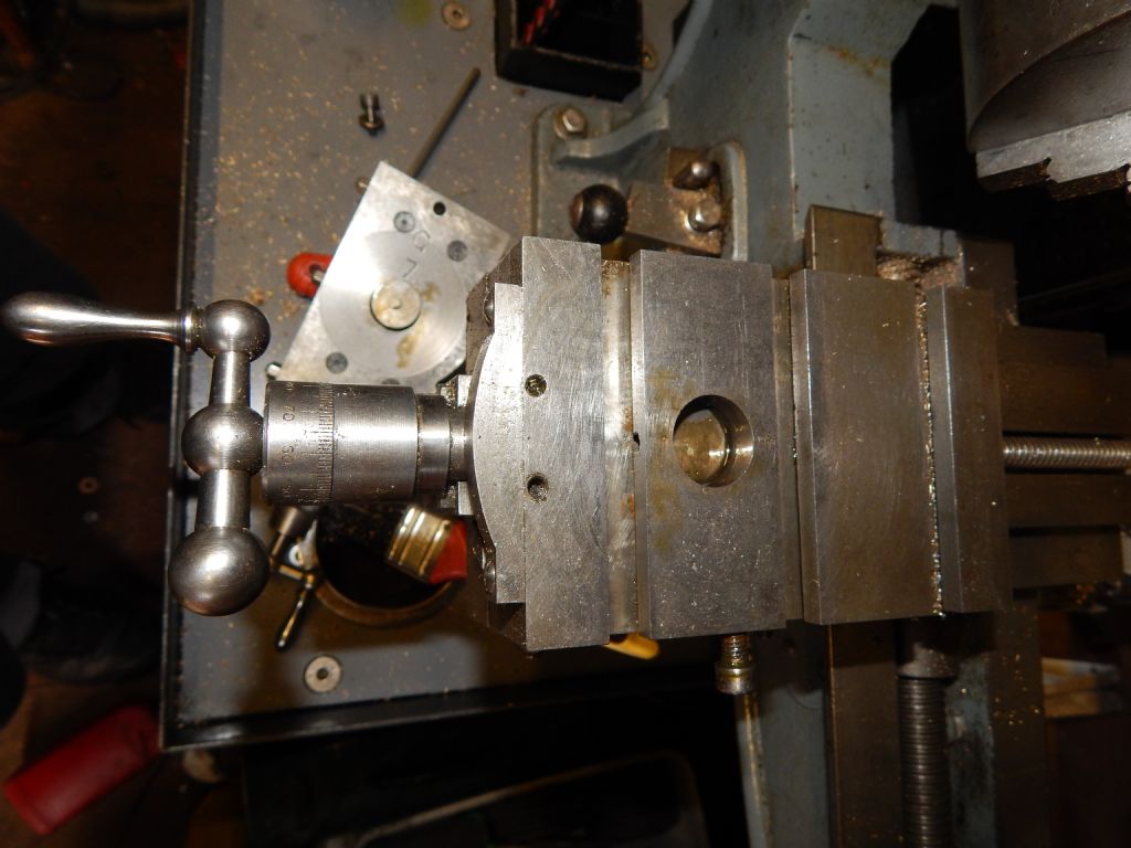

                  Martin Newbold
                    @martinnewbold
                    finished itfinished

                        Has anyone bolted on a travelling steady to their drummond have no idea what type to get or how it bolts to sadle
                        ML7 saddle
                        underneath top slide bottom saddle
