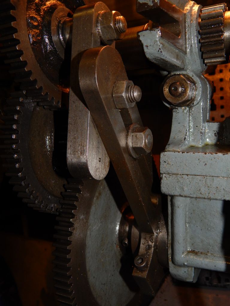

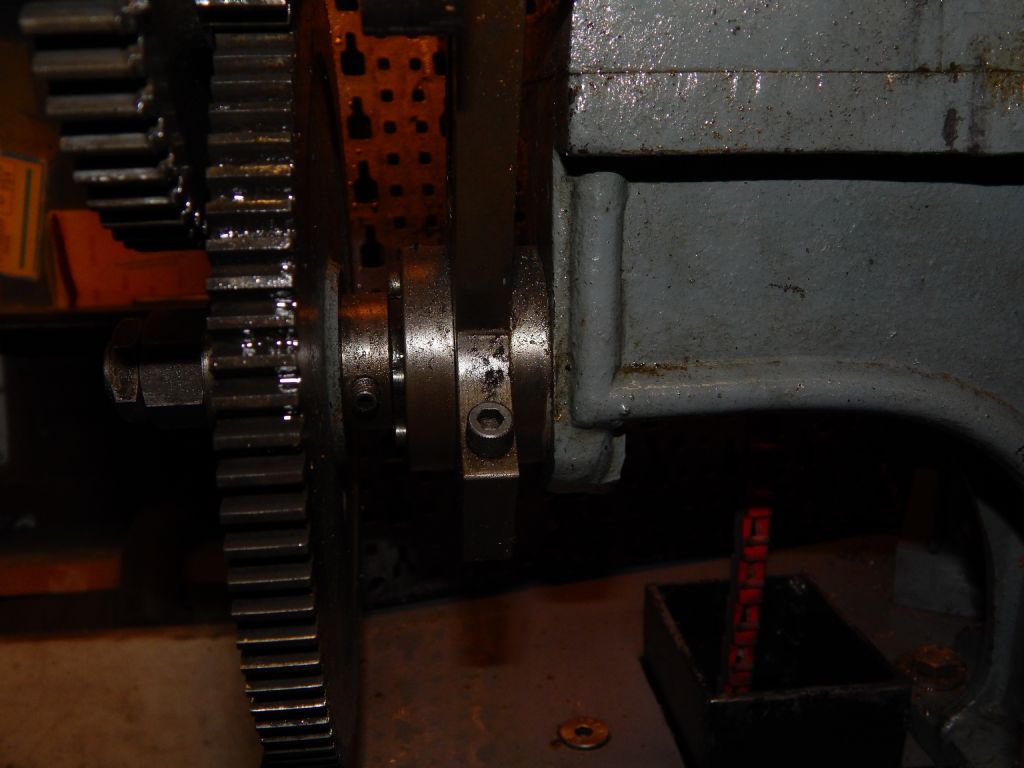

                                                    Hi I added a 3rd arm on my Drummond to get a slower feed Click on my photos  to see the other parts added Nobby
                                                    arm
                                                    Edited By Nobby on 20/10/2016 22:26:50
