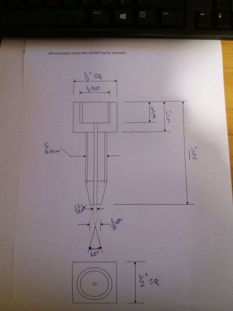

                  David George 1
                    @davidgeorge1
                    There is a drawing in my albums of pinch bolt lubricator with pictures of drip feed oilers if you need any information drop me a message.
                    David
                    Edited By David George 1 on 26/06/2018 08:05:51

                    James Jenkins 1
                      @jamesjenkins1
                      Hi – thanks so much for this. Both mine actually already have these on, so that saves me a job! For a future project I'd love to make a couple of glass vile drip oilers (probably not the correct term – but I suspect you know what I mean!).
