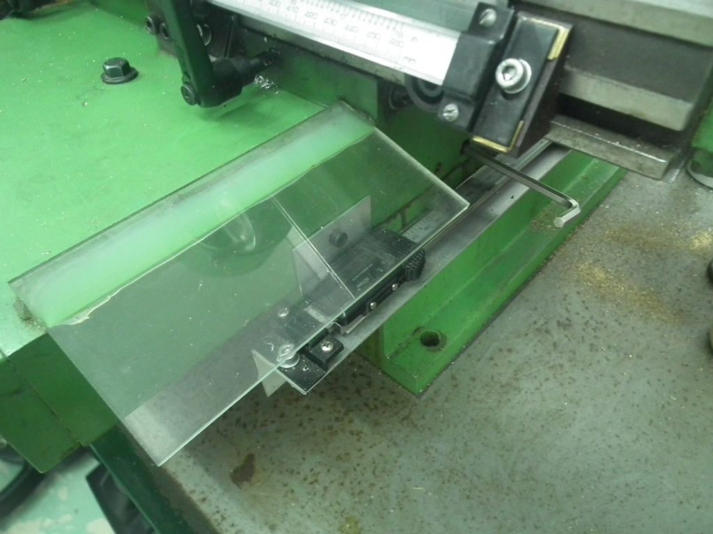

              Russell Eberhardt
                @russelleberhardt48058
                I have the earlier version fitted and have made a shield from angle for the x-axis and from perspex for the y.
                I've just put a couple of pics in my album. Tried to insert them in this post but today it doesn't workfrown
                It's not the best solution but I have only had a problem once in nine years caused by fine brass swarf gettin into one of the scales. That was easily fixed by taking the reader head apart and cleaning the printed circuit board.
                Russell.
                #127563
                Russell Eberhardt
                  Adding prictures from the photo album seems to be working again:
                  An important point with the angle shield is to leave a gap between it and the table edge so that any oil drains behind the scale.
                  Russell.

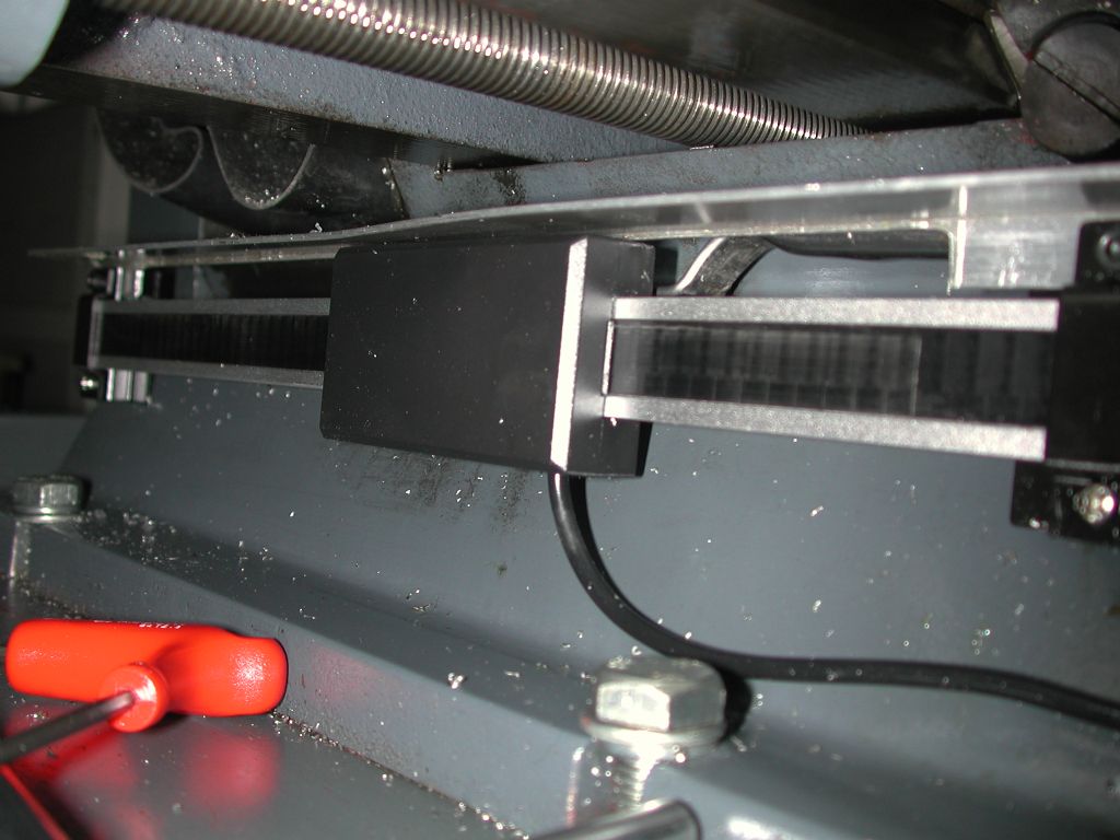

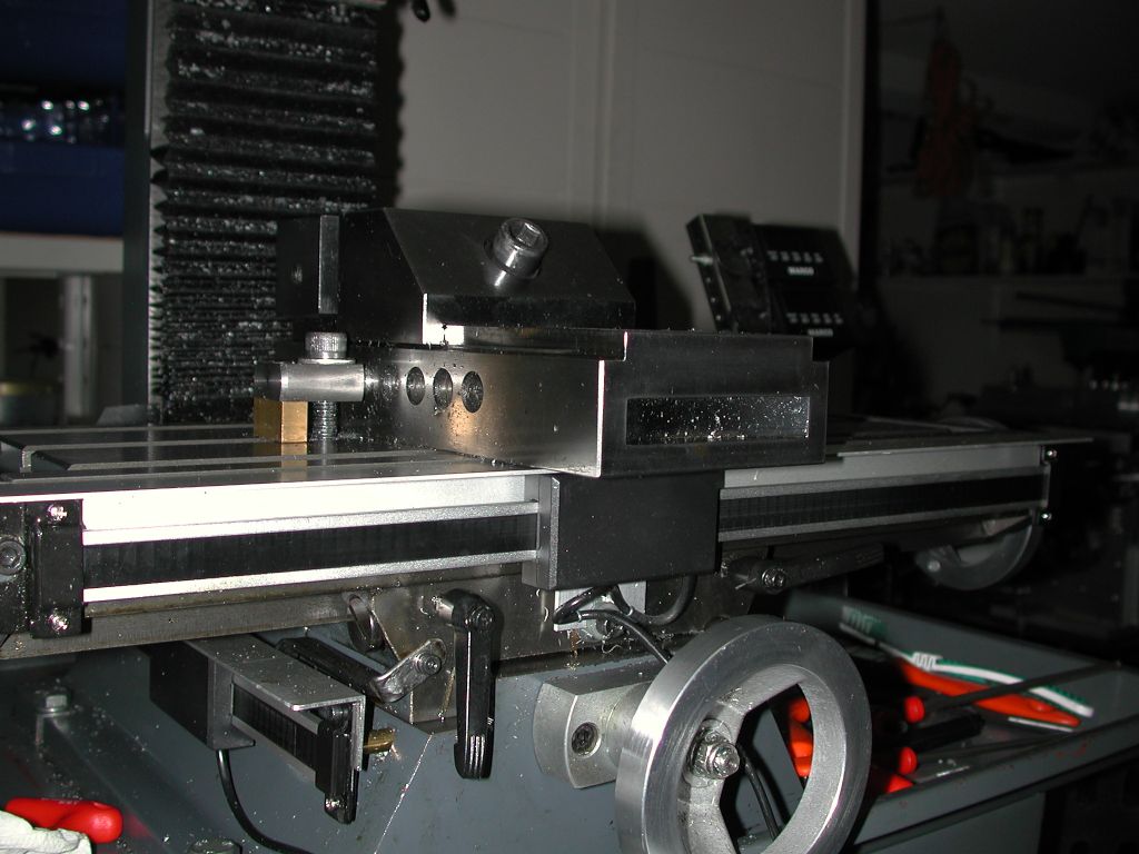

                  #127576
                  dcosta
                    @dcosta
                    Hello Rick,
                    about an hour ago I posted a message with some pictures pasted in and it didn't appear so I'm using the reference method to the picture in an album.
                    In my previous message I told you the aluminium profile was a U shaped. I made a mistake. It is an almost L profile shaped.
                    Also in my previous message I wrote the DRO were bought from ArcEuroTrade. I was wrong as can be seen in the displays. But as much as I know the Warco company doesn't sell this items presently.

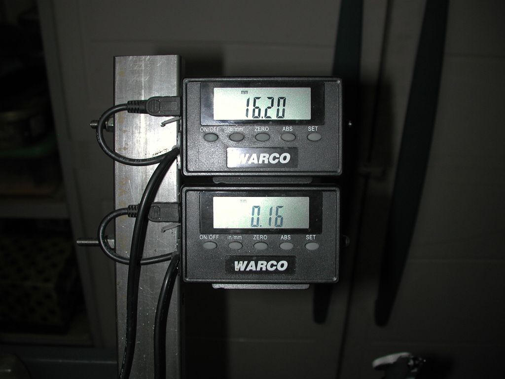

                    I think you can benefit from the observation of the following pictures. X_Axis (and part of Y_axis):dscn4033.jpg
                    Remote display:
                    Hope this is of some help
                    Dias Costa
                    Edited By dcosta on 22/08/2013 15:36:58

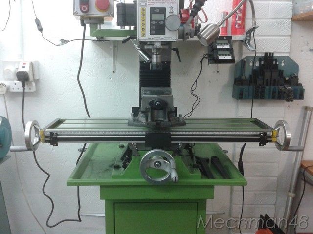

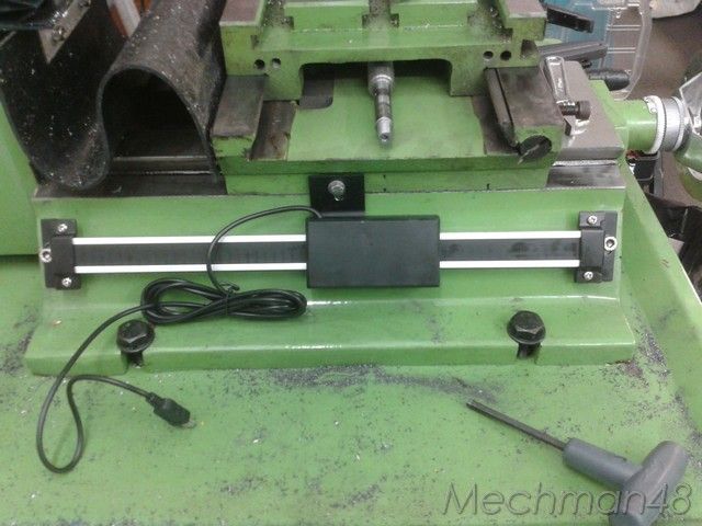

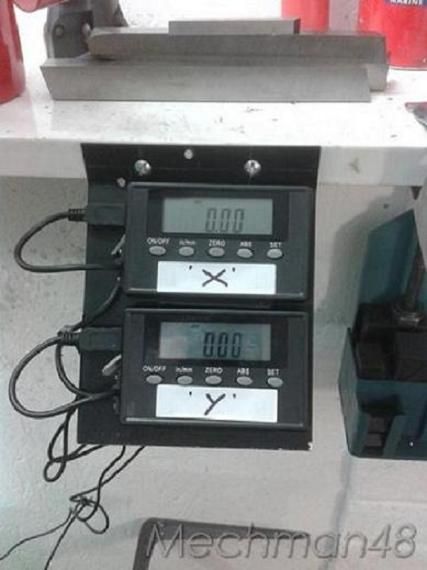

                        mechman48
                          @mechman48
                          Rick>>
                          I have fitted my DRO's the same method as Dias & Russell; they are the same model too, I have photos in my album showing the installation, (I seem to recall a while back that you raised this post before?) but have inserted here for your ref.>>
                          Hmmmm! can't seem to access my album…?> Have had to insert URL.. of screen capture, Just a blank page, no information or album access, is this what the new template does to your postings, if so it's sh1t, can anyone enlighten me?>
                          engineer.co.uk/wp-content/uploads/sites/4/images/member_albums/69121/thumbs/457289.jpg
                          George
                          #127703
                          mechman48
                            @mechman48
                            Hmm! seem to have regained ability to post pics…maybe the gremlins have decided to take pity on me?
                            Y axis fitted..
                            X axis..
                            Remote read outs..
                            X axis protective angle..
                            George.
                            #127708
                            dcosta
                              @dcosta
                              Hello George, good evening.
                              You say in your message that your mount of the DRO is the same as mine. Please look carefully and you'll see there's a difference: in my milling machine I could position the data cable leaving the reader head in the down side (in both DROs) so I get the benefit from the gravity to take some possible oil away instead of letting it try to enter the reader head by some tiny slit.
                              Best regards
                              Dias Costa
                              #127739
                              mechman48
                                @mechman48
                                Hi Dias
                                Ooops! missed that little bit, thanks, but in the same context it is mounted in the same general configuration, will look at turning them 180*… & possibility of mounting the X axis on rear of table but at the moment my extended chip guard is preventing any chips / splashes coming in to contact with the X dro as it ( the guard) sits in the bottom of the front T slot … & it works fine so far. Never the less thanks for the idea.
                                Regards
                                George
