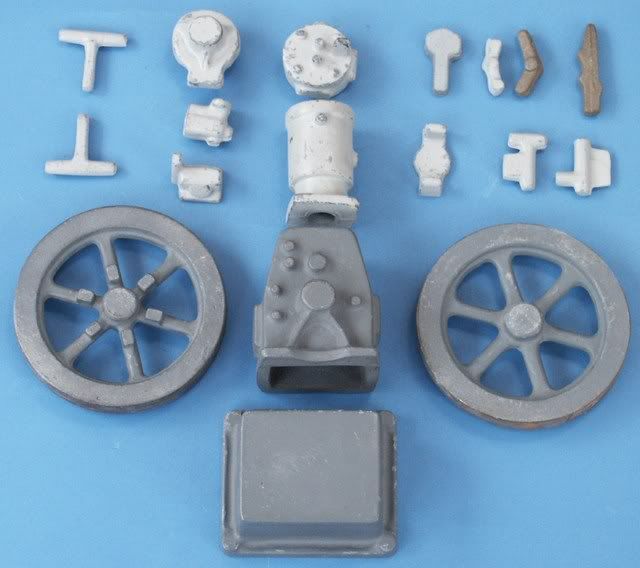

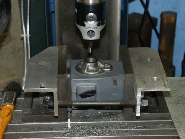

          Well I’ve just fitted the SDS6-V3 to my mill, followed the pictures on the installation guide that came with the unit and clocked the scales with a dti as shown, took about 4hrs to do.
          Initial use suggests its going to be a lot better than the calliper type scales I had before.
          Not had a problem with the manual so far, this is what I tried it out on first, used the 1/2 function to centre the casting and the PCD to layout the holes, then bolted on this casting, holes lined up perfect having been done with Zuez tables using my old scales. Finally flipped the casting over, used 1/2 function again to centre which is a lot easier than working out with a calculator as before and then used the DRO to position the other six holes you can see the bosses for in this picture.
          No problems with the system so far and it will get used all the time on the mill, just looking for a reason to use the other functions
          If you are having a job understanding what some of the functions do have a look at teh videos on DRo Pros site, a few of the buttons may be different but it gives you an idea of how things should work

                The 1/2 function on the mill is not teh same as the one when using the lathe function.
                On the lathe it will read dia or radius, so it will either tell you you have say 0.100″ to take off the dia or 0.050″ off the radius depending on what you prefer working with and what your handwheels are calibrated to.
                On the mill its used to find the mid point between two other points. For the casting I showed above I used an electronic edge finder on one side, zeroed the Y axis then moved to the other face and when it touch it read something like 2.700″, then hit the 1/2 button and the Y will read 1.350″, feed back until it reads 0.000 and you will be central between the two edges or leave it where it is and you are 1.350″ from the centre.
