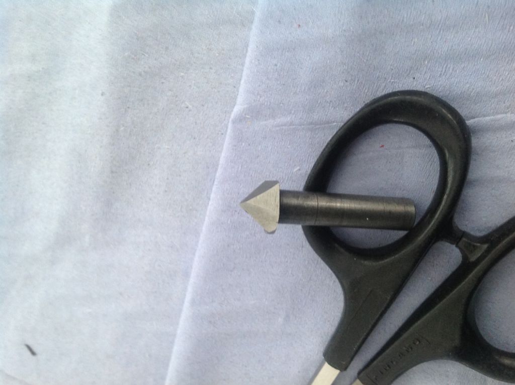

                                    MalcB
                                      @malcb52554
                                      When spotting for tiny holes I use a very pointed D bit I made quite a few years ago, relieved on the back of the taper.
                                      Drill Speeds already covered by others
