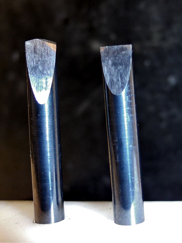

                      Roy M
                        @roym
                        I have successfully drilled through tool steel and taps with an easy to make drill made from
                        either a broken carbide tool or round carbide toolbit . If there is any interest , I will post a sketch.
                        Roy.

                                              Roy M
                                                @roym
                                                I have photos and short video clip showing how to make a drill and drill thro' tool steel.
                                                just trying to figure out how to post them. (guidance appreciated)
                                                Roy M
                                                #163913

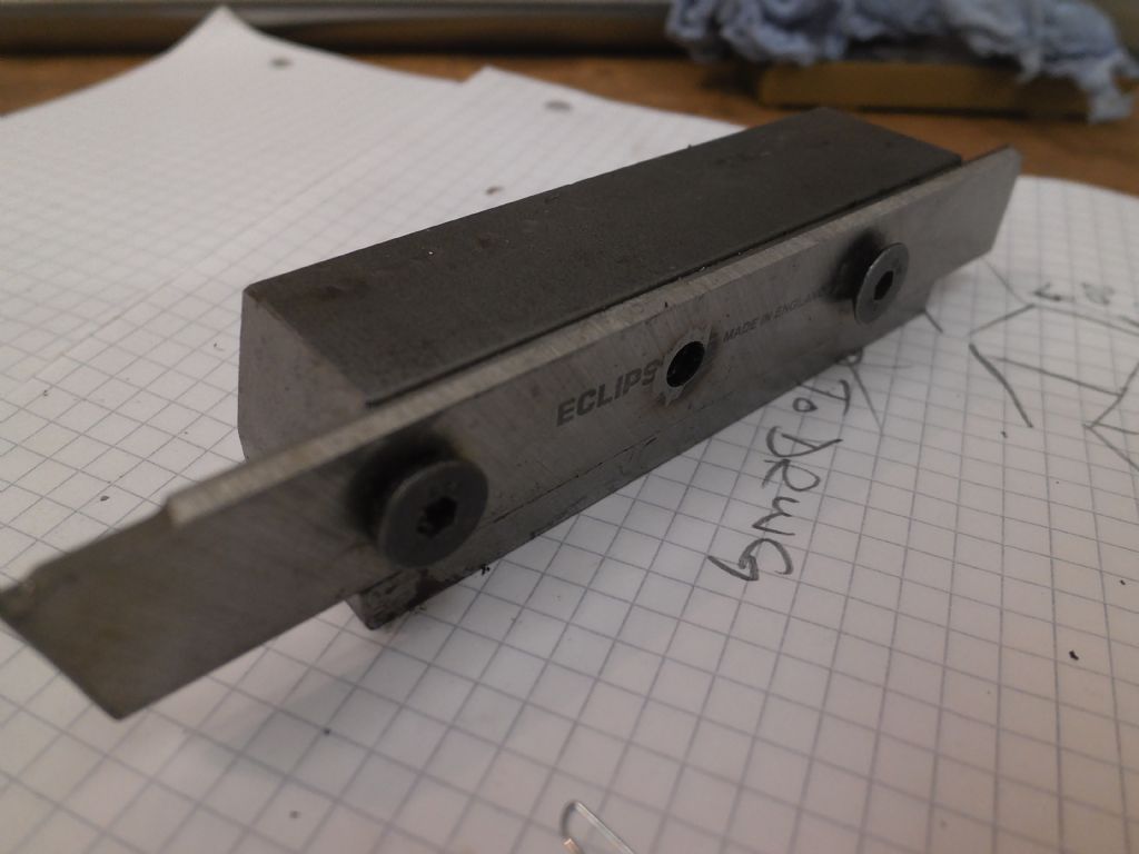

                                                Roy M
                                                  @roym
                                                  part off blade holderhole drilledcarbide bit
                                                  Edited By Roy M on 18/09/2014 23:52:02
                                                  #163914
                                                  Roy M
                                                    @roym
                                                    Off hand ground carbide drill for drilling 62 Rc and hard stainless.(1st and 2nd stages of grinding shown)
                                                    Showing hole drilled today, and a simple part off blade holder made some time ago.
                                                    Run at 2500 -3000 rpm and push hard, be brave, you can trust me I'm an engineer!
