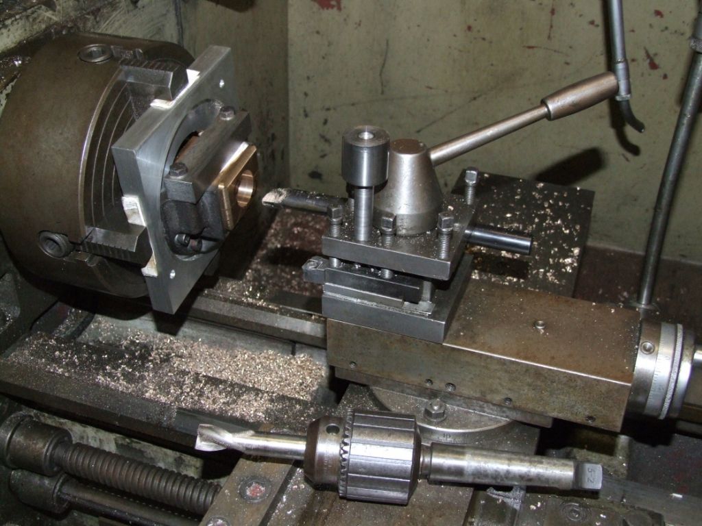

          First a few comments. I do have small boring bars, but it’s a whole load quicker to drill out material rather than use a small boring bar. Second, the bearings are a bit over 2″ thick, so I suspect my small boring bar, at 8mm diameter, would have chattered more than a Hampstead resident.
          Terry: I did consider a D bit, but I’d have to make it, and I’m impatient!
          In the end I found a slot drill in my tool store with relatively short flutes but a long shank, and where the flutes are larger than the shank. Put it in the drill chuck in the tailstock and it went through easy-peasy. I then bored to size using a 20mm boring bar. Just as well I checked the drawings first as the bore is 1.125″, not the 1.25″ I originally quoted. Here’s a picture of the set up, with the bore finished:
          The slot drill used is sitting at the front on the cross slide, and the ground to size gauge used to measure the hole is perched vertically on the toolpost.
          I can’t believe how easily it all went, after the travails of last night. Thanks to all those who made helpful suggestions, and especially to David, Michael and mgj for the slot drill discussion.

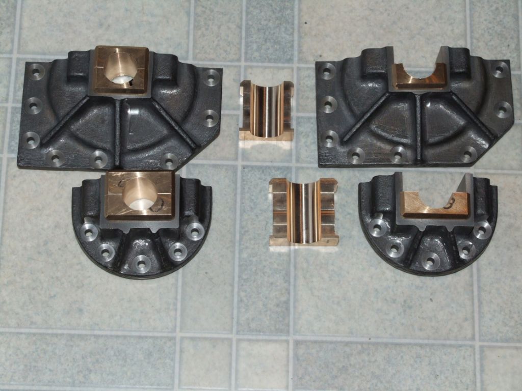

                    Anyway, moving swiftly on, I’ve finished the gunmetal bearings:
                    Thanks everyone for your help.

                            Hi Andrew Johnston,
                            Looking @ the piccy in your posting 1st Feb @ 22.42, the 2 big castings both appear alike but if as I think, they are Traction Engine shaft bearings, shouldn`t they be handed?
                            Have looked back thro` all prev. posts on this thread and cannot see any mention of their use, so what are they for?

                              Hi John,
                              In my first post I mentioned ‘traction engines’; so you are correct that they are the crankshaft bearings for a traction engine. But also note the plural; I’m building two identical engines. In the picture there are two sets of bearings; each engine uses one large and one small casting. The small (round) castings go on the outside of the lefthand hornplate. The large (rectangular) castings go on the inside of the righthand hornplate. And if I’ really lucky the bearings will line up!
                              Regards,
                              Andrew
