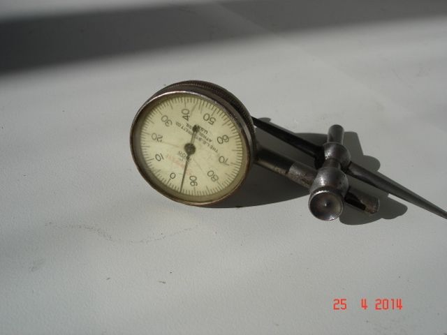

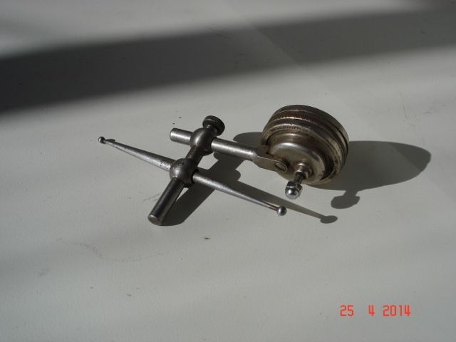

                                              #237468
                                              Ian S C
                                                @iansc
                                                I found the straight fluted drills at the NZ Railway workshops in Christchurch (NZ) back in the mid1980s at an auction, where they were selling all the tools and other gear, got to my limit, and someone else got them for about another $10, they went for about $60, for 100 drills from 1 1/2" down to 1/16", and 50 D bits of various sizes. One thing I did find in a rubbish bin.
                                                Edited By Ian S C on 04/05/2016 11:13:24
