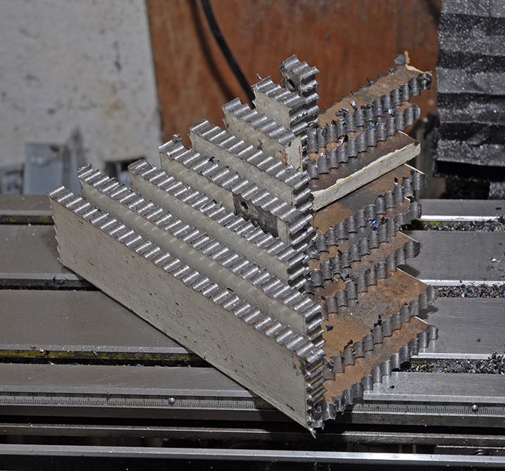

          I'm fed up too. I've been chain-drilling angle all day today (100x100x10mm), plus milling the edges. Not quite the info you need but I just used a normal HSS bit in the mill. A drop of oil helps a lot although I did this lot dry with one 7.4mm drill (it was within reach), about 700 to 800 RPM.

                Hi Ed – I have to ask – why??

                          Hi Fizzy,
                          It's for a box pan folder, more photos and a half rendered concept in one of my albums.
                          Other than a hacksaw or endmill it's the only way I have to cut large pieces of metal. A power hacksaw is high on the todo list.
                          Ed.

                            Posted by fizzy on 18/06/2016 20:28:21:
                            I agree! It looks like a metallic modern art take on the stepped pyramid of chitchen itza!

                                  – £10 jigsaw would have done it very quickly though
