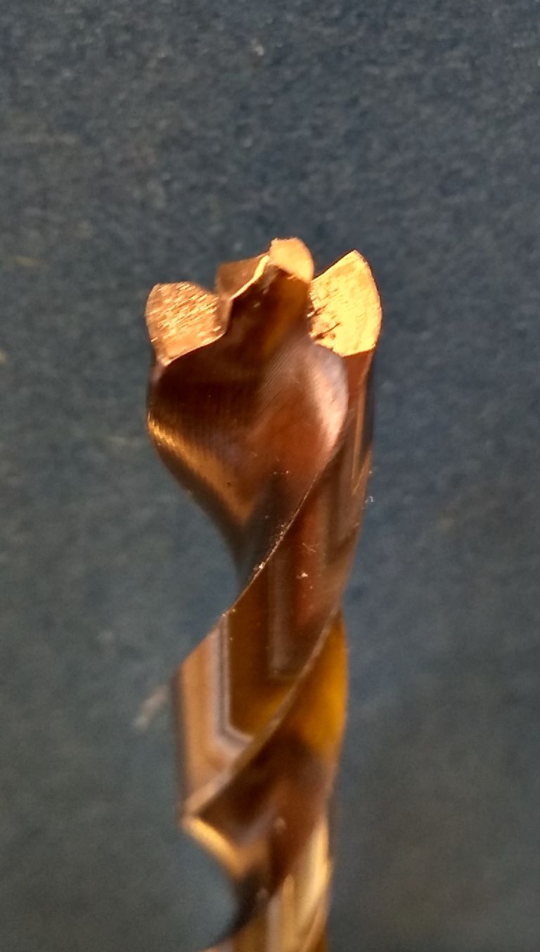

            It's a lot simpler than that. Stone the tips of the cutting lips round and the flutes will close slightly. Sufficient to not be able to get the shank of the drill into the finished hole.

                I've previously mentioned these "pilot point" drills, which have a central split-point pilot and something like a slot drill behind. I git my first set years back branded B&D, and a more recent set Elu. I find them excellent, they don't need a pilot hole (in fact it's positively bad), don't wander, and drill very close to nominal size.

                  I'd guess the pilot points will work well so long as they're held with good concentricity – but if the piloted part runs out, I would think it'll cut oversize and allow the full diameter lip to dig in slightly and flex the drill, with similar results to an asymmetrically ground jobber drill.
                  The impression I have is that the key bit of the game in drilling is to get the cylindrical land correctly supported in a hole of the correct size, and if the point is in any way suspect, make sure the projecting part of the drill is as short and as stiff as it can be, and feed the initial penetration slowly enough to take out most or all asymmetric flex and spring. You'll be able to see from the swarf if one lip is doing all the cutting, and once full diameter penetrates, you can generally see if there's more clearance around the drill than the cylindrical land can account for.

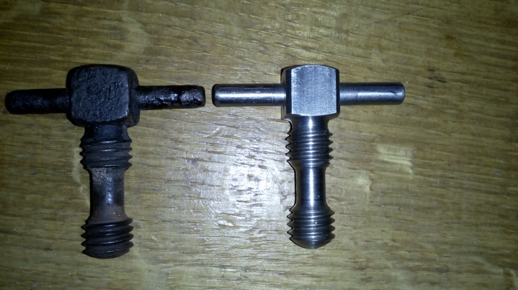

                            Today I made a 1/2" BSW screw with a 9/16" square top and a 1/4" crosspin for hand-operation. I centred and drilled the crosshole 6,0 mm, then followed up with a little-used 1/4" Dormer as a Dagenham Reamer.
                            The cross pin was 1/4"" silver steel, miking up as about .2499/.2500" on a Mitutoyo Vernier mic.
                            I still had to turn the crosspin down to .2490" in order to bash it into the 'ole with a Thorex 712, and I don't think it'll fall out any time soon.
                            Edited By Mick B1 on 25/04/2021 16:19:42
