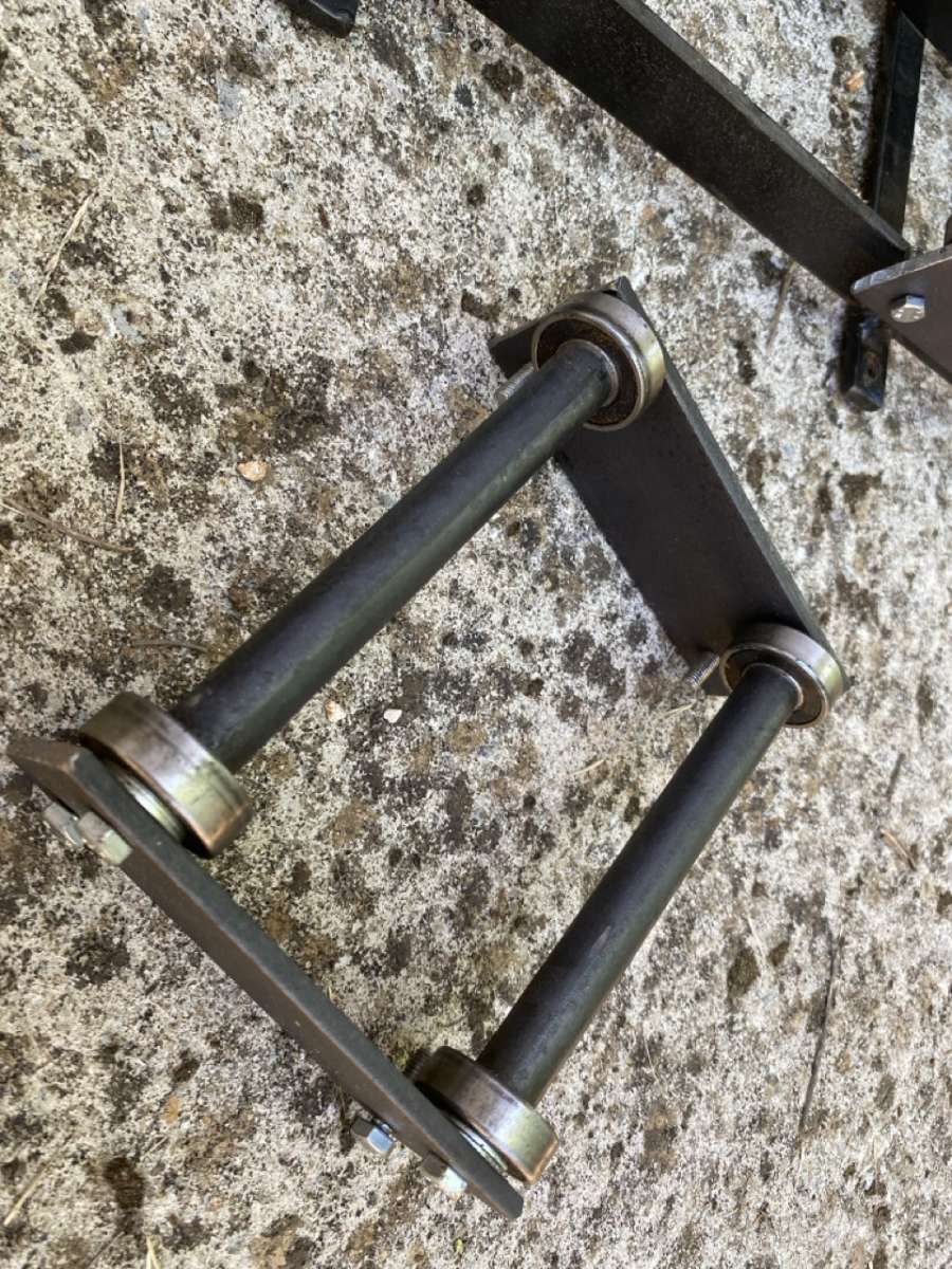

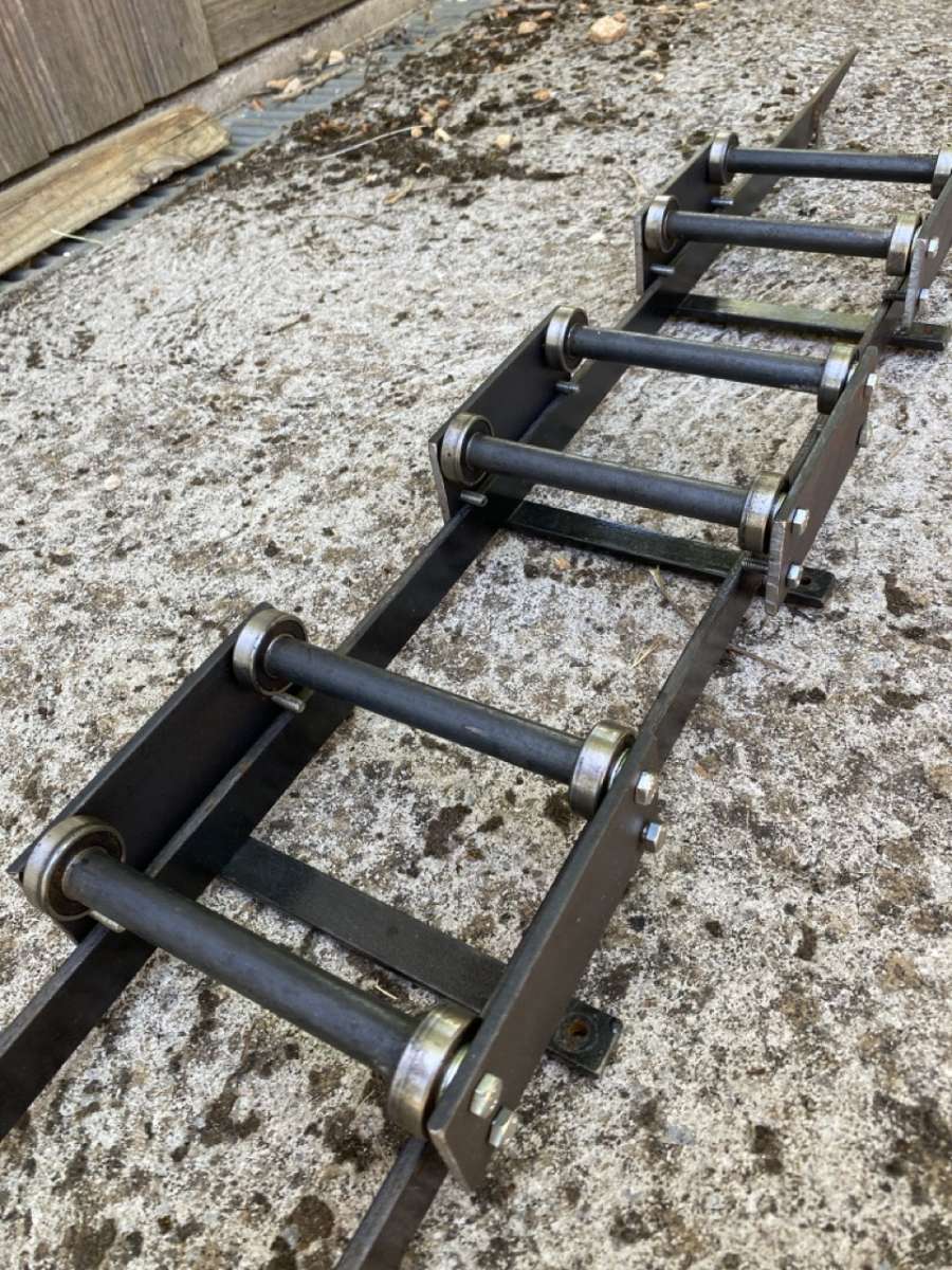

        Speedy Builder5
          @speedybuilder5
          These are what I knocked up for a  5″  0-6-0.  The rollers are 1.25″ diameter and spaced so that they bear on the wheel “tyre” and have about 1/16″ clearance on the flange.  The side plates (Which rest on the sleepers) should be deeper so the rollers clear the rail head but these were made for my transporting frame where the rail is 15mm angle.  The lower bolts can be used to align the three sets of rollers but are free to slide longitudinally.

          #807445
          Greensands
            @greensands
            The above designs for a rolling road work well for the smaller, lighter moðlels where the loco can be lifted on̈ to and off the rollers but present problems with the larger units. What I am looking for is a design of rolling road which would allow the loco to be pushed onto the rollers via a length of transfer track without any need for lifting. I fear however any such design would be quite complicated to make up. Interested however to see what might be out there.

              #807448
              Greensands
                @greensands
                Speedybuilder5    I think I may have misinterpreted your photos. Am I right in assuming that your design does permit the loco to roll onto an off the rollers?  If so, please accept my apologies.
                #807454
                bernard towers
                  @bernardtowers37738
                  How can it be possible for the loco to roll onto the rollers as they are considerably higher than the track the loco is on??. surely you would need a set of rollers that could be jacked up after the loco is rolled over but i still fail to see how you roll a loco over the gaps in the rail where the rollers are situated.
