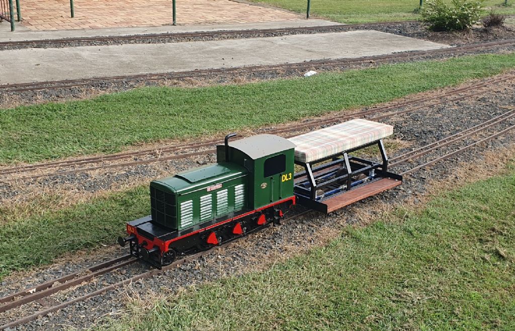

      20220423_151108.jpgFinally close to completing my 5" gauge petrol loco modelled after Queensland Railways DL class. Been a long process with lots of new things to learn but with several successful tracks tests the beast is now 95% complete. Have added a headlight and cooling fan since photos were taken, still need to add a few cosmetic items but they are jobs for another day. Pulls me quite happily at a decent speed, could probably pull 2-3 adults but not tested that yet. Now on to the next project, hope it doesn't take as long as this one!20220423_151052-r.jpg

              Roger B, engine is 25cc 2-stroke out of a line trimmer positioned longitudinally, repositioned the carby and made a custom exhaust to fit inside the hood, retained the centrifugal clutch then 2.5:1 reduction chain drive to a drive shaft leading to an angle grinder gearbox to drive the wheels. With the custom exhaust it doesn't sound much like a line trimmer. The exhaust actually discharges through the exhaust pipe you can see in the picture, which is able to be rotated 90 degrees so it doesn't blow in my face when driving. Tried making a forward/reverse gearbox but did not work reliably so that's an upgrade project for another time.

                  Just an update, I have successfully run it several times now for extended periods with no problems other than an occasional lack of traction particularly on wet track. It’s only a light-weight loco so that I can carry it unaided between car and track when necessary. A bit of hand pressure on the cab roof usually helps it ‘find its feet’ again.
                  It will happily pull my 85kg body on a 2-axle riding car, plus my two grand-daughters and their mum on a separate bogie riding car, but that would be close to the limit of it’s capacity with the current gearing and weight. More weight and lower gearing would increase hauling capacity considerably but would take away most of the fun of driving it.

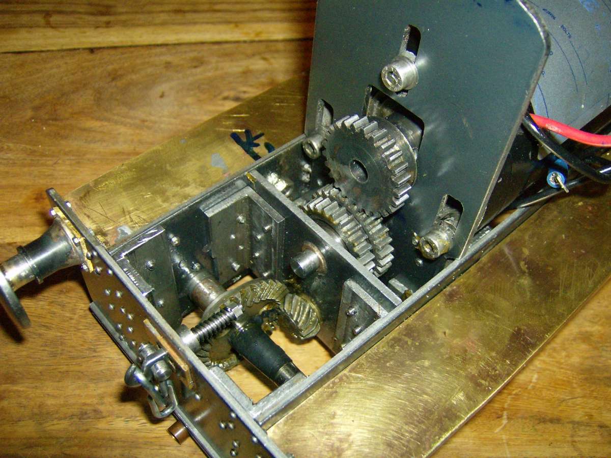

                        Replacement angle grinder gears are a ridiculously cheap source of step down helical bevel gear pairs.
                        I used one on my own loco.
