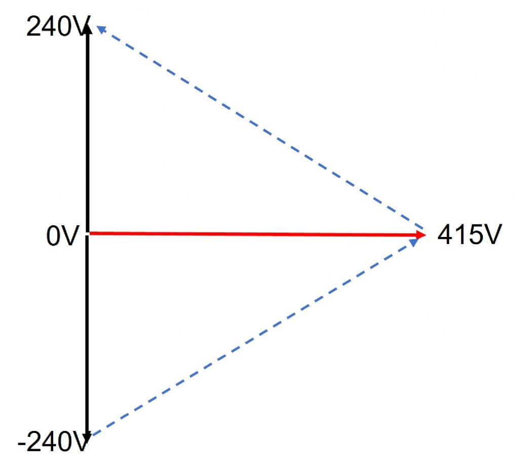

                          OK, reading the paper and thinking about this a bit more the operating principle is explained in this phasor diagram.
                          Here the + and -240 volt phasors are the two legs of the centre tapped mains supply (all voltages are given in RMS though strictly they should be peak). The + and – terminals of the supply become two of the phase voltages, the phase-phase voltage being 480V.
                          What the unit mainly does is via some clever power switching electronics generate a third voltage in quadrature with both and a voltage level of 415V which feeds the third phase terminal. This becomes the third phase.
                          If you now look at the phase-phase voltages and angles, they are all 480V rms and mutually at 60*, that is a true balanced 3-phase supply. Note that there is an implied "neutral" which is not at the same potential as the mains input "neutral", so you would need to be careful using the supply to machines that needed earthing for safety. This could be fixed by using a 3-phase isolating transformer with a star secondary where the star point is used as a neutral (and could be connected to mains neutral and PME).
                          It ought to be obvious that the phase and amplitude balance depends on controlling the generation of the 415V auxiliary signal to be at the right level and exact quadrature, but for a DSP this is trivial at 50/60Hz. There is no reason why the system should not generate 3 phase as accurate as a conventional VFD, with the benefit that only one power output stage is needed.
                          The actual product, if as described in the paper, has some switched capacitor trickery to save components in the power amplifier but I think essentially follows this operating principle. I think it's rather neat!

                            One might ask of course, why doesn't a conventional VFD work this way? The answer is that the system only works at the mains frequency so motor speed can't be varied.

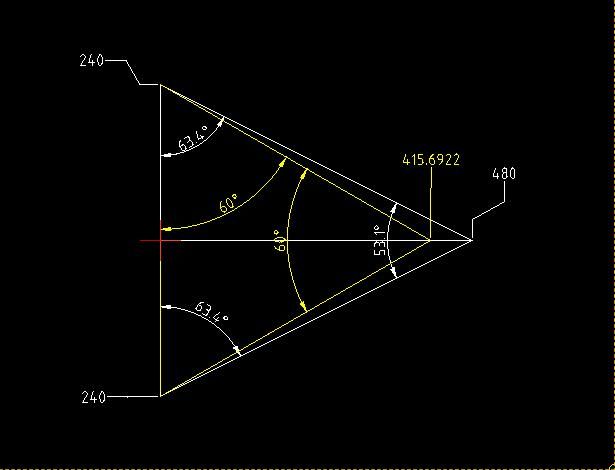

                              I'm struggling to understand, but might be nearly there! My version of John's diagram:
                              If the rightmost point of the triangle were at 480V (twice 240V), the phase angles would be two at 63.5° and one 53.1°, which is much better than an idler motor or static converter could do. The volts are balanced, but the phases are up to 6.9° out. However, if the unit reduces the output (rightmost) to 415V, as John's diagram, the phases are all balanced, at the cost of a slight voltage imbalance, also better than an idler motor or static converter.
                              Presumably the electronics could adjust the generated phase anywhere between 415 and 480V to improve either phase balance, or voltage, but not both. For example 447.8V gives two 480V phases at 61.8° and one 447.8V phase at 56.4°
                              Is that right? Doesn't seem to be covered in my manual:

                                I don't think it is! To get the value of the quadrature voltage, suppose it is V while the phase-phase voltage is 480V. Then you have a right-angled triangle with hypotenuse 480, one right-angle leg 240, while the other is V, and the angle at the upper vertex is 60*. Then the value of V must be sqrt(3) x 240 = 415.69. Voltages and phases are all correct. If the voltage was 480 as in your first assumption, then the second two phase-phase voltages would be greater than 480.

                                  I agree with John.
                                  Did a bit more thinking about it and I think if the phase to phase voltage of the existing split phase supply is 480v, the generated voltage is 416 with respect to the existing neutral.
                                  The only thing I would say is that if Robert goes down this route, the star point of his proposed delta/star transformer (ie the neutral for his 3 phase output) should be earthed separately and not connected to the existing supply neutral.
