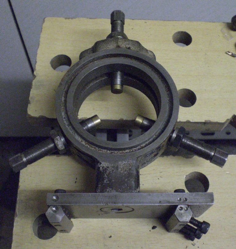

                            I’ve just made a simple ,and very rough, steady to allow me to face a flange on the end of a 4″ dia tube. Piece of black bar 1″ x 1/2″, bent round a former, bent cold. Welded to bit of 2″ x 1/2″ for a base, with clamp screw hole to take original bolt. Drill and tap M10 in 3 places. Make brass end caps for M10 bolts. For heavier use will weld extra stiffening. This is not brilliant but does the job.
                            #63406
                            Nicholas Farr
                              @nicholasfarr14254
                              Hi, how about this steady which I cobbled together many moons ago to fit my late fathers RandA lathe. It has at least two different steels, a mallable cast butterfly vavle carcus, and a bit of brass. Apart from the HT socket head screws, (which were just available), I’ve no real idea of what the specs for the different metals are.
                              It works fine, only downside, I have to fit it to the lathe at the same time as the piece that is being steadyed, but hey, there was no cost for the materials, just pretty please to my departmental head at the time.
                              Regards Nick.
                              Edited By Nicholas Farr on 01/02/2011 18:58:08
