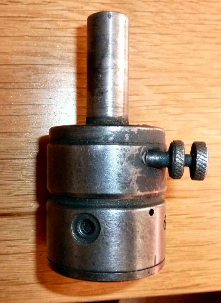

        p1020389.jpgp1020388.jpgHi all would welcome some advice picked up a couple of small die heads the other day along with a few chasers (hope thats what there are called). So looking at the end on photo there is the knurled screw then lookinginto the small grove in the end plate there is a small screw what is the function of these two item ? Also there are three very small holes two in the front part and one in the back plate I am assuming these are for a drop of oil ?. Would welcome your comments, advice or links to info please.
        cheers H

          Had another quick look at die head found that in the grove there is a short set of division marks with a circled +/- either end. The the – can just be seen in the second photo to the right of the threaded hole.
          Cheers H
          #148395
          daveb
            @daveb17630
            The knurled screw adjusts the thread diameter, 0=nominal, + & – = over and undersize. My backplates have a little movement built in, I assume this is to allow the device to centralise. I believe the small holes are for oil.

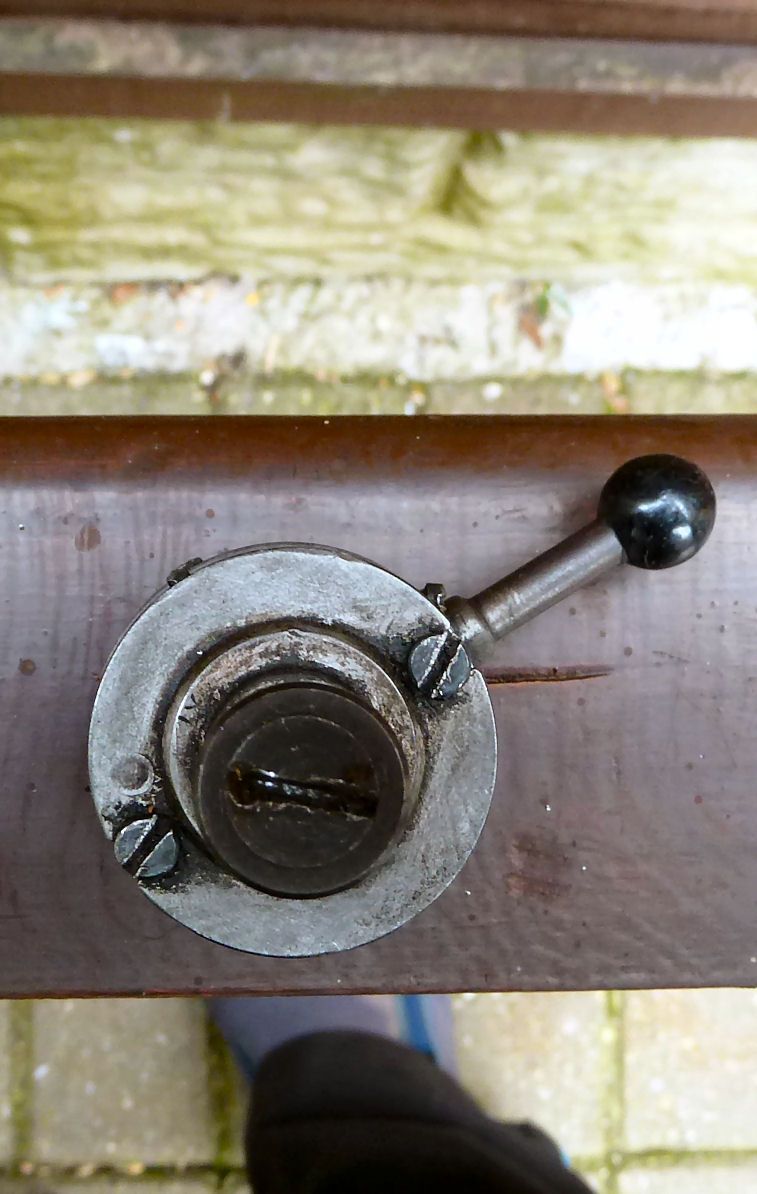

              In your second photo, it looks as though the screw is damaged – is that a camera angle problem?

                  The device is definitely a Coventry diehead, quite an old CH style. Given that the front screws need to be completely removed before the front plate can be removed to change the dies it is probably a 1/4" diehead. It is missing at least one part. In the second picture, next to the minus sign, there should be a short handle to aid in closing the diehead before operation.

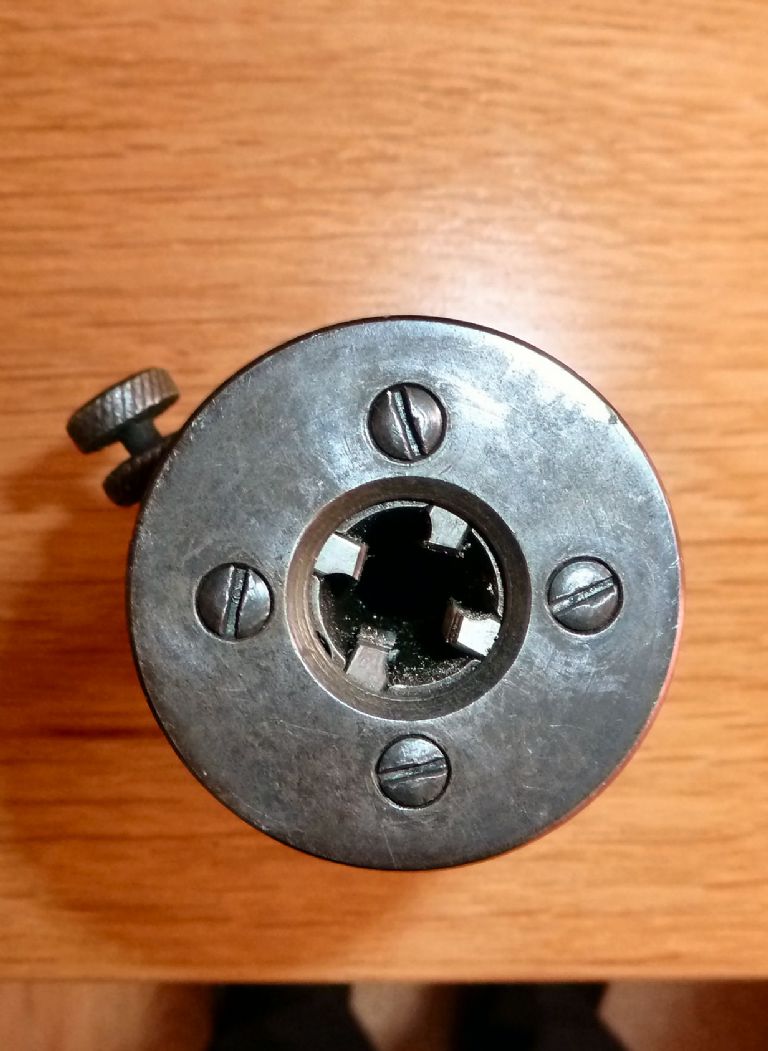

                    Many thanks for all replies, still would be interested in knowing the purpose of the small screw located in the slot in the back plate (photo 3 left hand side) .
                    Swarf, Mostly! I assume you are referring to the knurled screw will check it out, having only taken a quick look the knurled screw looks to be a screw with a screw !

                      You should find that the body is in two parts and they are spring loaded when set by the missing lever. When you stop the feed of the turret or tailstock the die will continue to feed for about 1/8th in then release the cutters, when the whole assembly can be withdrawn immediately. The divisions on the adjustment should be in 1000ths of an inch. Male threads are usually a few thou.down on nominal size so do not make the thread full size. A 6BA thread nominal size is 110 thou. but usually only measures 106 thou. However – check with a nut for a good fit..

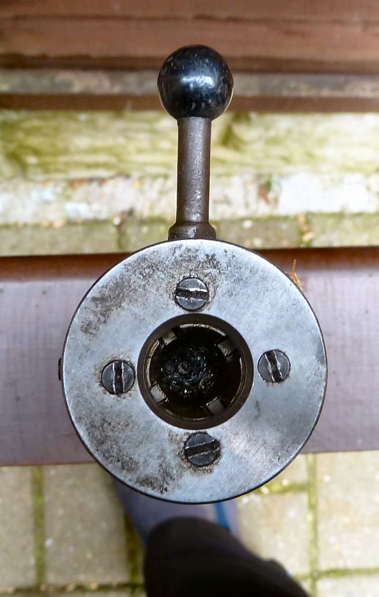

                                  Managed to crab a few pic's of the other die head that I acquired it's smaller and slightly different from the other, the adjuster and the back plate which is spring loaded also the bore is closed. I have also added a pic of the two sizes of die's that were included
                                  #148539
                                  Anonymous

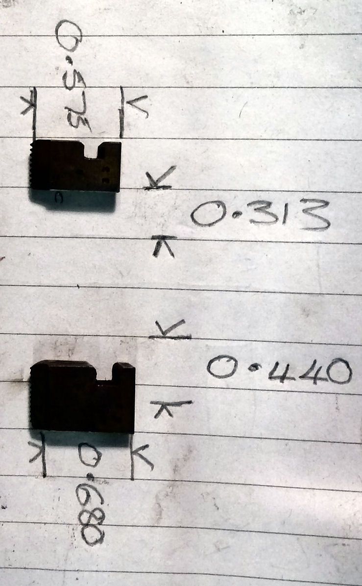

                                    Definitely a very well used 1/4" die head. The smaller of the chasers will fit a 1/4" die head, the larger chaser a 5/16" die head.

                                          Until now I have always assumed that a 1/4" die head accepted dies 1/4" thick and so on. I have a collection of BA die sets from 0 to 10 BA, they are 5/32" thick but I have never come across reference to a 5/32" die head – have you?
                                          Rik
                                          #190162
                                          Anonymous
                                            The size of a diehead refers to the maximum thread OD that it will cut. It's nothing to do with chaser size, although of course the bigger the die head the bigger the chasers. As far as I know 1/4" is the smallest diehead available.

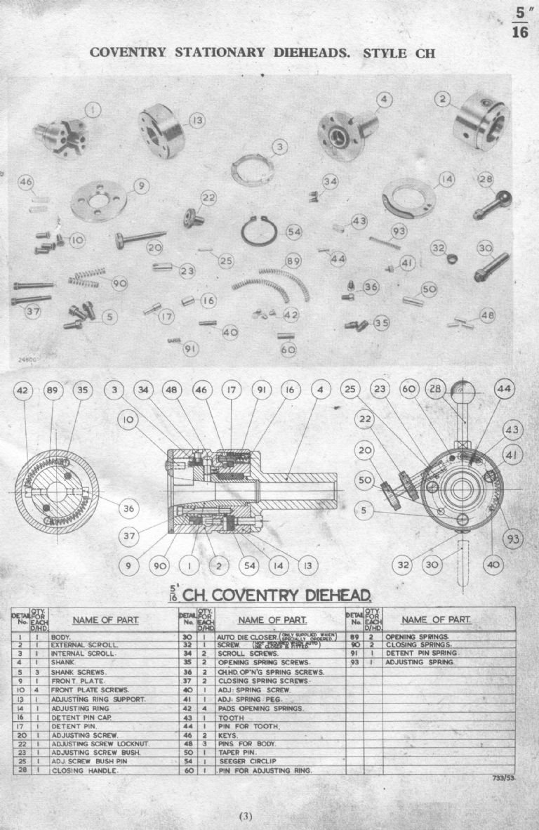

                                                  You can download the complete handbook on specs and maintenance for Coventry Die Heads if you visit ;
                                                  pounce atom.dreamhosters.com .
                                                  He PDF. Is almost at the bottom and it is a bit slow, but well worth it.
