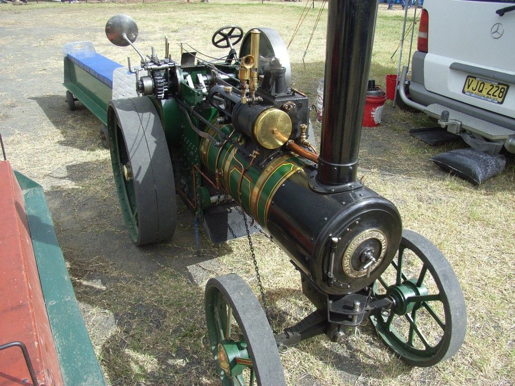

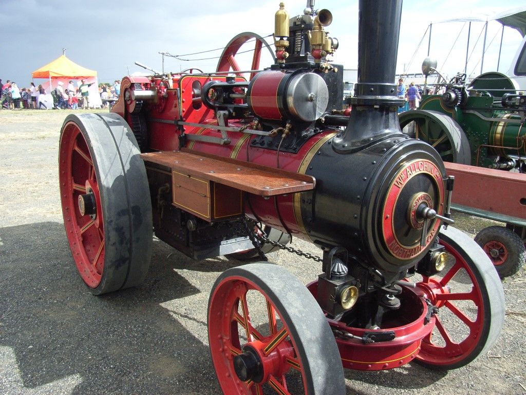

              Where should the drain cocks be mounted ?
              Edited By Brian John on 20/04/2016 02:49:44
              #235354
              Paul Lousick
                @paullousick59116
                The drain cocks should be mounted on each end of the steam chest to discharge any water that may be in the cylinder.
                Water does not compress like steam and if the piston cannot reach full stroke will blow the end off the steam chest or bend a piston rod or crank shaft.

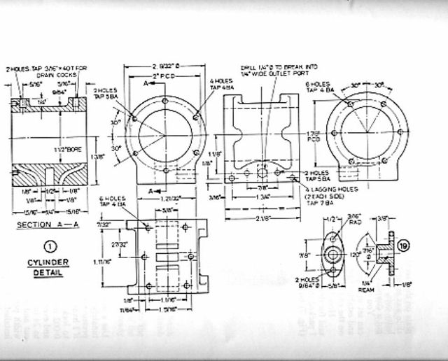

                  This drawing of a Stuart Turner S9 cylinder shows where the drain cocks go, this is a mill type engine, but they go in the same place on a vertical engine.  There are actually two positions for the cocks, either directly opposite the steam chest, or at 90* to that, which would place them under the cylinder on the horizontal S9.
