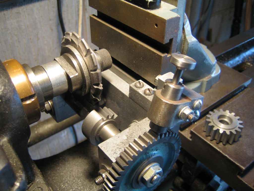

            geoff walker 1
              @geoffwalker1
              Garry,
              What equipment do you have? If you have a horizontal milling machine and a dividing head you are well on your way to making gears.
              If you just have a lathe you can improvise but you will have much to do before you can cut gears.
              The photo you see below is my gear gear cutting arrangement for a 13t tumbler gear.
              It comprises a home made dividing attachment and vertical slide which uses gears to index. the example shown is 52t boxford gear which of course would be indexed every 4 tooth forimg_3182.jpg a 13t gear.
              The arbour holding the gear cutter has morse taper and uses a long draw bar to secure it in place. Don't trust a morse taper without a draw bar when gear cutting.
              Hope this helps, more details on request Geoff

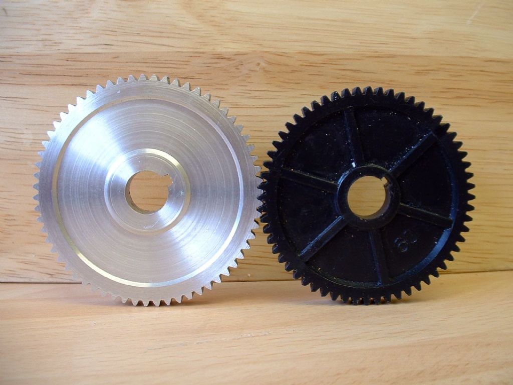

                          #352829
                            A few pence worth of gauge plate (before sharpening).
                            A blank MT arbor
                            And perfectly successful gear
                            For a commercial cutter, I would suggest turning your own arbor on an MT blank.
