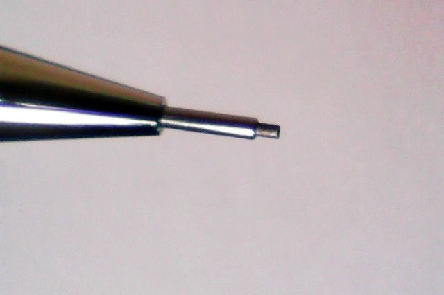

                              Here's a quick & dirty demonstration of a cheap 640×480 UVC WebCam, David
                              Lens unscrewed sufficiently to give approximately 30mm working distance
                              Note: I had already removed the 'beauty ring' from the front.
                              The subject is the ubiquitous 0.5mm Pentel clutch pencil, which should give you a good sense of scale.
                              Better cameras are available … but these are probably adequate for the purpose.

                                That's very good Michael. Just to clarify, are you suggesting to use the camera as a centre finder or as an alternative to a loupe?
                                David
                                #533272
                                  Posted by David Noble on 11/03/2021 17:16:49:
                                  David
                                  Well … as it stands [which was cobbled together with a few lumps of BluTack] I suppose it's just an alternative to a loupe.
                                  But if virtual cross-hairs were added, and the camera firmly mounted, it could easily serve as a centre finder.
                                  I was just offering proof-of-concept, lest the naysayers jump in. angel

                                    Come on Michael, how do you add the cross hairs? I've had this on the back burner as a way of making a travelling microscope. Cross hairs and concentric circles would be good
                                    #533288
                                      Posted by duncan webster on 11/03/2021 18:25:46:
                                      As a Mac user with an interest in microscopy, I have several applications that allow the use of overlays.
                                      … I presume that similar things are available for other Operating Systems.
                                      You might want to look at ToupView/ToupLite : **LINK**
                                      http://www.touptek.com/download/showdownload.php?lang=en&id=28
                                      Despite being intended for the ToupCams, it appears to work nicely with a UVC camera as input.
