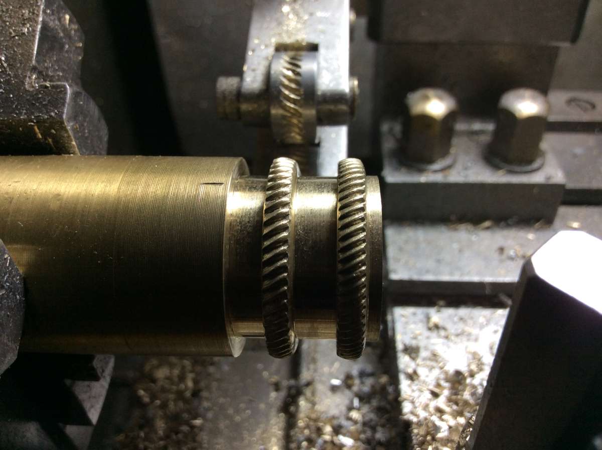

              If you are going to use standard knurls for a cut knurled project they will need their leading edge grinding until you have the full profile visible as this is the cutting edge. A rope knurling project is quite satisfying and they look quite classy when doneIMG_3781

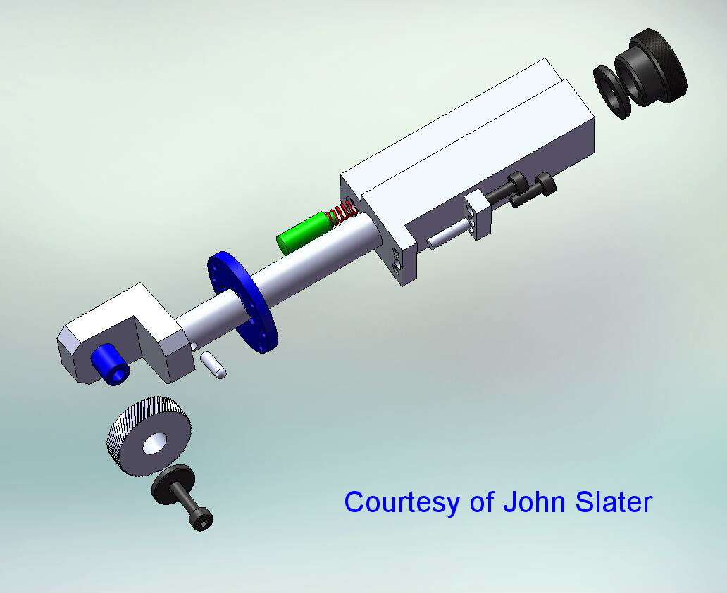

                  There was an article in the June issue of ME&W about making a knurling tool for conventional and cut knurling.
                  Andy.

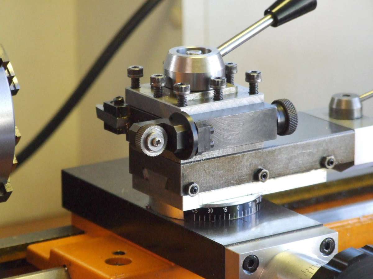

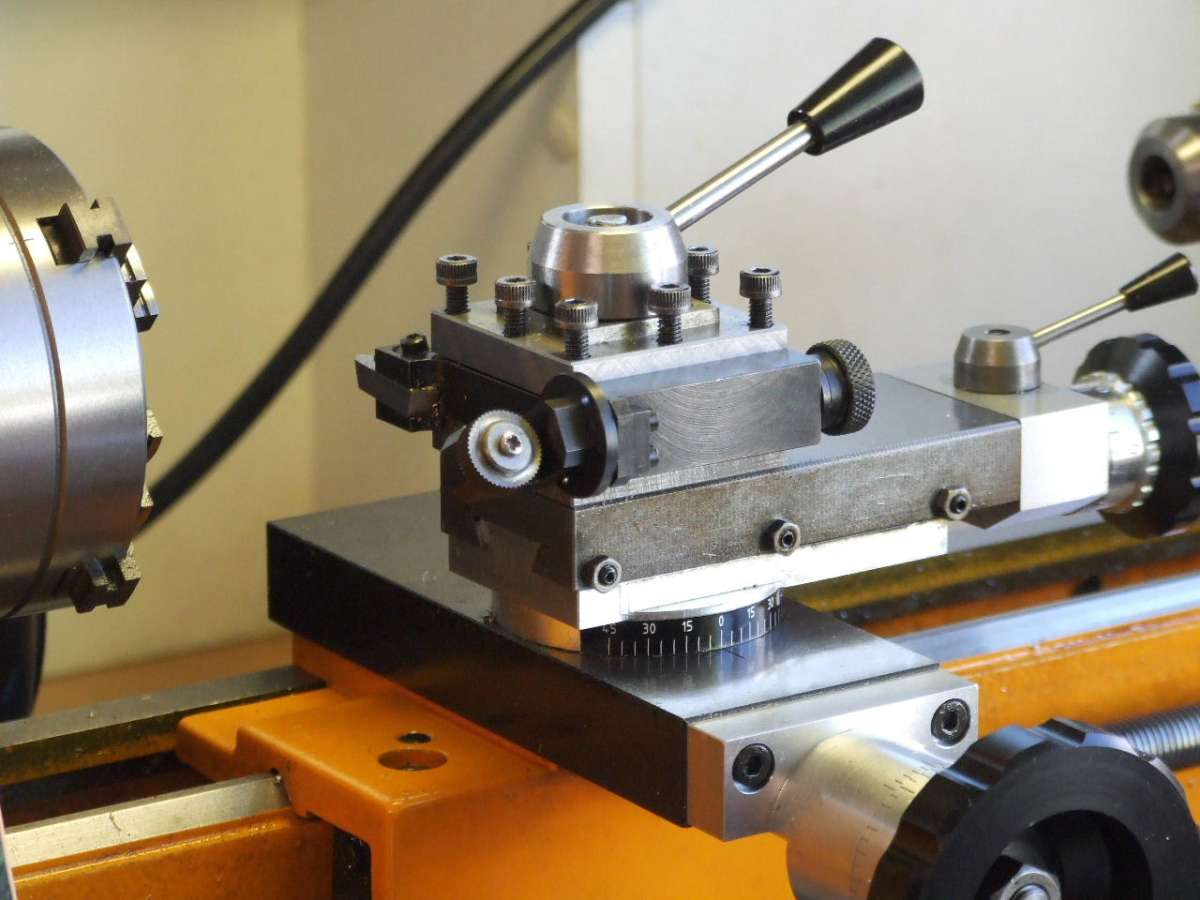

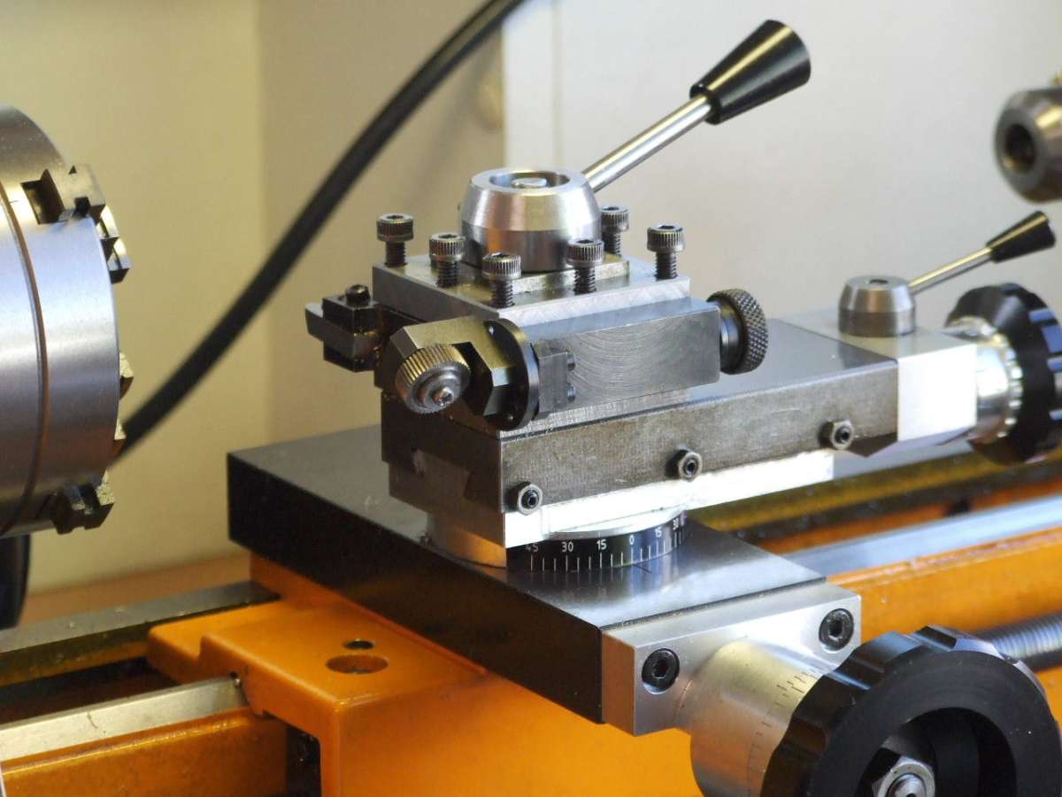

                    Graham Meek
                      @grahammeek88282
                      Trying to do conventional knurling on an Emco Compact 5 was never going to end well. Talking it over with John Slater I later received a link to an article by Jacques Maurel, entitled “Shiny knurls”.
                      c5 cut knurl 3D
                      Since making this knurling tool I have never looked back.
                      There are two positions for diamond knurling, obviously the tool is shown in a more convenient position for the photo shoot. The index plate gives the normal 30 degree diamond pattern and the less common 45 degree pattern.
                      Diamond Position 2Diamond Position 1
                      While the recommended path for straight knurling with this tool is by using a Helical instead of the Straight knurl used for Diamond knurling. I have found the Straight knurl used for Diamond knurling will also cut a straight knurl if it is used in the vertical.
                      Preferred Straight knurl Position
                      Initially the tool needs a little patience when setting up, but I have found it stays set for good. Even when changing the pitch of the knurls. It cuts Delrin just as well and examples can be seen on the digital readouts added to my Proxxon Mill modifications.
                      Regards

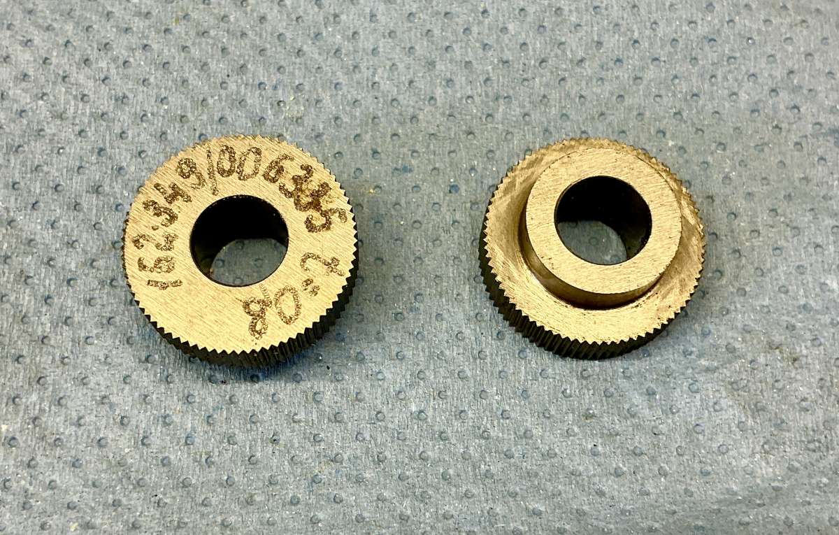

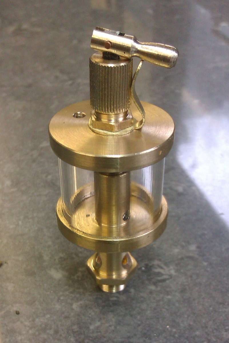

                          I don’t use diamond knurling very often but I’m normally happy with the results. I prefer straight knurling though and would like a better result. Seeing this thread is prompting me to consider making a cut knurling tool. Anyone know a source for the wheels at a reasonable price?
                          I bought these many years ago that might do to experiment with, but they’re quite fine.
                          IMG_5005

                            @Gray: Very nice work. Have you ever felt that the indexing plate was too limited? I was thinking of a fully adjustable one with a graduated scale, but yours looks a lot simpler both to make and in use.
                            #809976
                            Graham Meek
                              @grahammeek88282
                              Hi Fulmen,
                              I had never considered the use of a degree scale. Given the index plate is only 22 mm diameter by 2 mm wide. There would be little chance to have a useful scale around the O/D. At this diameter a scale graduated every 5 degrees would give less than 1 mm between each graduation.
                              The index plate gives a positive lock to the device with no chance of the head rotating and this makes it very quick to use. Plus there is an adjustment in the location pin, (up & down), in order to get the knurl cutting correctly.
                              Regards
                              Gray,

                                      Given the position of the indexing wheel it would not get in the way if you made it a lot larger diameter, could even be a ring that can be removed or stick it at the other end where it won’t be near the cutting action. If worried about teh tool rotating add some form of clamping to the main housing that grips the spindle rather than rely on the knurled knob to hold it if there were no pin.
                                      For straight cut knurls I have just indexed the work and dragged a V shaped tool along the length of the work, Could be done with an ELS too.
                                      IMAG2055

                                        As I said earlier I did not give the requirement to have a degree scale a second thought. The design is Jacques and I have merely adapted it so suit the C5. By using the wheels which were in my cache.
                                        I for one cannot see the necessity for additional angles in between. Especially if you are using a standard Helical wheel to do the straight knurling. Trying to use this type of knurl at an odd angle would probably lead to interference and a ruined knurl. A straight wheel would probably be OK, but it seems an awful lot of trouble to go to me. Maybe I am missing something?

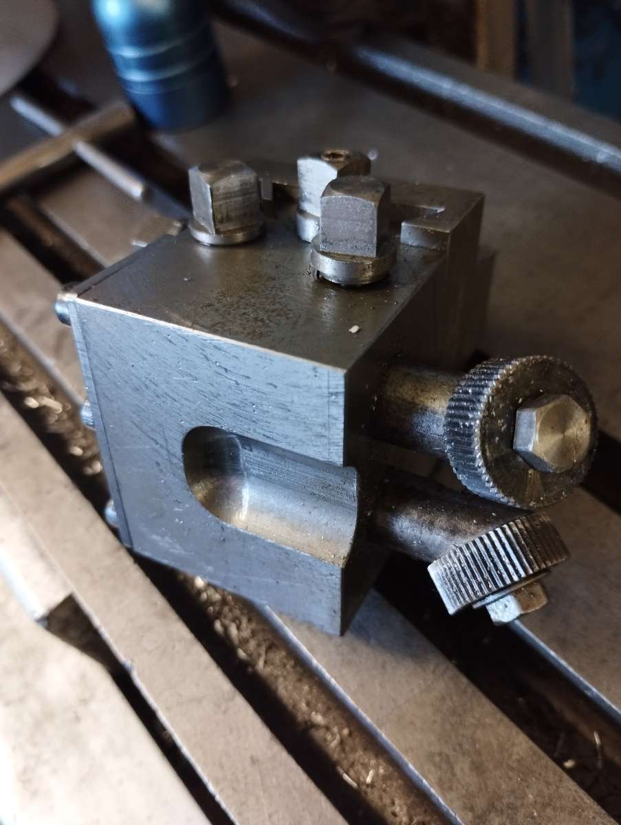

                                              I made this cut knurling tool many years ago when I only had a relatively flimsy lathe.  Haven’t used it for sometime, decent industrial machinery is more than capable of cold forming knurls.
                                              1754134702734
                                              What was meant to be a quick job turned out to be a lengthy one ultimately worth the effort.
                                              The three square headed bolts  are for rotating the knurling wheel supports, (in opposite directions),  to raise and lower the head when mounted in the tool post and lock the knurl shafts.
                                              When I first tried to use it I the results were disappointing, for diamond knurling, it would always bias the cut one way.  A bit of practice with it showed that the adjustments were critical.  All was well when I got my head around that!.
                                              When deciding on the knurl to use, straight vs diamond, I use diamond for things that need to be picked up and held, centre punch or scriber for instance.   For axially assisted, a thumbscrew running along a screw thread, straight knurl.
