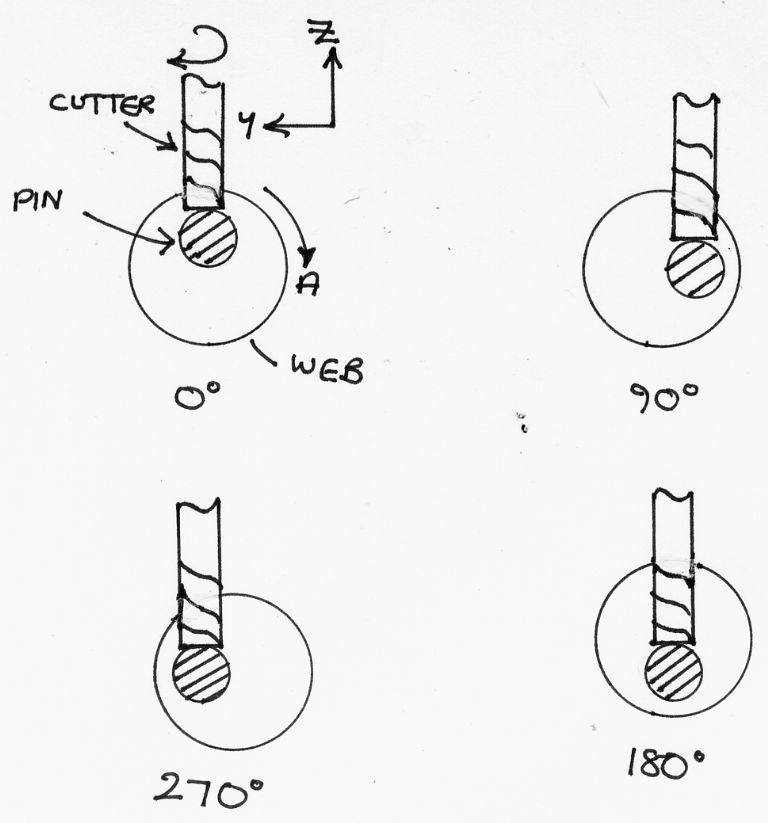

                                Wow, the CNC crankshaft looks great. I think I’ve understood the toolpath; is it like this sketch, looking along the axis of the crankshaft:
                                I have two technical questions for John. One, is the repeated G-code a series of G01 moves in Y, Z & A, or is it possible to use G02/G03 in Y & Z with a rotation in A as well? Second, if we assume that the centre cutting endmill is actually ground slightly concave on the end will this result in a barrel shaped pin?

                                  Andrew,
                                  Yes you have it .
                                  There is no G Code as such although it does make the moves you say. We looked at using the G19 plane, ie working in Y and Z  instead of X and Y but it got very complicated quickly.
                                  This is part of the code and is all you see on screen, there is no scrolling of numbers as you are used to seeing but rather two subroutines working behind the scenes.

                                  In the later part of the ‘code’ it calls a sub routine P003, that works out where the tool is in relation to A and Z.
                                  That subroutine in turn calls another subroutine, P004 that works out where the tool is in relation to Y and Z.
                                  The whole code is about double what is posted above. At the moment I don’t want to release this as it’s all the work of small son and I need his permission.
                                  Good thing about this is it’s all powered by variables set out at the beginning so it will work for any crank throw. The figures in the variables are the ones relating to the crank we cut, 30mm OD, 10mm pin, etc.
                                  Good point about the concave cutter, never thought to measure the edges as opposed to the centre, Perhaps we need a small grinder carried by the Z axis so it can go round and do a final clean up ?
                                  John S.

                                    Thanks for the information. Don’t worry about posting the G-code, I’m not about to start CNC machining crankshafts. However, it is an interesting technique, which I shall store away for future reference. I tried a quick programming exercise for something similar in my CAM software. It failed miserably, so it looks like hand coding if I need to use the technique.
                                    I guess one could ameliorate the ‘barrel’ shape of the pin by doing some final passes with the cutter offset from the centre of the pin in Y, or alternatively stop every ‘n’ degrees in A and make a pass of the cutter in Y. Both would improve the shape of the pin but neither would make it a true cylinder. My gut feel is that offsetting the cutter in Y would give an acceptable shape with fewer moves.
