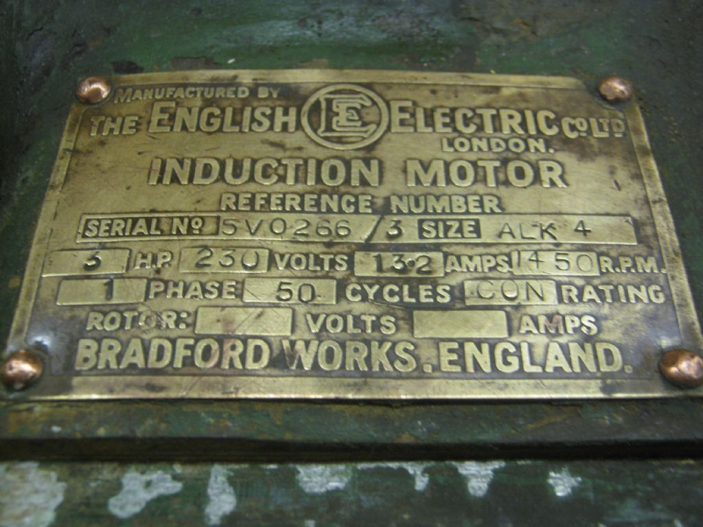

I've been working with single and three phase induction motors for very many years but finding this one with 5 power connections and a separate controller was a new one on me and also a couple of friends older than I.
I now have the motor and controller on the bench and had some time to investigate it thoroughly.

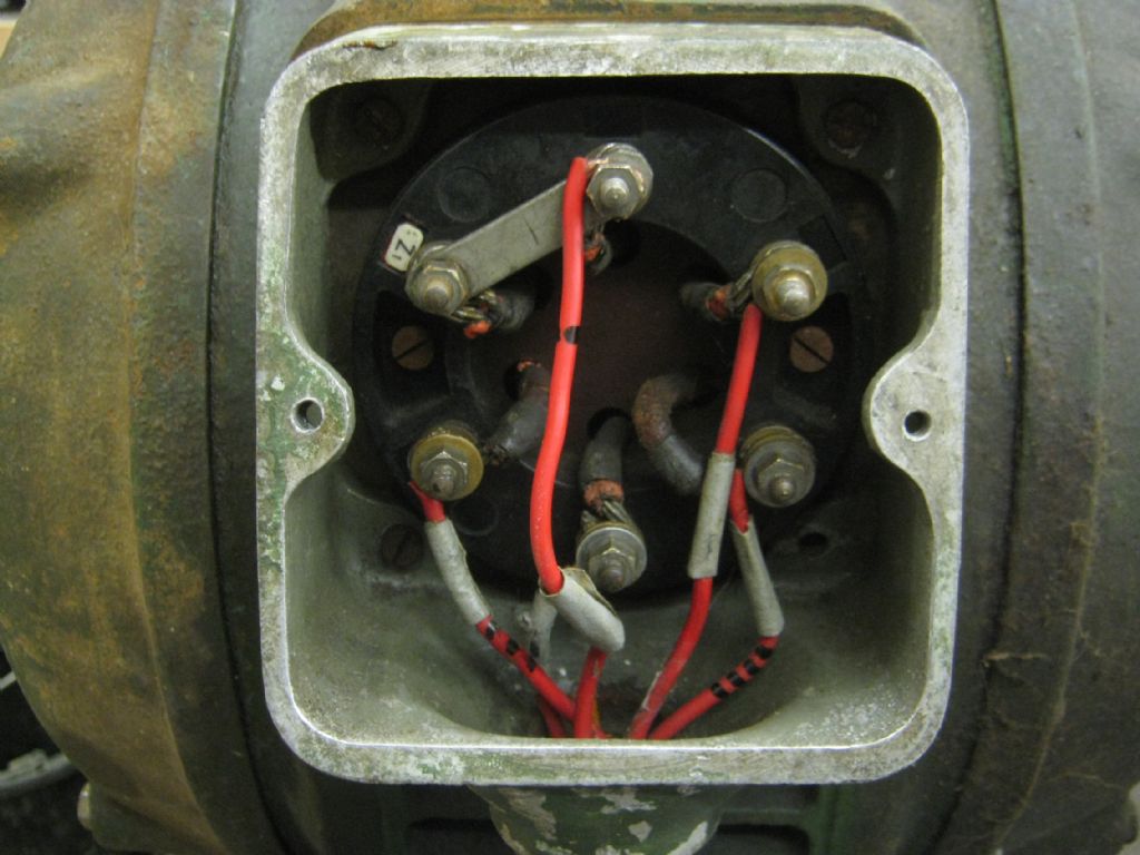

There are a total of 6 terminals each going to the ends of 3 three separate windings. One of these is the Start winding marked Z1 and Z2 and the other two winding are both used for Run A1-A2 and A3-A4. It has no internal capacitor or centrifugal switch.
If you come across one of these motors then it is vital that a standard direct on line (DOL) starter is NOT used.
The regime for starting these motors is to connect the run windings in series and momentarily connect the start winding with a series capacitor in parallel with the run windings. Once the motor is up to speed, the controller disconnects the start winding AND switches the run windings from series to parallel.
As far as I can tell, this series parallel switching is there to keep the starting current reasonable. Even so the peak start current on this motor (3HP) is 34 amps before settling down to just over 10 amps once running.
Full load current is specified as just over 13 amps.
