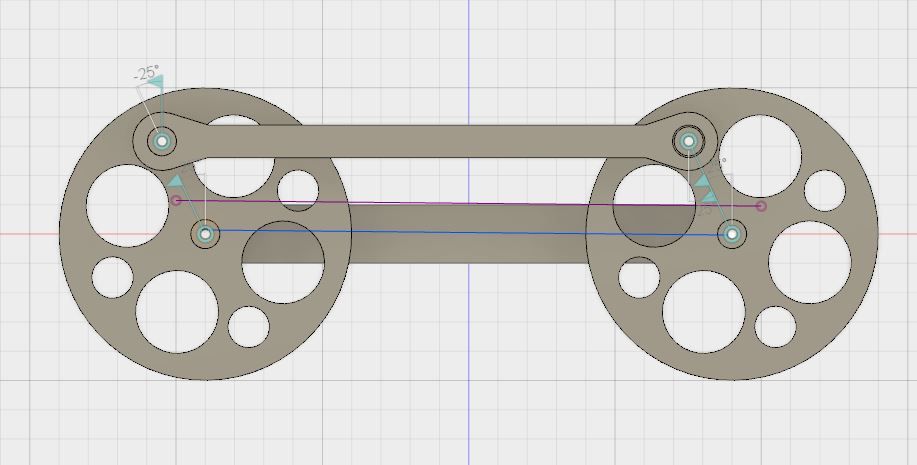

        I'm confused! I'm not sure if this problem is down to Fusion 360 or me not understanding the mechanics governing what happens when two wheels are coupled together. I think it's me.
        I made this model in Fusion 360. The two wheels rotate independenly on their axles except they are joined together by a crank. The model has four rotating joints, just like the real thing.
        What could possibly go wrong? Well, turning the model's left wheel anti-clockwise by hand, (or automatically by animating the joint), mostly causes the two wheels to turn together exactly as you would expect. But every so often, perhaps every 20 rotations or so, the crank displaces into this second position and causes the right hand wheel to reverse for half a turn. Then the crank re-aligns and the motion returns to normal, until the next time.
        If this happened to a real locomotive the driver would cack his pants and the designer's pencil would be ritually snapped !
        Can anyone explain what causes this phenomonon? Assuming it's not a software artifact, how should coupled wheel sets be designed to avoid it?
        Dimensions: all revolving joints are 10mm diameter. The axles are 180mm apart; the wheels are 100mm diameter, and the wheel cranks are 35mm from the axle centre.
        Thanks,

          Looks like a perfectly permissible action – what you're missing is the set of coupled wheels on t'other side of the loco chassis with the quartering across the axle.
          #281515
            If you don't want to draw the other side then you could align the crank to the frame then it will always stay horizontal

              It can happen in real life too, thats why there is a connecting rod on each side 90deg apart. As it is drawn at the position when all the pivots are in line there is nothing to prevent the connecting rod ends moving in the same or opposite direction. I am not sure what makes Fusion 360 choose one way or the other but in real life there is bound to be some clearance no matter how small and it depends whether the clearances line up or are in opposite directions. There that sounds as clear as mud now I have written it down!

                It's inherent in the mathematics of the design. When the connecting rod is aligned with the wheel centres the mechanism is unstable and can flip into either of two stable states, which it will do randomly.
                Said driver will not need to change his pants as on a real locomotive there is a second set of wheels and crank which are 90° out to the first thus eliminating the unstable state.

                  Thanks chaps! That makes sense.
                  All the time I've spent looking at steam engines without noticing that the cranks on the other side of a loco are out of phase. Now I wonder what other details have passed me by.
                    That's a really good idea. Do you happen to know if it's possible when the model is an assembly of parts? In this case the chassis and coupling rod come from different drawings.
                    I'm off to see if Autodesk have anything on their website.

                        I can answer my own question. It's done using Modify->Align, applied to link the coupling-rod to the chassis at the assembly level. I'm impressed with Fusion360.

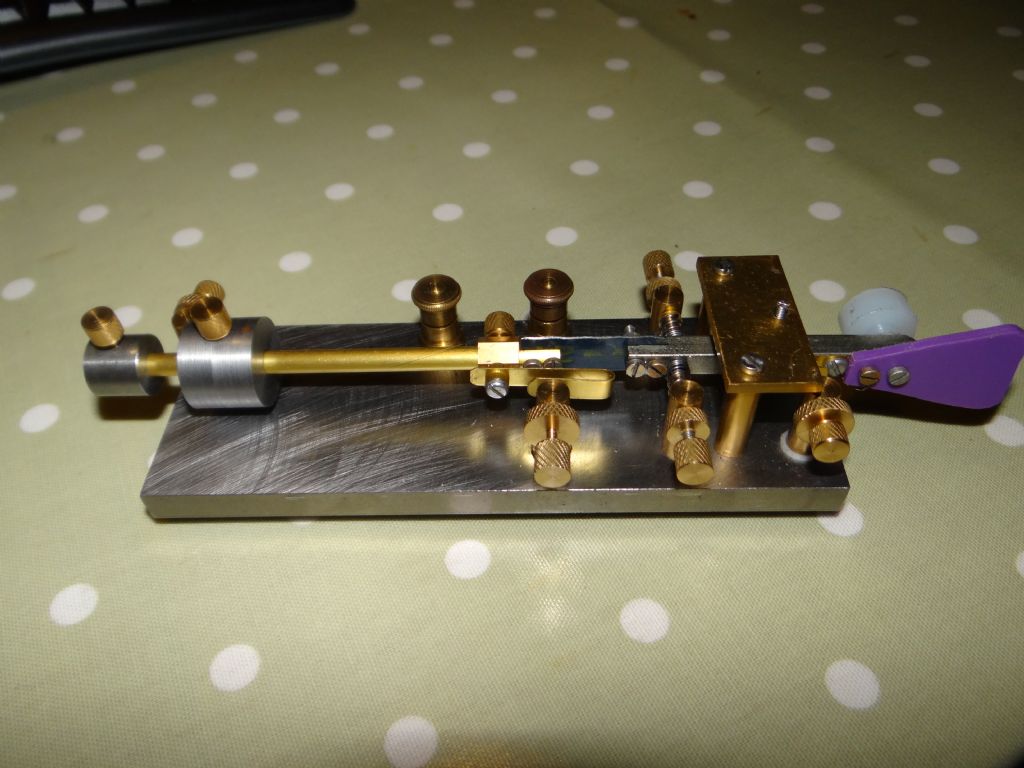

                                              Yes, that's right – a mass on the end of a blade spring. Here's a picture of a freelance key I built without benefit of science. The period depends on the mass, position on the rod, and the spring tension (I think!). In the picture There are two steel weights on the left, the smaller one was only added experimentally to reduce the dot rate.
                                              The mechanism is semi-automatic. Moving the purple paddle to the left closes a contact and allows a dash to be sent. The length of the dash is controlled by the operator. The left movement also tensions the blade spring so that moving the paddle hard right causes the weighted rod on it's blade spring to vibrate. The vibration causes a contact to be repeatedly made and a stream of dots is sent. Even though it's crudely made this key sends about 20 dots per dash which is more than sufficient to do the job.
                                              The mechanism and layout could be improved in several ways.
                                              Now I have Fusion 360 it's very tempting to have a go at a virtual redesign. Being able to model the vibrating spring and weight assembly would be icing on the cake.
                                              For example, I used a bit of hacksaw blade to make the spring. It worked OK, but the balance between tension and blade length is approximate and needed lots of experimentation. I'm sure it could be done much better with a proper spring and some sums. As I'm not too good with maths, it would be wonderful to do it in software by tweaking parameters from my armchair.
