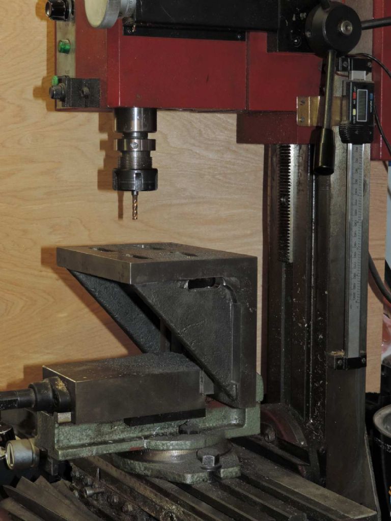

                It's an SPG 9512, a tilting column mill (like the original X2) so the 0.3mm in 100mm error is one of how it is set, not one of how its built.
                It appears the head has also got knocked out of true to the column.There is a cure for this that doesn't need a square. Remove the head completely, the front and back are held together by four bolts. Loosen these and using paper to shim up the front part of the head with both parts on a level, flat surface, it should be possible to align it accurately with the rear part and nip up the bolts. You can then reassemble and tram as normal.

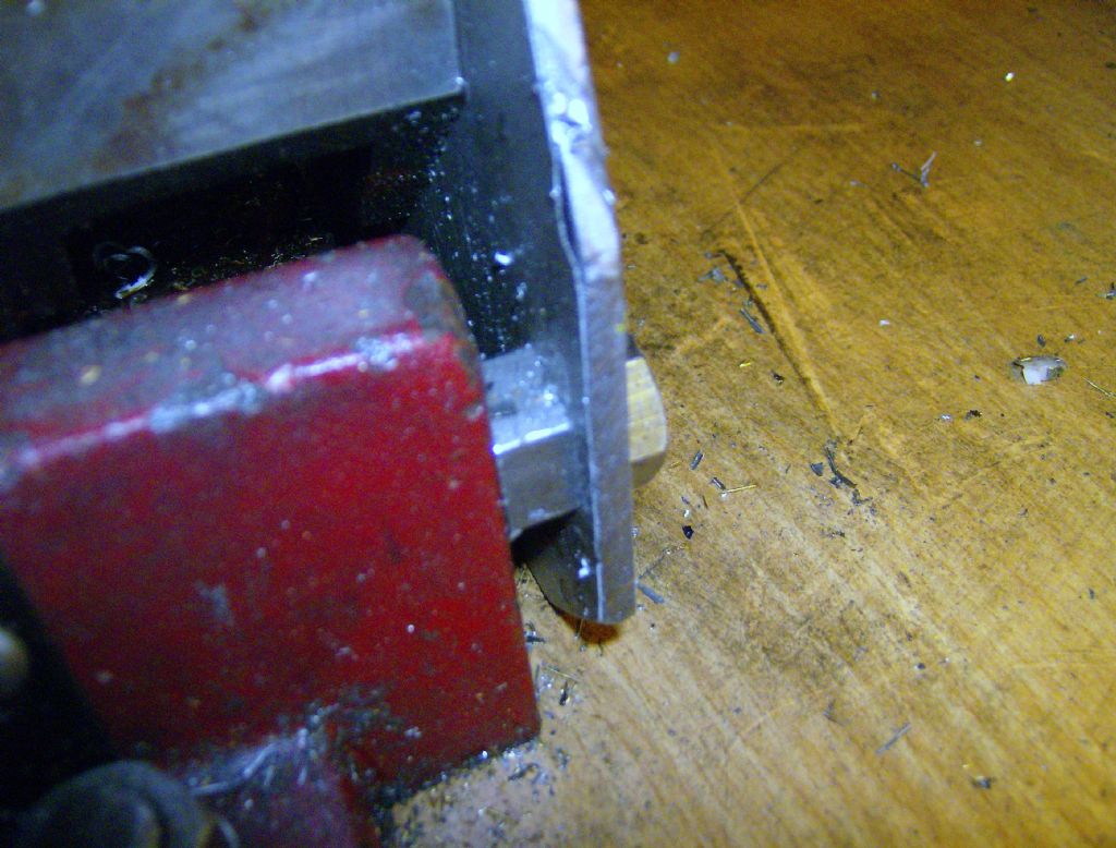

                                                Now possible to set the head perpendicular by tramming, but I think the problem faced is that the head.can only be adjusted off the mill.
                                                This is why I suggested the 'shim with paper' methodology. This must be more or less how they are set in the factory, however, they have the advantage of doing this before they are painted. When I discovered the head of my mill was out, it was evidenced by a crack in the paint where the two parts join.
                                                Obviously using paper, a flat surface and painted castings isn't ideal, but I can honestly say it worked OK for me.

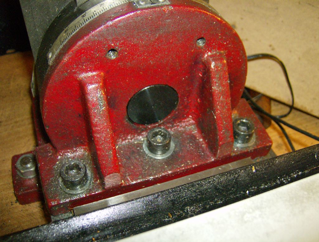

                                                I described the process for the old-style X2 in this article from MEW 201:
                                                http://www.arceurotrade.co.uk/reviews/MEW201_p52_58_X2_Mill.pdf
                                                Page 5 describes what I did and there's a photo on page 7.
                                                I strongly suggest trying this, followed by conventional tramming (as in Dave's photo) before investing in any additional equipment.

                                                    In Part 1 of my article in MEW 199 I described how I did the front-back tram by scraping. Despite my crappy scraping, the much increased contact area helped rigidity, but not as much as a bracing plate.
                                                    Problem is the fixing screws are nearly in a straight line:
                                                    Adding a bracing plate locks the column solid, front to back:
                                                    Allowing you to do stupid things which the original mill wouldn't have had a chance of doing:
